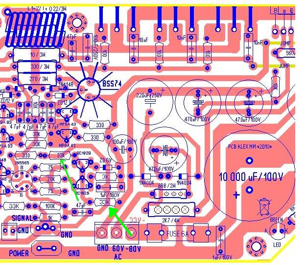

Can you send me the 6 files (Top silkscreen, Top resis, Top, Bott, Bott resis, Drill). Just want to see if I can read then (or should i say, the fab house). It would be aweful if I get all the orders and find that I cannot take you files to fab. Like I said, a previous sample will be good enough. Just want to see if I can recognize files generate by your pcb software, just in case.
perhaps a single board should be done first and verified to ensure it actually works as designed?
I second that. I think it would be nice if Nagys would do the "proto type test" before we all run out for buying PCB´s that haven´t been tested properly. He has made several types of this amp before and he has all the necessary stuff at hand - transformers, cabinets, the right components etc. In this way we would be able to find out very fast if everything is OK. Nagys might be interested in this solution as well (?)

I think it is pretty common these days to have components ID on the PCB rather than their values. It would be a lot easier to track errors. You can have 3, 4, 5 300ks in a circuit but you would not have 2 R12s. So I would say it is better to have IDs rather than their actual values on the silkscreen. And when we want to discuss whatever problem with a certain element, it would be a lot easier to address them.
It seems that I don't see many TO-92 package having a triangular arrangement for their leads. We have to spread the leads from its factory release stage to meet assembling convenience. The C and E are moving out but does it really matters if the B is moving to the front (the print surface) or to the the back (the semi circular surface)? It might seem a bit strange in appearance though. And godfrey, the tripod arrangement do have some significance. See pict from one of my recent PCBs. If you have the 3 pads in line for Q2, you can never have that trace from R2 sneaking thru BC of Q2 and go to Q1 which is all "surrounded". This is most common arrangements in pcb software libraries, isn't ?
Like I said, I am not rushing anyone to order, in fact I like to go carefully and don't want to make reckless mistakes.
Alex, can you introduce some voids along the power traces especially the output trace which look awefully slim. Would it be a good idea to use 2 of the pads on the left of the 4 pole connector as the "In" and 2 of the pads on the right for "Out" on the protection pcb. But of course, you would have to broaden and move some traces around. Hope that is not too much work. Since we are now going double side, do you think it would be too much work to thermally couple the BC546 and BC182 pairs ?

Another thing to consider here , do you really want 120v AC to be on this amp's main board ??? Would not a separate voltage doubler/cap multiplier board be wiser and allow for DC only to reach the board ? One could construct this on the same board as the PCB mounted trafo. Just a thought , not a mod. :rolleyes:
I guess , there are those who would "build first and design later"
OS

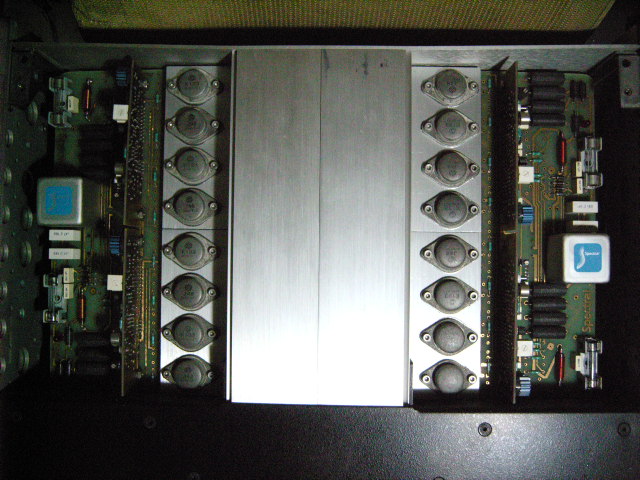

Nice reading : Spectral Audio DMA-180 High-Current Reference Amplifier
200W/ch, with the DIP8 version of the 2N556* dual JFET type at the input + Hitachi TO3's.
As do the DMA80, DMA90, DMA100 from 1982 and the DMA50 from 1984 ,Mr Demian Martin is a DMA designer and member of this club.

I wish we could get out hands on that Spectral schematic. It sounds sweet. One high dollar amplifier. Somewhat similar topology as the Goldmund. It even shows the input jfet sealed canister thing.
As old as some of the Goldmund components are there should be a generic or outsourced provider where they can be found for a more resonable sum of money. I mean Fairchild makes copies of IR mosfets which have better characteristics. I am looking anyone else. Spec's are spec's.
