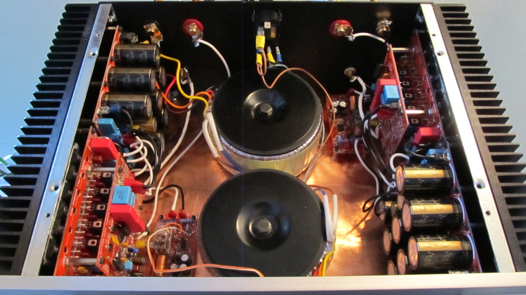

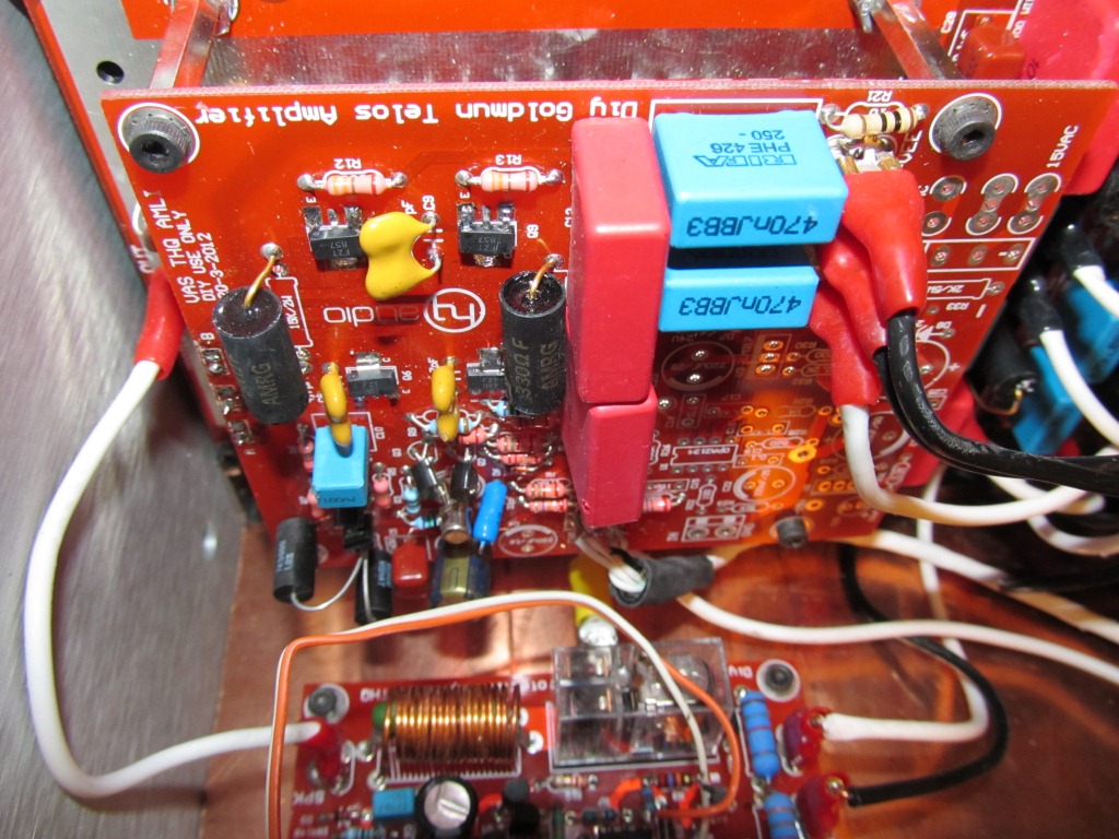

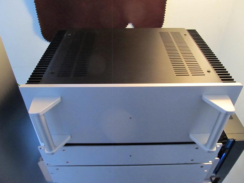

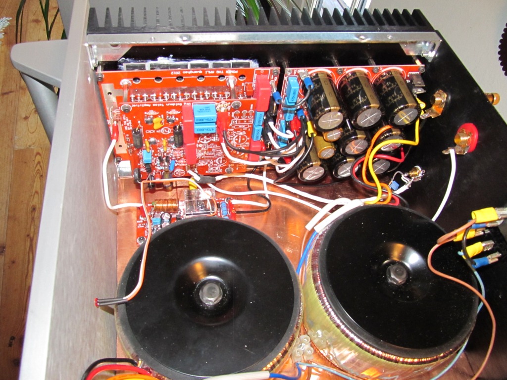

Non of the suggested PCB´s are the I have used in my GM telos clone.
See the pictures.
nice, but the transformer it is need biger!
How about the sound??
Hello Quanghao and thank you for the wonderfull pcb´s.
Too small? You really think so? They are 600VA each...
Well anyway my loudspeakers are VERY efficient and presents an easy load with no seriuos dips in impedance.
Very good indeed. As you can see in my previous post here, it has bettered all of the amps I have made prior to it. The only amp that can challenge it is the 25 Watt 6C33 otl, but it needs a remake with better components and better chraftmanship and a little improvement here and there to match the Telos or surpass it. IMHO.

Nice work Koldby. It looks like lots of carbon film resistors has been used.
Thanks Tommy,
Yes and in the critical positions Vishay Bulk (feedback)and AMC as power resistors.
