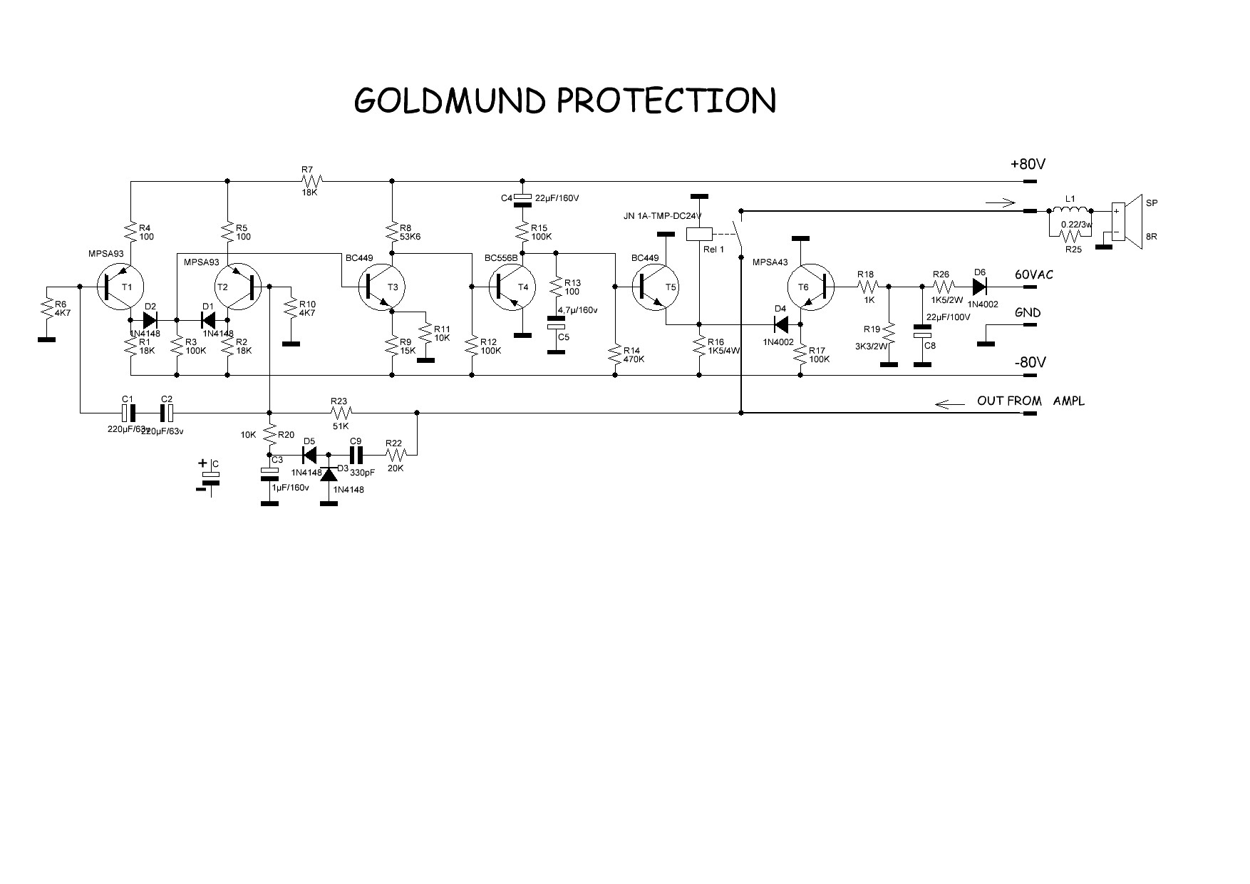

I'd trace the schematic and board layout you've posted including the protection circuit Nagys sent you it's truly the Mimeses 3, it is also same schematic and layout posted by Nagys in its new thread after lift here, it seems correct if base on hand drawn and updated protection schematic, the only problem is the orientation of electrolytic capacitors in protection circuit seems confusing, but i'll try to figure this out.
I Nagys sent this board and schematic we can assume that it might work without modifying the board, you might be the first to make this Mimeses 3 if that happen.

Not sure which Goldmun Clone tread is still active so I'll post here and see. I've was reluctant to try to build one of these because of all the "discussions" over the past 3 years on the "right" schematic or PCB etc etc. I did want to compare it to other DIY amps like a TO3 SymaSym and FC100. Its been a long winter so I gave in and made a V3.9 PCB. After populating the amp side only with as many original parts as I could find, the first power up was tentative: the amp seemed to work okay at 50V rails but gave an oscillating DC offset when connected to output - adjustment was fine with no input or output. Tried all kinds of things to cure this but nothing as worked so far. The sound from amplifier into a cheap test speaker seems okay!!!
Of course, on populating the protection circuit side, all I get when connecting the speaker is the relay cycling on and off. It goes on okay without the output connected. I am stumped, any ideas as to the source of the problem???

hello. email from member Vitali and this amp is up and running.
Hi Stig,
This amp is worth the effort.
It is the best sound that I heard him!
Transistors,resistors - Exactly like in the schematics!
R20 - 330R (biass 100mA)
T5-T6 -Contact thermal!
T7-T8-T9-T10 - Thermal contact all four together!( I did exactly as proposed by Nikos on diyaudio)
Otherwise offset will not be stable!
