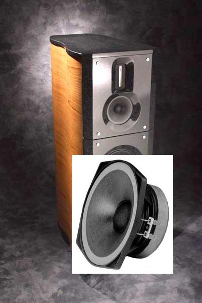

Good pictures of Rushmore are now on the website, and also the spec sheet (pdf) . The spec sheet is a good read, and has lots of information on the speakers, along with the philosophy behind them.
They definately look like PHL audio drivers along with the Raven.
from the spec sheet (pdf):
"The result is a four-way system, with a 15 inch
deep bass driver, a 10 inch mid bass driver, and
6 inch midrange, and a ribbon tweeter. The bass
driver is 97 dB/watt efficient, and the remaining
drivers are at least 98 dB/watt. The cone drivers
are all high quality professional drivers rated at
high wattage levels which by coincidence work
very well together. As a group, they were the
best we could find."

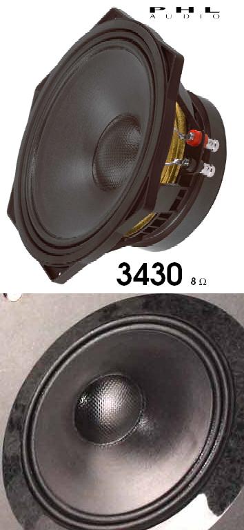

Looking at the PHL website, the drivers look like these:
Ribbon tweeter: Raven 2
6.5" midrange: 1140/1080 or 1160
10" midwoofer: 3840 or 3430
15" woofer: 6030 or 5010
They look great and definately a great direction for speakers to be going, towards greater efficency and response.

russbryant said:Also it says "professional" drivers, I take it that means pro sound drivers. Did you guys have them made to spec or are they off the shelf? PSL?
They look just like PHL drivers. Look at the pdfs on the phl audio website. Here is a comparison from the pdf from PHL and the pictures from passlabs.com
Brian
