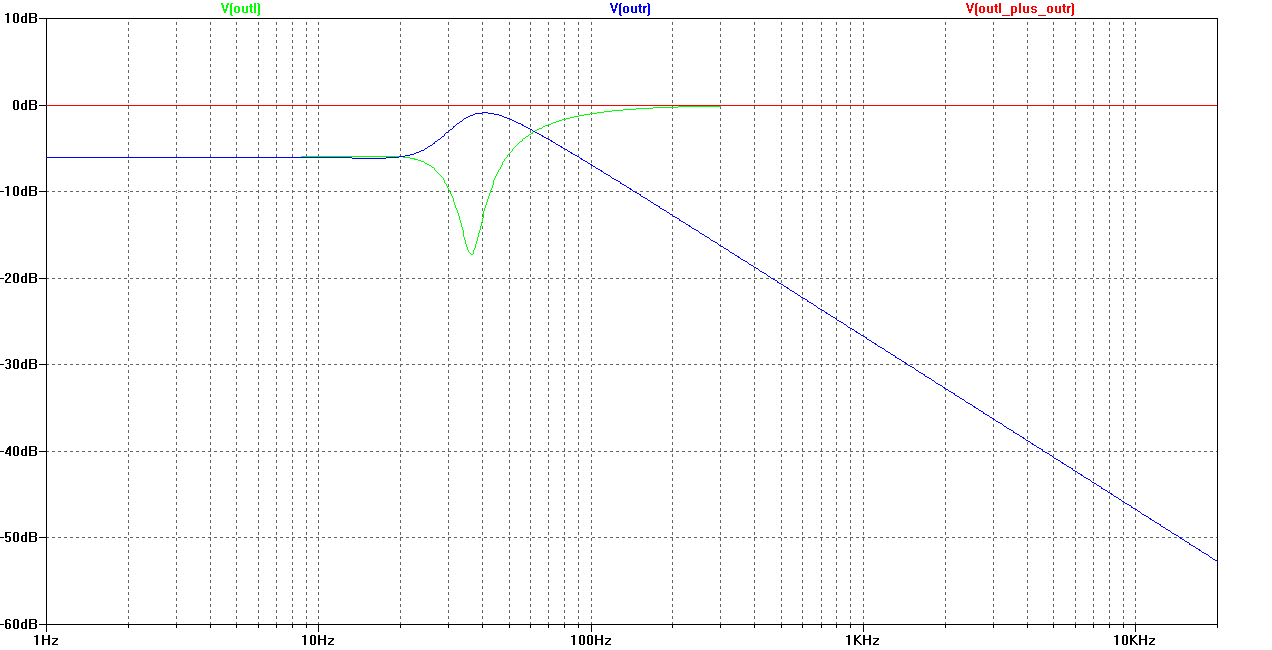

The ultimate rumble filter - far more effective than just a high pass filter!
Darn. Missed the graphs

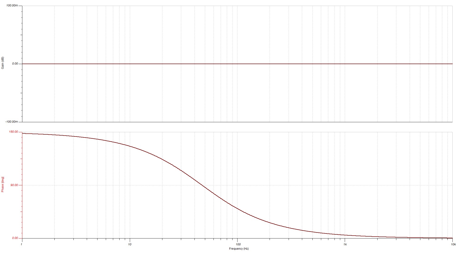

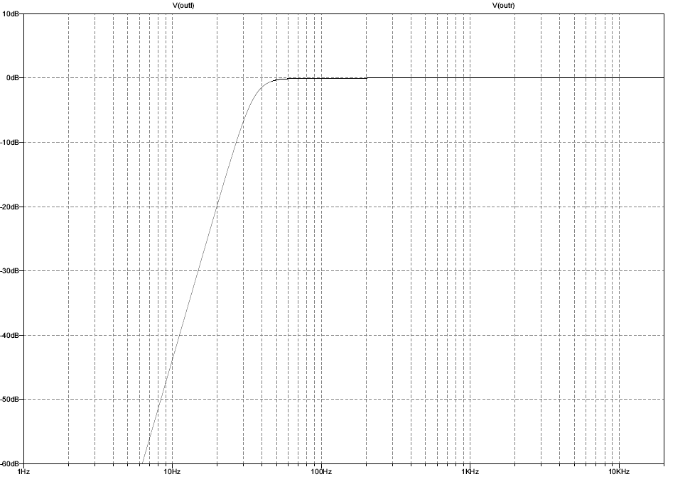

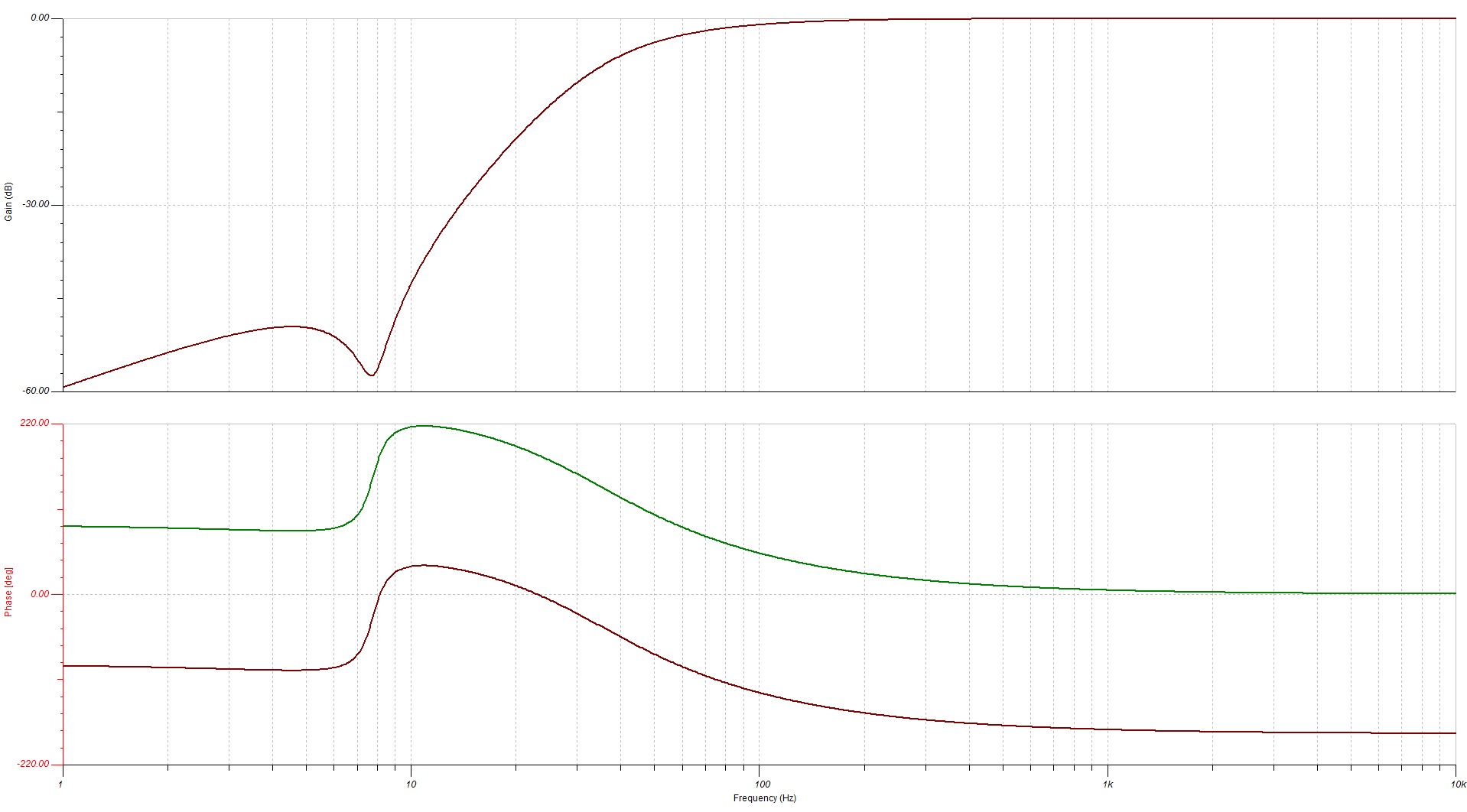

For completeness, here are the graphs for my figure 4. I didn't bother plotting the response for left and right in phase with equal magnitude, as it is the same old almost 0 dB and 0 degrees graph.
The response for left and right in antiphase is a nice fourth-order Butterworth high-pass.
Unfortunately, the response of figure 4 with one channel driven and the other silent looks absolutely horrible. There is a big notch, a bump in the transfer to the other channel and the channel separation only reaches 30 dB around 1.5 kHz.

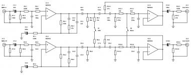

Phono Derumbler
The Linkwitz-Riley Phono Derumbler is shown in the attached circuit diagram. There are basically 8 blocks: left and right channel buffers (the LR filters have low input impedances that can interact unless buffered), a summing amplifier (labeled LEFT + RIGHT MIXER), two high pass filters (one for the left channel and one for the right), a low pass filter for "mono" center channel, and a pair of summing amps to mix the left and right high pass filtered signal with the center low pass filtered signal.
What is seen is that there is no hump or notch in either of the reconstituted left and right channels. This is a a feature of the 4th order LR filters that have been used in professional active filter crossovers for years (see RANE, for example).
An excellent resource can be found at Rod Elliott's website (Elliott Sound Products). Rod has a calculator for the filter component values.
The LR filters are actually cascaded 2nd order filters (in this case Butterworth). Douglas Self calls them MCP (for Multiple Critical Poles) filters. Claude Lindquist referred to them as "sync-tuned" filters. They do have an advantage of a simple 4th order Butterworth in that the "Q" for both stages is 0.7071 - they are both critically damped which reduces the sensitivity to component tolerances. BUT, the main reason for using the LR filters is that the phases of the LPF and HPF at the crossover point have both been shifted 360 degrees, in other words, no weird humps, dips, or notches.
I've been using eSketch as my Spice circuit design tool for years. Unfortunately, the Canadian gentleman who developed it may have retired because it is no longer actively supported. But, you can still find it on the web.
Hopefully, the schematic will be clear enough for you enthusiasts out there to enter it into your favorite simulators to see if it actually works the way I think it does.

Normalized responses, if I calculated them correctly:
L = R: second-order all-pass response with Q = 1/2 sqrt(2)
L = -R: fourth-order Linkwitz-Riley high-pass
Left channel driven, right silent:
Left to left:
(s^4 + 1/2)/(s^2 + sqrt(2) s + 1)^2, magnitude (omega^4 + 1/2)/(omega^4 + 1), which increases monotonically from 1/2 to 1
Left to right:
Fourth-order Linkwitz-Riley low-pass with gain of 1/2 at DC.
You are right: no bumps or troughs, channel separation that increases at a fourth-order asymptotic rate above the cut-off frequency, rumble suppression that increases at a fourth-order asymptotic rate below the cut-off frequency, the only disadvantage is the all-pass response for L = R.

Attached are a couple of frequency response curves for the Derumbler first with the RIGHT CHANNEL GROUNDED and secondly with the RIGHT CHANNEL INVERTED.
Look at the RIGHT CHANNEL GROUNDED plot. Below 150Hz, the output from the LEFT CHANNEL is 6dB down because the right channel is a zero. Above 150Hz the LEFT output rises to 0dB.
Now look at the RIGHT CHANNEL INVERTED. Below 100Hz, both outputs fall at 80dB/decade. Above 300Hz, the response is flat. This is because the Linkwitz-Riley filters can't give the sharp corner that you'd get from a 4th order Butterworth.
I didn't bother with the situation in which both LEFT and RIGHT channels are working correctly because it is a flat line at 0dB with no bumps, dips, or notches.

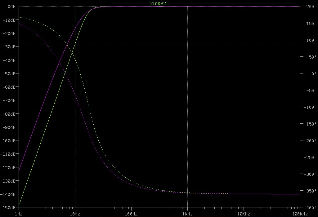

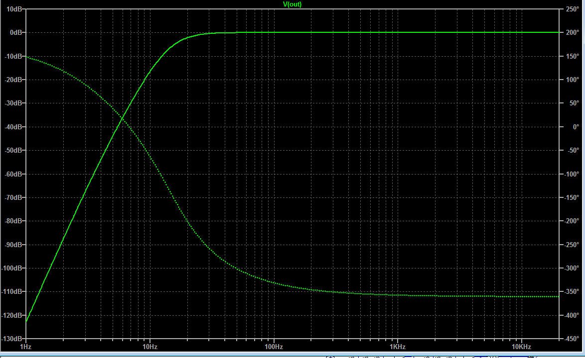

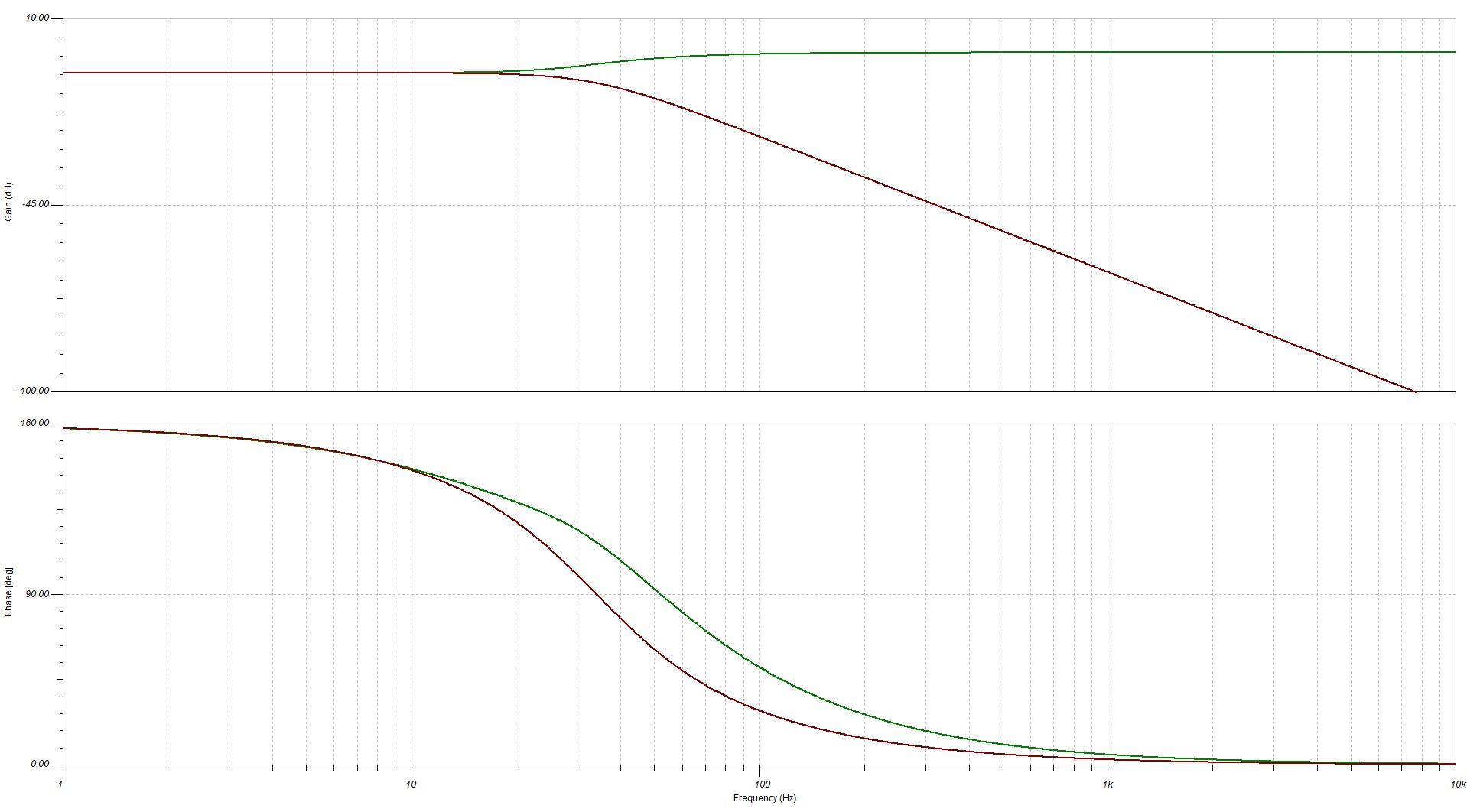

Thank you so much wiseoldtech for point out this rumble filter, I make a simulation and look so far one of the best in response......all the best
Hi Wiseoldtech and Kissabout2002,
Rod Elliott's website (ESP) is full of proven circuits (and he has PCBs!). You might also like to look at Douglas Self's book "Electronics for Vinyl" that also has just about everything you need to know about phono preamps. The section of rumble filters is very comprehensive.
For the past 2 years I've used an 8th order Butterworth high pass filter whose caps are all 100nF. The resistors are all parallel pairs of E24 resistors that come out closer that 0.1% E96 resistors (Doug Self pointed this out in his book). The corner frequency is 18Hz and the response is down 40dB at 10 Hz. I notice from the graph that the attenuation is only about 20dB at 10 Hz, Apparently, the worst part of cartridge/ arm resonance occurs in the 10-12 Hz region so I tried a compromise that loses as little of the 20Hz plus but attenuates as much as possible in the 10-12Hz region. Doug Self provides a very thorough analysis of filter orders and types (even elliptic filters).
As they say in the Old Country, "The proof of the pudding is in the eating". If you find a circuit that works for you and it doesn't create objectionable "funnies" then go for it. Some people go nuts over the lowest noise - I don't ever listen to music with my ear pressed up against the speaker - it ruins the soundstage! I prefer the most accurate RIAA response in my phono preamps.

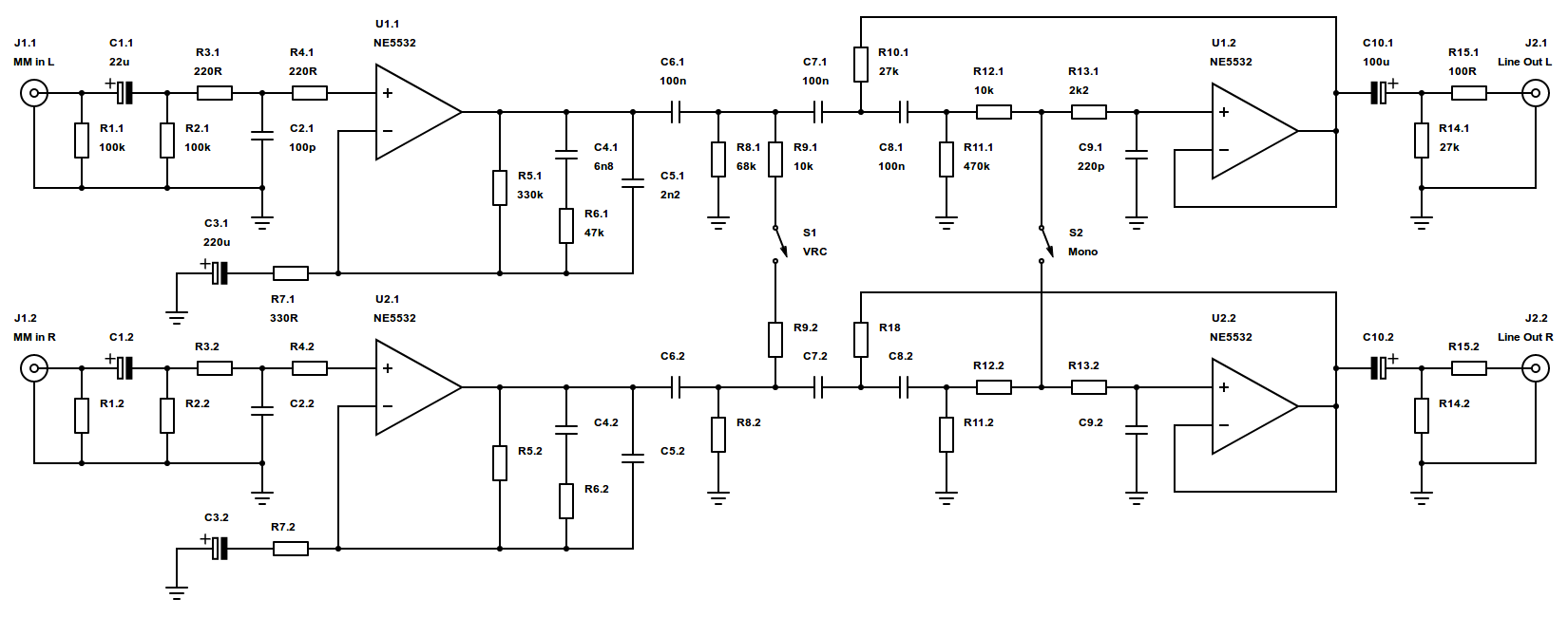

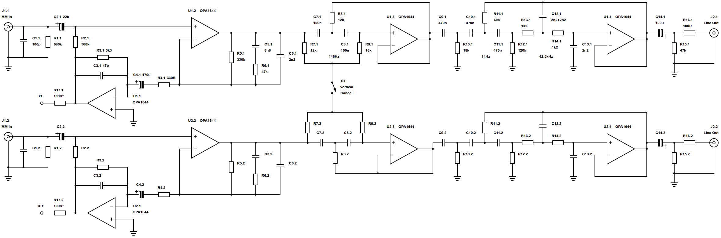

Here are a couple of more recent implementations of full phonostages that incorporate vertical filters that I have realised.
The first circuit is a simplified version that uses a single stage filter with a first order, switchable differential vertical rumble filter built into a third order subsonic filter at 18Hz.
The second circuit is a bit more complicated and uses an ultra low noise RIAA stage that mitigates the effect of noise from the loading resistor as the cartridge impedance increases with frequency. The vertical filter is implemented through a second order differential Bessel filter set to 140Hz. The usual 3rd order subsonic filter follows.
Gain for both stages is a healthy 40dB :hot: ! With low frequency noise diminished with can realise another 6dB more headroom in the preamp than we might otherwise be able to.
Subsonic rumble is especially harmful to bass reflex setups where the driver becomes progressively more unloaded as frequency drops below the tuning frequency. You can imagine a loudspeakers 'headroom', similar to a power amplifiers voltage rail limit, as the linear excursion. The loudspeaker quickly runs out of this 'headroom' or excursion as frequency decreases and inaudible rumble can cause significant fluttery distortion and potentially up to 20dB of lost effective headroom. I am currently working on a rather interesting 6th order bass reflex alignment that uses an electronic second order filter with a Q factor of 2 tuned half an octave below the usual optimal cutoff to lower the tuning frequency and remove any low frequency that could result in excessive excursion.
Although the circuit at the beginning of the article does work, the differential filter topology is far more efficient.

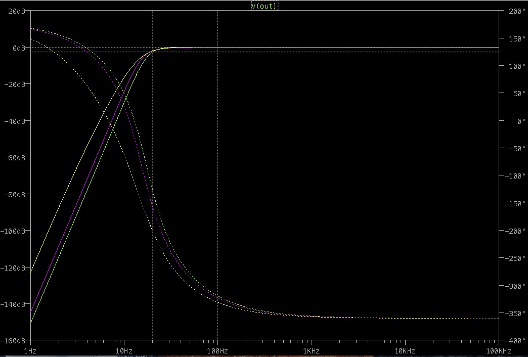

With Rod Elliots topology, faster rolloff is possible using alternate part values, at the expense of 50% more group delay at 20Hz (37mS vs 23mS).
Adjusted to be the same 2dB down @ 20Hz as Elliots. Much better in the 8-12dB range. This graph optimized with 85nF caps, a non-standard film value. Purple trace uses Rod Elliots values, Green trace is with alternate values:
Similar results can be obtained using standard 82nF & 91nF caps (Elliots values in Yellow):
