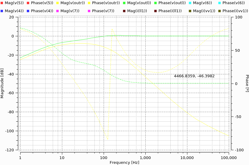

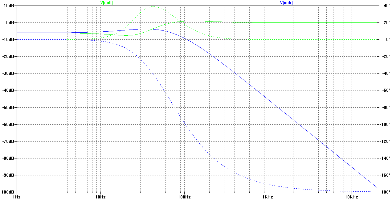

Very interesting thanks, just one question, do you have a specific op-amps in mind that can be used on the Figure 11 ? I try on Ltspice different op-amps and the response change a bit......all the best
That's funny... I would expect it to work well with just about any unity-gain-stable voltage-feedback op-amp with a gain-bandwidth product of a few megahertz or more. For example the TL071...TL074 series, OPA134...OPA4134, NE5532 or the NE5534 with a 22 pF external compensation capacitor. I would not recommend the LM358 or the LM324, though, because of their class-C output stages and small gain-bandwidth product.
What op-amps did you try?
I'd say the 1178 is not really good for the application. It is a micropower opamp with a somewhat pathetic slew rate of 0.025V/us. It is little wonder that it has problems in the higher audio frequencies.
The 1115 is *much* better, with a 10V/us slew rate, and decent specs across the board. They are really expensive though. Personally I'd just take Marcel's advice - in particular the 5532 is a solid workhorse and costs less than a tenth that of the 1115.
www.hifisonix.com
Joined 2003

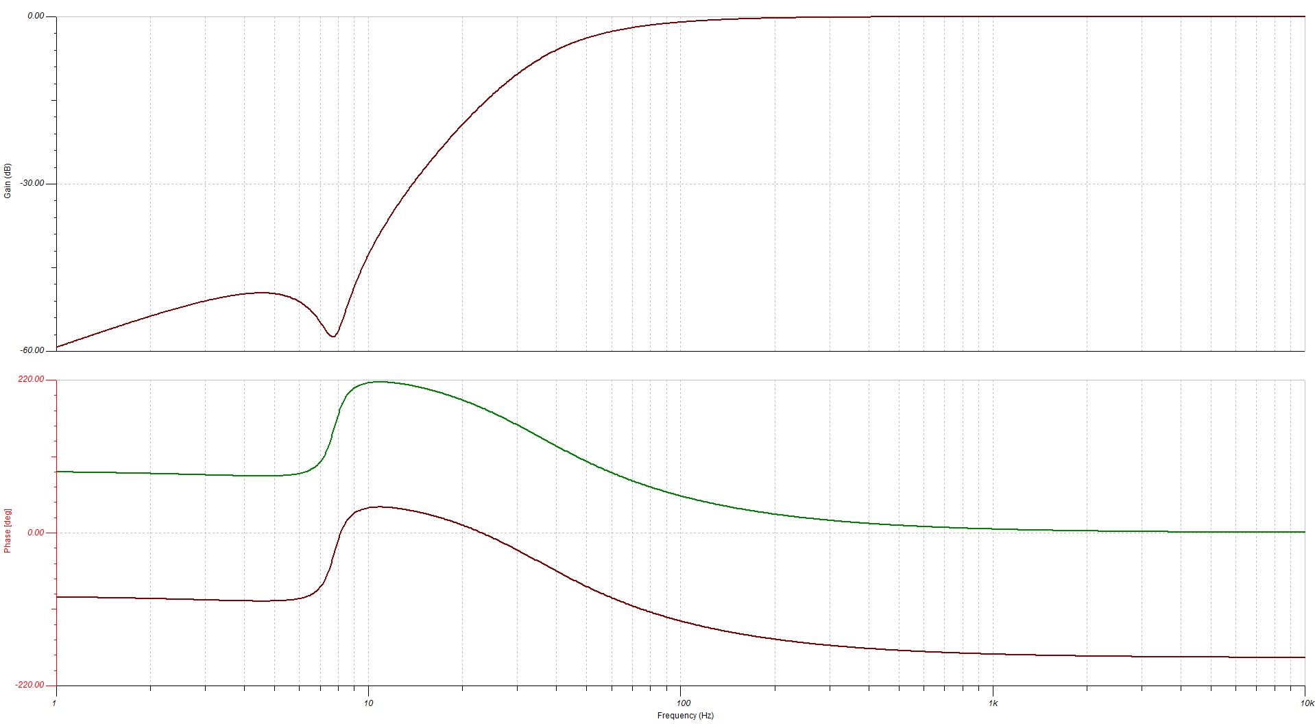

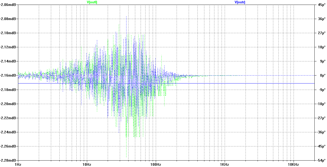

I try with LT1178 and the response in the first picture on the left then LT1115 second picture.......thanks again

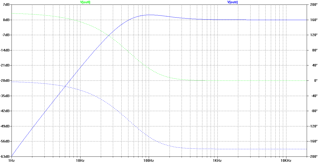

Plot group delay on the right hand axis.
Im afraid with standard filter approaches, phase shift comes with the territory- but in my experience for rumble, it makes little difference. (I can switch mine in and out - Sallen-Key type).

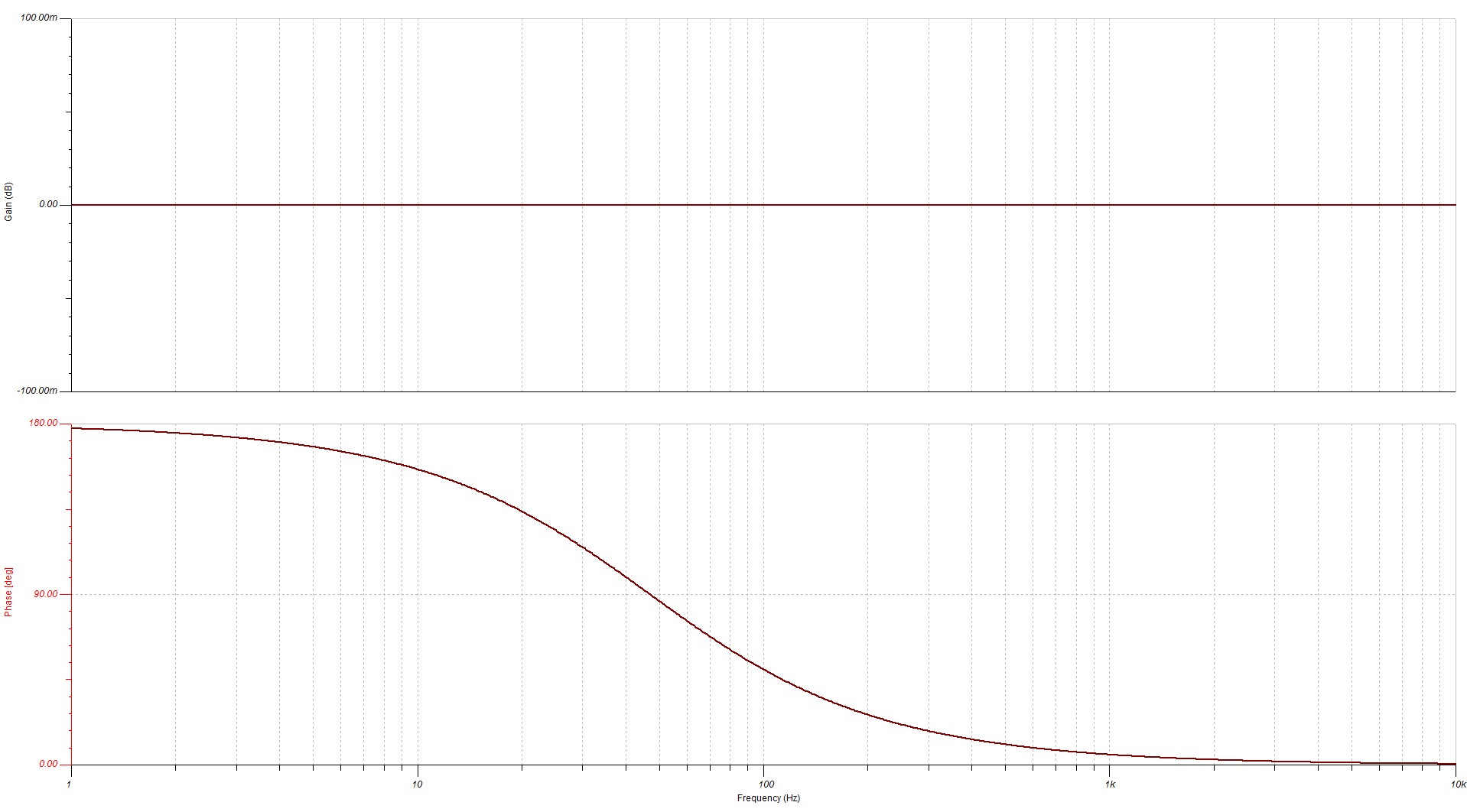

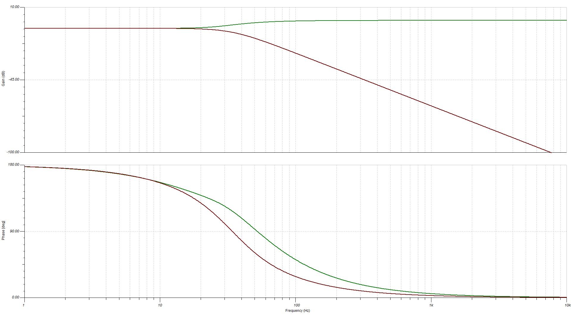

It's a crossfeed system with unity in-phase response, so by design, the phase response for L = R looks much better than the phase response for L = -R, see the attachments. The plots are for left and right in phase with unity amplitude, left and right 180 degrees out of phase with unity amplitude, and for unity amplitude left and silence right. The idea behind these crossfeed systems is that low-frequency audio is usually panned to the centre, so L = R, while rumble and record warps are predominantly out of phase, so L = -R.

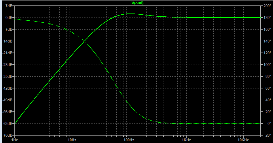

This is Self's circuit on the same scales as Marcel's, other than I've re-scaled the vertical axis on the first one. The effect of the all pass is seen in the antiphase signals - but that only relates to antiphase warp and vinyl ripple signals that are way down in amplitude. The in phase and one signal silent music signals are much more polite phase responses, although the in-phase is not the flat line of Marcels.
