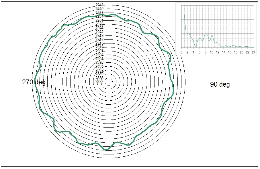

Some of that is great engineering, but we are in the 21st century now and have amazing processing power at our fingertips.
Turntable speed stabilty worked on looking at new ways to measure what is going on. Example attached to show the scale of the problem. You record 8-10 seconds of a fixed frequency on a test record and feed it into a short python script Scott Wurcer wrote and bingo.
So what does it show? Well the biggest perturbation is the 0.55Hz from the record not being properly centered and you can see a couple of peaks from the arm cart resonances. Might be a bit of bearing wear as well. Certainly needs a tune up! But all of that will modulate the wanted signal, audibly or not and no amount of filtering the LF will get rid of the modulation. You have to address as much as you can in the mechanical domain.
Hi Bill, My only experience of the speed stability came from Michael Fremer's columns is Stereophile. I never realized how much richer the subject was.
That polar plot display is amazing! I especially like Luckythedog's plot with 2 revolutions.
