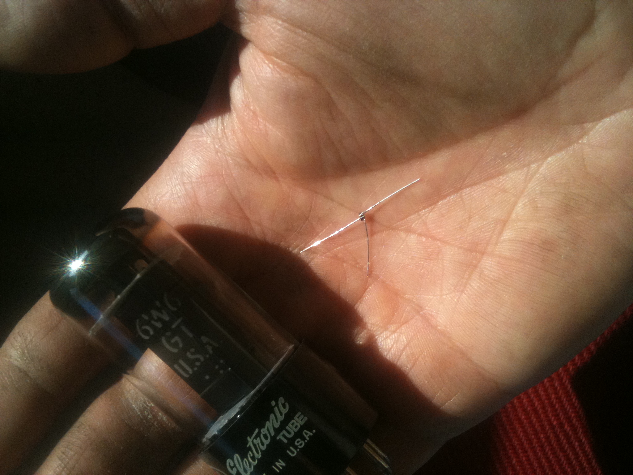

Hey cool thread. I've only skimmed thru, and looking forward to really read it. I am playing around with these little eGANs but must say I wish they were a little more handle-friendly
I know the small size is great for high frequency work, but for < 2-4MHz can't a SOT223 or something like that do as well? Or even better a DPAK for proper connection to PCB copper area for heatsinking? It sure would make it easier for us DIY'ers.
Here's a pic of my attempt to make one of these FETs DIY-able.
Thinking about it I've realized that if we are to use GAN-FETs as a better device than classic MOSFETs, we should switch them as fast as they can be switched, and when rise times < 10ns we will start to see ringing on the gate. Ringing on a MOSFET gate isn't so critical, since they can handle at least 20volts. The eGANs can't handle more than 6volts, and should be driven to 5volts for proper ON state. Even 1/2" of wire will risk swamp the benefits of GAN.
But of course, for DIY, and if we accept > 10ns rise times, still better than any pwr MOSFET, having some GANs in packages we can solder on the kitchen bench would be really nice. If nottin else for experimenting.
Hi Semper,
nice pentode you have there. After all, there isn't much difference between a triode and a FET. Except size maybe...
EGaNs are fast, and as you say, packing them close to the driver side is key to keep their original benefits.
That's the Uber-EGaN reasoning in a nutshell.
-E
-E
