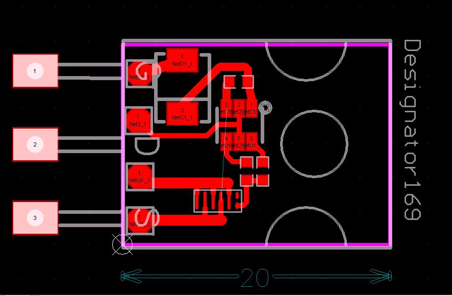

Luka,
here's a stab at the EPC2010 on a TO-220. Nothing particular really. Bluefusion also has this in mind but without heatsink I believe.
Yes, the PCB would be the same size as a TO-220.
For the tab/heatsink I would choose copper in the same form factor as the TO-220 (and the PCB). Then, use epoxy glue, enough to cover all of the area, and immediately squeeze the two parts together with a laundry clip (preferably a strong one) taking care to keep the PCB (the mosfet substrate) tightly parallel to the copper. That won't be easy, so you want to mount a few spacer components approximately the same height as the mosfet chip on the PCB corners, before glueing. Maybe 0603 or 0402 resistors?
Once the thing is hardened you can deburr, make it look nice and post a pic here
One more thing: I'd use a 1mm or 0.8mm thick PCB.
Also, ideally the epoxy should be one with good heat conduction.

I don't see the need for an additional heatsink; by adding more layers than are necessary you're just going to reduce overall thermal transfer.
However if you were going to package the device like this - I'd want to use 2oz copper, to cope with the current, and I would use an epoxy specifically designed for thermal transfer such as Arctic Alumina Adhesive. (the silver version, while nonconductive, is slightly capacitive.) This would definitely make a more robust device for non-permanent installations

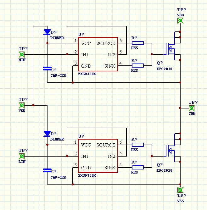

I think the best way to use them is to make a little module with 2 fet and a driver (for example the LM5113) and a decoupling capacitor, in that way we have all the high current nodes in the same place, and is easier to deal with the parasitic inductance.
The module can be made from a aluminum base pcb like this
Aluminum PCB | Metal Clad PCB (MCPCB) | PCB Products | Amitron Corporation
elevator
Ok, so if we include the bootstrap for the high side, that would be a 6-pin module?
Funny, just today I was talking with a friend at a company manufacturing thick-film hybrids (usually on ceramic PCBs) and he suggested alu-cored PCBs also.
smms73
Yes, that's right, a 6 pin module.
your proposal of using the zxgd3002 is very good , we need a way of using conventional mosfet drivers with the eGaN FET.
I just don't like the idea of using separate mosfet, because of the parasitic inductance's.

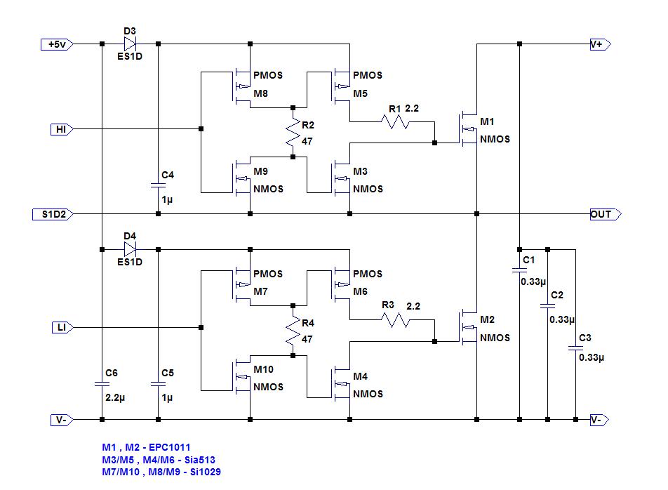

I think we need something like this, its like elevator driver with the add of a input resistor and a clamp diode for preventing that the npn transistor saturate.
A 8 pin module, but it is best to use more pins for the V+ V- and OUT for current and mechanical stability of the module .
have make a mistake in the position of the clamp diodes, this image is the correct

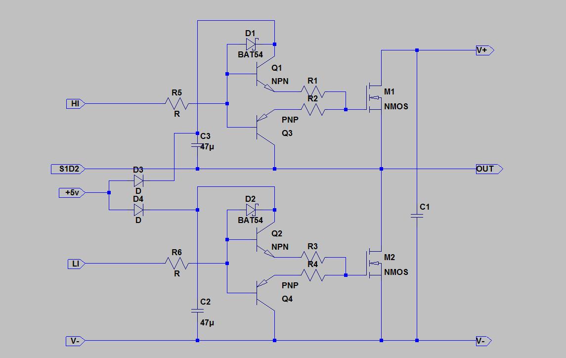

elevator
Something like this, guys? Two granmas? Anything else? No body diodes?
Now the challenge is to turn this into a one-sided PCB, no jumpers :D.
I wonder if the mosfets should have heat carried away from their substrate (ie upper) side as well, eg with a spring clip. I could have a thermal sim done once the layout is here.
I like the aluminum base PCB because you could directly screw it onto a heatsink.
On the upper side maybe conformal-coat it (in black, so that non-forum-members won't have a clue :D
elevator
Are you thinking of discrete BJTs or are they to simulate the driver chips?
The additional two pins make sense.
smms73
yes, they represent the transistors inside the zxgd3002.

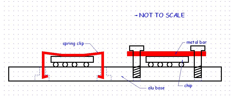

I'd like to throw in a few opinions here :)
These fets are designed to have their heat removed from their 'top' side - opposite the connections. This is why the original idea of laminating them between a PCB and a copper tongue was so promising. Mounting them on an alu-core PCB without any sort of sinking on the top will result in 1 thing - they will desolder themselves!
While alu-core board as extra heatsinking may not be a bad idea, it is extremely costly, and since you would still need to sink it from the 'top' side I don't really see the necessity.
Also - that circuit is plenty simple enough for a tiny 1 sided board :)
yeah - the substrate needs to be cooled, mainly.
Nice thing about alu-base PCB is that you already have the mounting base without additional thermal glueing - the only thing left is, as you say, to figure out a way to get the heat off the chip substrate. I mentioned spring clips (eg berillium copper), or even a bar on top of the chips, say screwed down into the PCB. See drawing.
Both of these may be difficult to implement, and perhaps not effective enough, so I would still like to keep the FR4-to-metal-tongue option open.

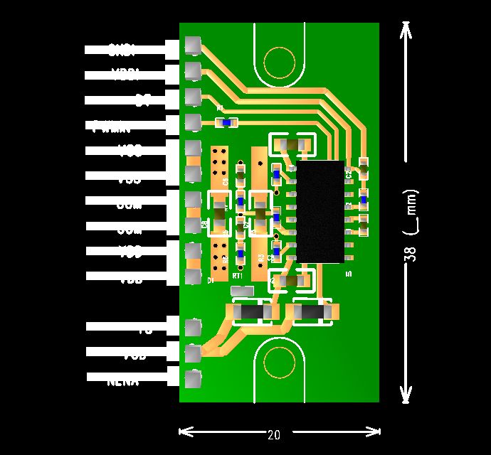

14-pin UBER GaN with PWM input
Hi All,
After posting the Uber with EPC2010s and Zetex drivers, I spent some time thinking :scratch1:.
The EPC GaN mosfet has very little gate capacitance, so does not really need large amounts of drive. Slamming the gates on and off only increases ringing and high-frequency noise, especially with not-so-short PCB traces as typically unavoidable in through-hole designs. What these mosfets need in my view is some clean drive, with clean and short traces - IOW physical proximity to the drivers.
So, considering that I already was looking at a 9-pin module using the ZX drivers, I thought why not directly use the Silabs driver instead. Available drive current should be plenty, and mounted close to the mosfets, parasitic inductances can be minimized for fewer losses and better EMC behaviour. Maybe I could even push the PWM frequency up a bit towards 1MHz without dissipating too much.
The preliminary result of the effort is a 14-pin half-bridge module, which should bring hundreds of watts from PWM input to output inductor in a zip. All components are mounted on the top side, except for the two mosfets (see pics). This allows their heat to be dissipated through the substrate to an alu or invar plate which in turn would be mounted to a heatsink via two screws. This time, pins are spaced a DIY friendly 100mil :)).
Goal is 160V Vdd-Vss, so passives must be rated >=200V. Before finishing the layout, two things:
- I plan to add a few more thermistors mounted close to the two mosfets, for testing. Size 0402 NTCs should fit on the bottom, staying below the height of the mosfets. Their contacts would be brought to pads located conveniently, but not brought out as regular leads.
- There is a hitch with this combination of driver and mosfets. The GaNs do not like Vgs much over 5V, while the Si824x goes into undervoltage lockout below 8V or so. Maybe somebody can help with the translation here. I would like to set the driver VDD to 9, maybe 9.5V to keep sufficient margin from its 8V UVLO. Other than a TRANSIL diode (eg this) or a resistor divider :eek: nothing comes to mind.

I have made some spice simulations of the zxgd3002 driver that i have post, and it has problems with dV/dT induced turn on because gate threshold voltage in this type of fet is very low.
I have made a new schema based in EPC demo boards, it is much better and the new parts are cheap.
Tomorrow i will test this.

Hi All,
E
The Si8244 don´t have Output Sink Resistance low enough for preventing dV/dT induced turn on. and with this drive you can not chose Output Source Resistance, to slow down the turn on, and of course the eGaN FET only permits 6V of Vgs.
And, this type of drivers have problems with Pulse Width Distortion (5,6 ns , see page 6 of datasheet) , because the signal is modulated in a radio frequency wave.
If the pulses at the output of your amplifier are 1us wide with 5,6 ns pulse distortion you end-up with (5,6/1000)x100=0.56% error in open loop.
This will result in poor noise and distortion performance of the amplifier.
This drivers are good for professional audio, but not for home Hi-Fi where minimum noise and distortion are required.
