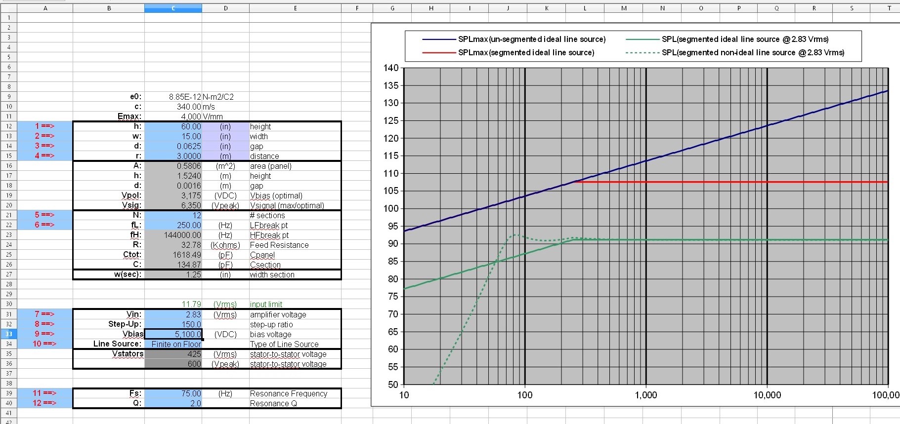

OK, I re-read bengal's thread due to his panel size being similar, and think I have a definite plan, but want to run a few things by everyone.
Proposed panels would be 15x60 inches (380x1525mm), this should be plenty big area-wise, and loud with a 200-250Hz x-over. I thought about 150Hz but think I'll stay at 200-250 for several reasons.
Eleven wires per inch seems standard with the last few builds, I think I'll stick with that.
.0625" also seems good for spacing, check.
For segmentation, I'm thinking Configuration 2 for ease of construction.
Speaking of construction, I've lots of baltic birch, and think this should be strong and stable enough for frames/slats.
Would more in the way of step-up to get healthy SPL be advisable? (I'm assuming) ...as my current step-up is 75:1 IIRC.

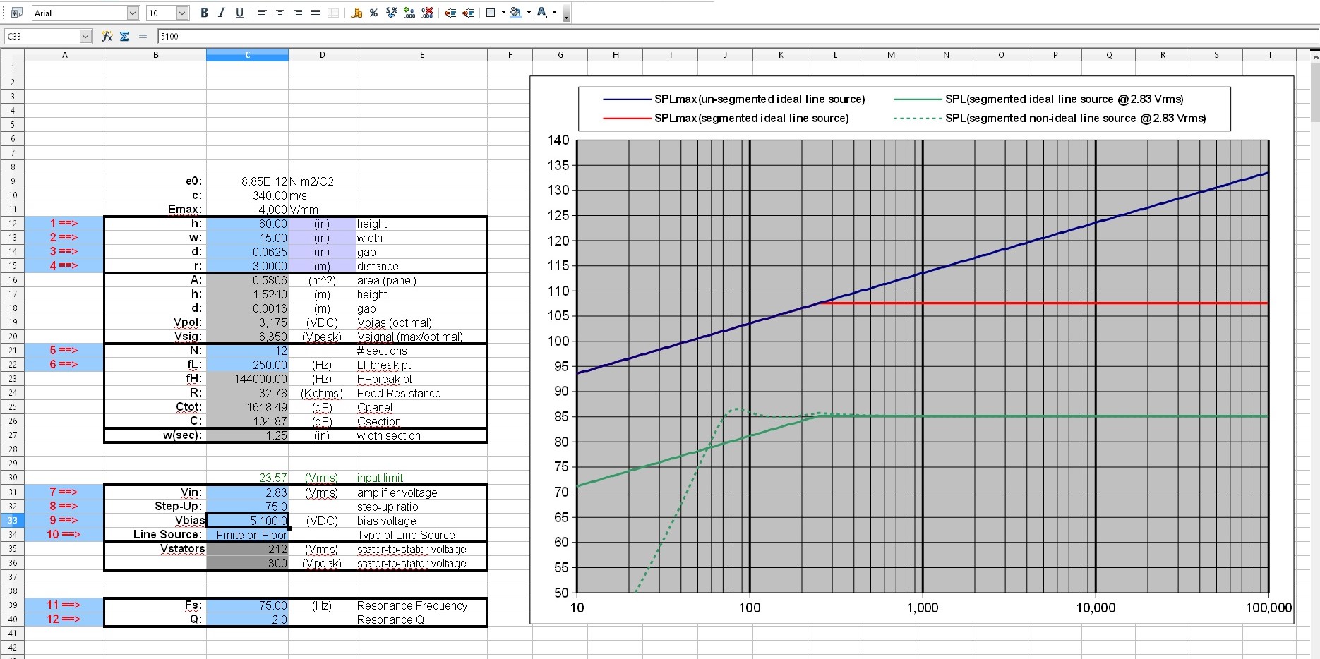

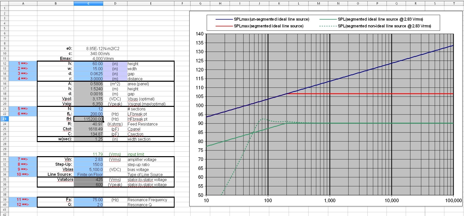

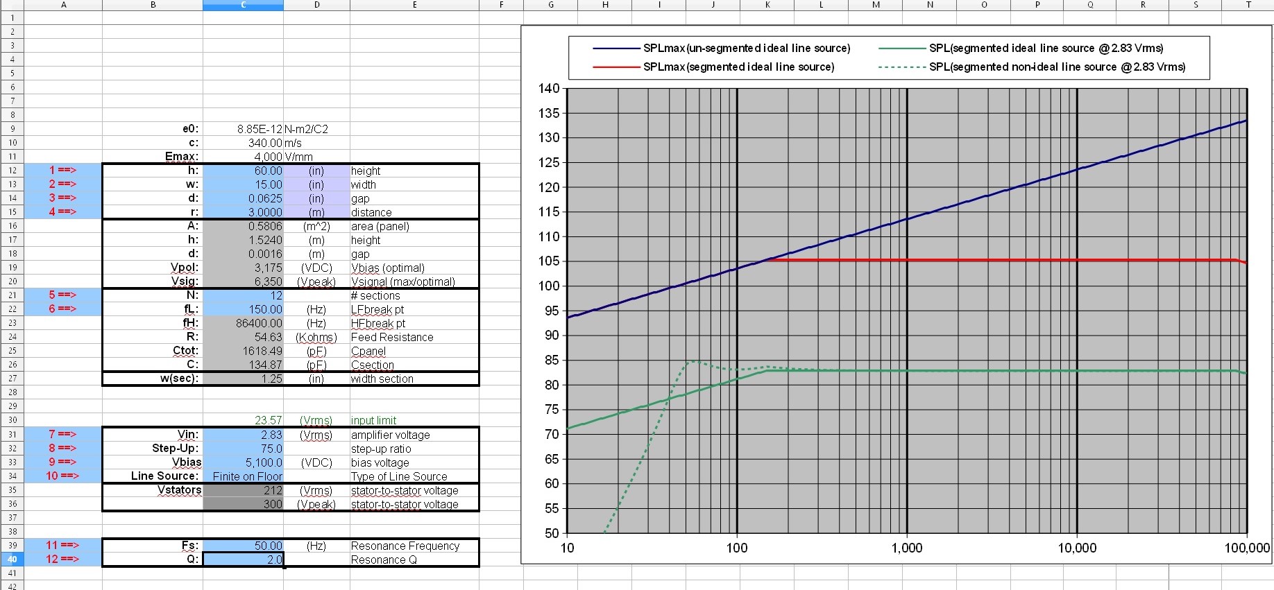

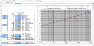

I ran some simulations, and this is what it spit out for 150, 200, and 250Hz/fL. (see attachments)
First set at 75:1 (150 & 250Hz/fL), second set at 150:1 (all 3). My bias supply output is 5.1k, so this is the number I punched into line ==>9, I hope that is correct.
Note: I did not delve into the full 'seg_esl_ui' program, I hope using what I did is OK, and the sims are correct, at least in the ballpark.
SPL increases significantly with the 150:1 ratio, I think me likey...;):D

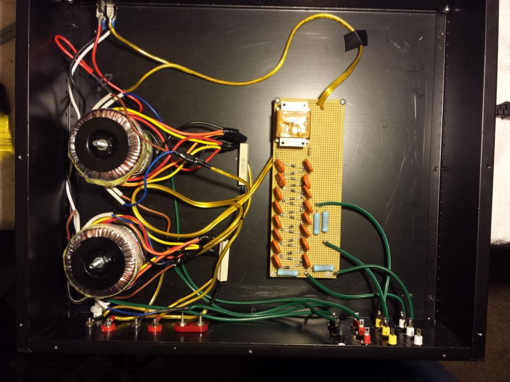

Also, the way I had my electronics situated for my curved panels was in a single box, both sets, two transformers per panel.
I stacked them vertically next to each other, bolted to the bottom plate of box, with thick isolation/shock mounts made of rubber/urethane, and the supplied big washers. (see attachment 1)
Can these toroidals be stacked on their side in a horizontal fashion? Or does that break an electronic rule I'm not aware of..?
And if they can't, do all 4 (or 5-6) need to be stacked? ..or could they be 2-high, next to each other? Follow?

All sounds good except with D/S = 0.0625” you will want to use a lower bias…something around 3.5kV.
Transformer options:
Here are some links to the tests I performed on Bengel’s transformers:
http://www.diyaudio.com/forums/planars-exotics/286989-about-take-esl-plunge-29.html#post4752565
http://www.diyaudio.com/forums/planars-exotics/286989-about-take-esl-plunge-30.html#post4757159
An alternative for your project would be a set of transformers from an Acoustat Spectra 11. They have a step-up ratio of 140:1, work great with segmented panels, and can handle over 60Vrms @ 200Hz. They show up from time to time on ebay…actually, I have a pair I will be listing sometime in the near future. If interested, send me a PM.
With fL=200Hz and bias = 3.5kV, a step-up ratio of 150:1 will play louder than 75:1 for a given volume setting, but the maximum peak SPL before you start generating ozone will be the same. The difference will be that you will reach that level at a lower volume setting with the 150:1 than with the 75:1. Basically no matter what combination of bias, step-up ratio, and input voltage you try, you won’t be able to exceed the red curve on the plot without starting to generate ozone. Oh, speaking of the red line, meant to ask if you meant to set the distance to 3m because that is your listening distance? Otherwise, you might set it to 1m so SPL will line up more with sensitivity specs for dynamic drivers.
The spreadsheet has an estimated limit for the amplifier output at which ozone would start to be generated in cell “C30”. When you exceed the limit, the Vin: input cell will be highlighted in red. For the 150:1 you would reach that limit at roughly 27Vrms, pretty close to the typical output of a 100W/8ohm amplifier. For the 75:1 you wouldn’t reach the limit until twice that, or 54Vrm…typical of output from a 350W/8ohm amplifier.
Due to the dynamic nature of music, you can generally use a larger amp than these numbers indicate without generating much ozone. However if you play steady test tones, you will find the limitation a good estimate of when air starts breaking down and ozone generated.

Yea, I suspected as much as far as the SPL/red-line, and the bias, but wasn't sure.
So the spacing has to be increased, or the bias decreased... Which is preferable?
You will find that for a given fL, the red line won’t change level with change in spacing; only the bias and stator voltages required to reach the red line will change. The only way to move the red line is by changing fL or total width. In general, it is best to use as small a spacing as possible so lower voltages can be used. You just need to make sure the spacing is large enough to reach the SPLs you want without the diaphragm hitting the stators. For hybrids crossing in the 200Hz range, 1/16” is a good compromise.
Is it a relief on the amp to run the ESL electronics over-sized, or doesn't it matter much?
It won’t really matter as long as you aren’t running into saturation. Using a slightly over-sized transformer for the task will ensure that isn’t a problem.
Excellent. Thanks again for the info in this preliminary stage of the project, this sums things up nicely..:)
I will be contacting J-wire tomorrow.
I'm sure there'll be other concerns/questions as i move along and make progress, but we'll burn that bridge when due, your post is a big help...
