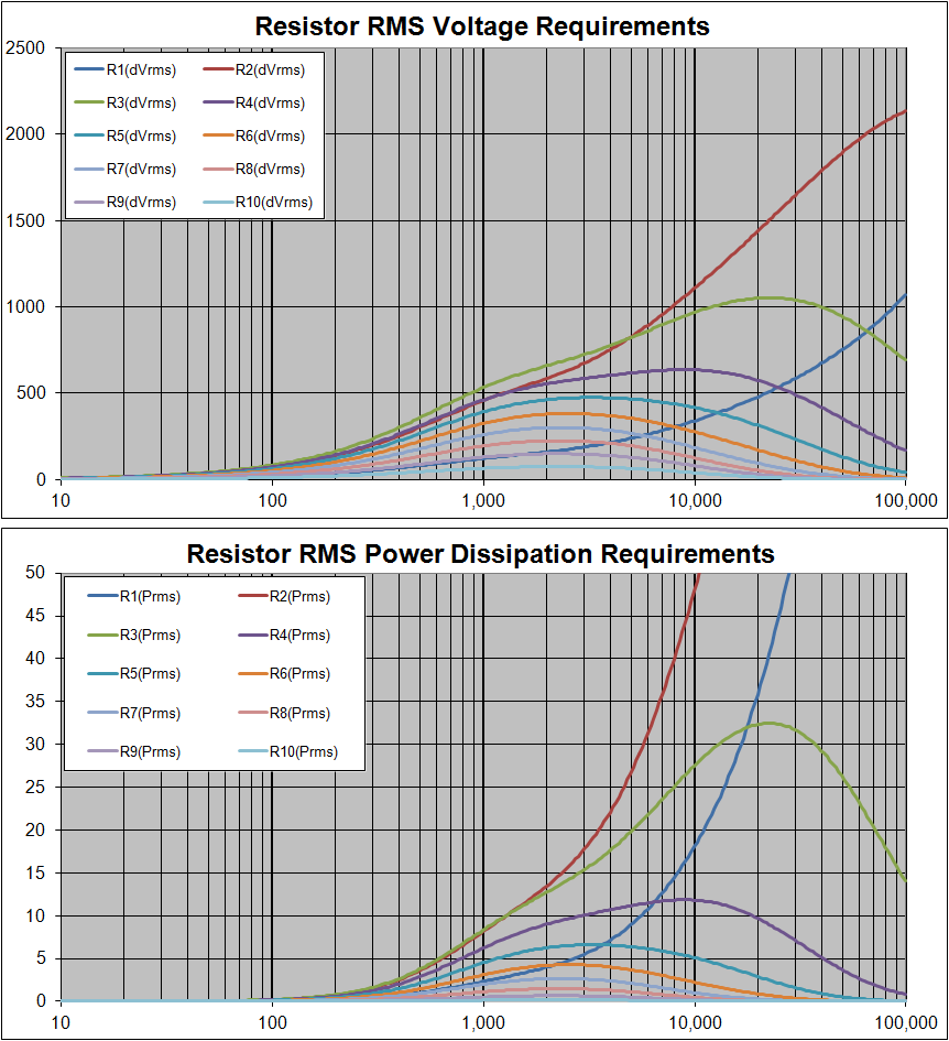

My step-up ratio is 152:1, and my amp is the Emotiva XPA-5, utilizing 2 channels for ESL duties. Each channel is rated at 200w@8ohms, and 350w@4 if you feel like running sims/tests
Find attached the worst case RMS power and voltage requirements for your ESL design.
As mentioned previously, when playing music rather than high-level test tones, average power dissipation is usually 1/10 or less of the values shown. The important thing is to abide by the voltage rating by using HV rated resistors, or putting 2 or 3 in series to achieve the same result.
