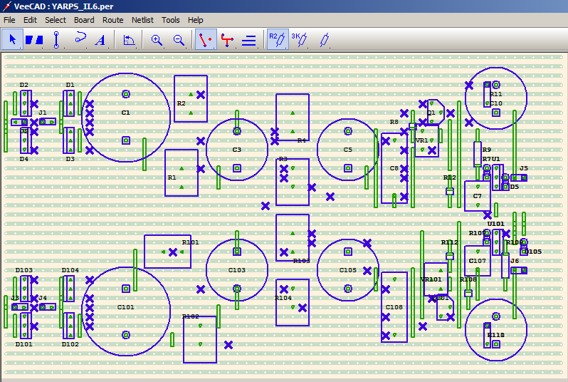

Finally got down and had a good look at the circuit layout from my usual 'non-ground-plane' perspective and a query comes to mind (not sure as it's about a rather different component layout that quite possibly will effect the filter behaviour
If each of the buffer fet pairs draw 10mA each, this leaves about 15mA per IC/rail (total 80mA/ch/rail) So, perhaps it might be worth looking at using a separate supply for the ICs and raising the supply voltage up to +/-15 volts, yes? (can simply trim your pcbs later on and link other supply directly to the ICs)
My Sunday 'Sudoki' exercise ....
As each of the gyrators (both high pass and low pass) only connects to the signal path in 2 places, the cct can be re-configured to bring all the jfet pairs together (and maybe even a common heatsink strip?) hence simplifying supply paths and leaving the ICs (and maybe their new supplies) as separate sections - might make the idea of the 0volt ground plane a bit complicated tho, particularly if looking to make a separate pcb for this filter/gyrator part (maybe header board) ...
This is just a 'maybe thing' so don't waste any serious time on it

Hi James the board has provision for two trim pots. I envisage only one being installed iether high pass or low pass, depending on which needs attenuation. I was planning to run volume control prior to the input on the board (and trim with the on board trim pot to match levels).
The boards are basically just something you can insert inline with a line level signal which splits it in two so if you wanted to implement a volume control after the filter then I don't see any issue with that. You can simply put links in each trimpot position and put an 11K resistor in the input to earth position (in front of the trimpots).
That is a good point. when I was originally thinking about the layout I think I was thinking along these lines but when I actually started laying out components it went out the window. I wasn't going to do any form of heatsinking on the jfets, but was planning to tie the pairs together so that they are thermally coupled. My main aim with this prototype was to make sure the stuff around the IC's was compact (as I'm pretty sure that was where the oscillations were coming from) I was secondarily trying to make something that would fit within 10 X 10cm to take advantage of the cheap prototyping service avaiable. (final cost for the 10 boards with shipping was about $29 US) just over $32 aussie.

Okay, got all that and won't waste any more time on alternative layouts if/until later - will see how the pcbs turn out, eh? An easy try for the separate PS for the ICs if required ....
I think it's the 'hot-rodded' DCB1 Salas shunt that's already setup for +/- 10V @ 250mA so that makes it a pretty easy one - the blue or black ones - have a few spares here ...
I'll have a look at your Yarps reg pcb and see about a pcb design and how it comes out - it might benefit from one of those 'keantoken' 'K-multipliers' in front of it and an opportunity to try out that Quazimodo 'Bell-Ringer' snubber tester, etc - hmmm ....
