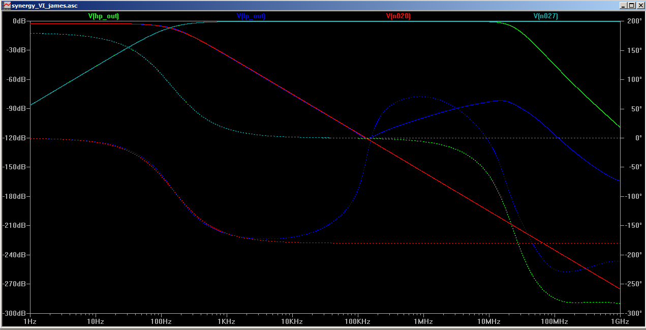

Hi James, from what I have done with passive crossovers you can get good phase matching with combinations of odd and even electrical orders. Additionally you can get the same overall slope with electrical 2nd or 3rd order filters just by playing with the values. This means if I am not wrong that I can develop a passive filter (in simulation) and realise it with the synergy to get phase matching right.
This requires one additional resistor or one additional capacitor to change the low pass or high pass from a 2nd order electrical to a 3rd order electrical filter.
Provided large phase changes are not necessary additional circuitry such as all pass filters should not be necessary.

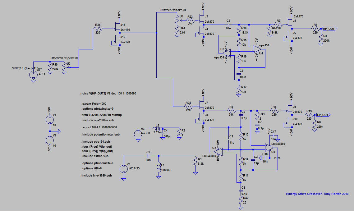

I've zipped up my latest circuit iteration with values that will give a textbook 2nd order LR at 140 Hz. Also attached are screen grabs showing the circuit and simulated output.
Note I have not yet tried an LME49860 It would not do well in the breadboard. The opa2134 is the only one I have physically tried.
I realized that the blog page doesn't have any info on how to work out the high pass filter values. I will do something about that.
Both the high pass and the low pass use different values that calculated to get the best result. I put in the textbook coil and cap and then tweak the values in the circuit to get a good fit to that. Research I've seen on inductors and fdnr's does show that they are out in value compared to what they theoretically should be, luckily spice takes some of the guesswork out When I did the breadboard, I'm pretty sure I compared the measured response to a theoretical curve and it was a good match.
The attached spice zip file should be self contained, so you should be able to run from the directory without adding anything into spice. You may have to change the solver to gear, the lme49860 seems to take for ever to converge with the normal solver. Actually I just checked and I have been using the Modified Trap with alternate solver.

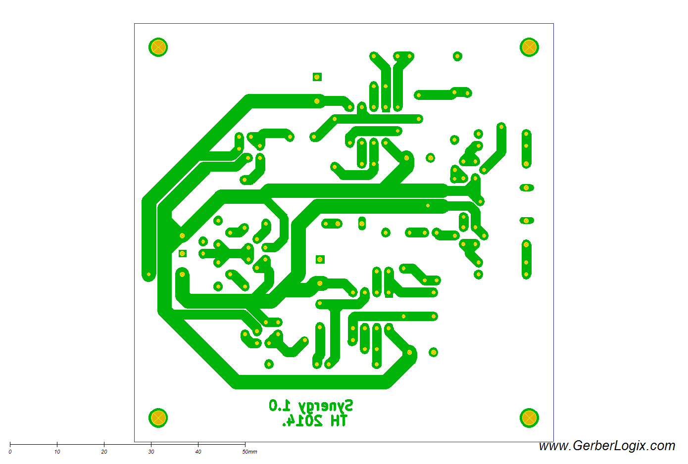

However, what I can do is have a crack at outlining the pcbs for your edification (how about that one!) - I'll knock up a pre-design with the Express pcb designer as it's a fairly easy single/2 layer program and can get all fancy later as it comes together - my humble contribution to the project.

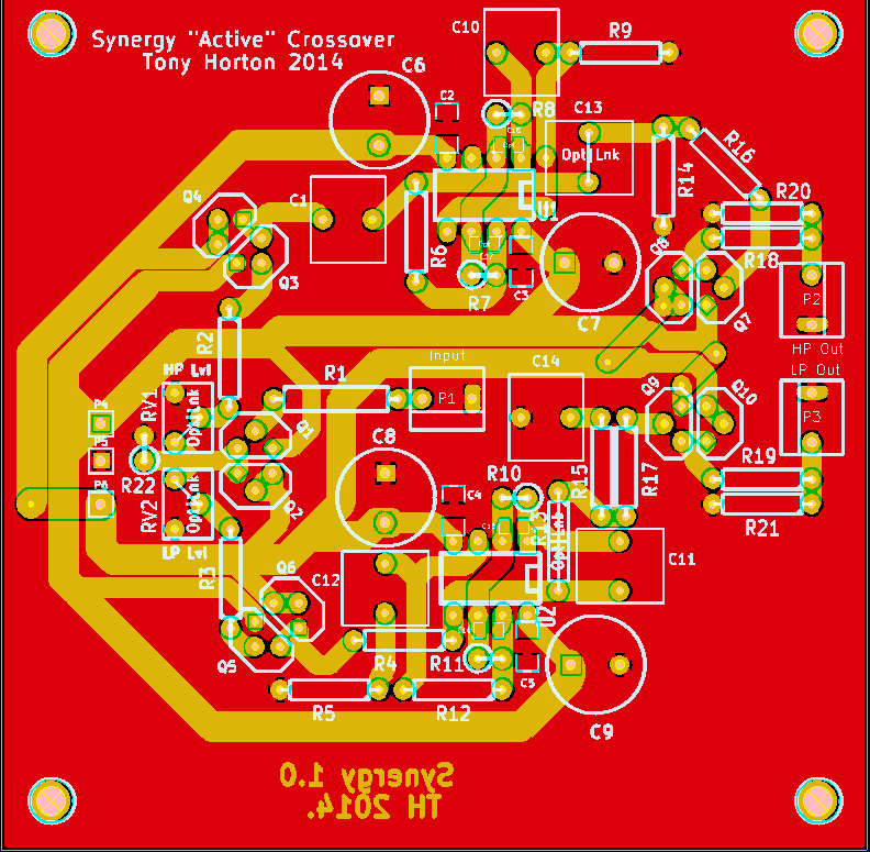

Hi James, If you would like to do a board go for it. If you can do something that is diy-able (ie that people can etch at home) that would be good. The layout I posted above, is I think, not really something that someone could etch them self (unless they are very good at it). It is pretty much a board-house job I think. Maybe you want to do one with Salen key Low pass? I do hope that the FDNR is going to be a success though.
I think my layout is good enough for me to get some prototypes done, I just have to get my head around the various gerber files I need to create for the board house to get some made (this is my first board design).
I've used some SMD components as well (caps) which may some turn people off.

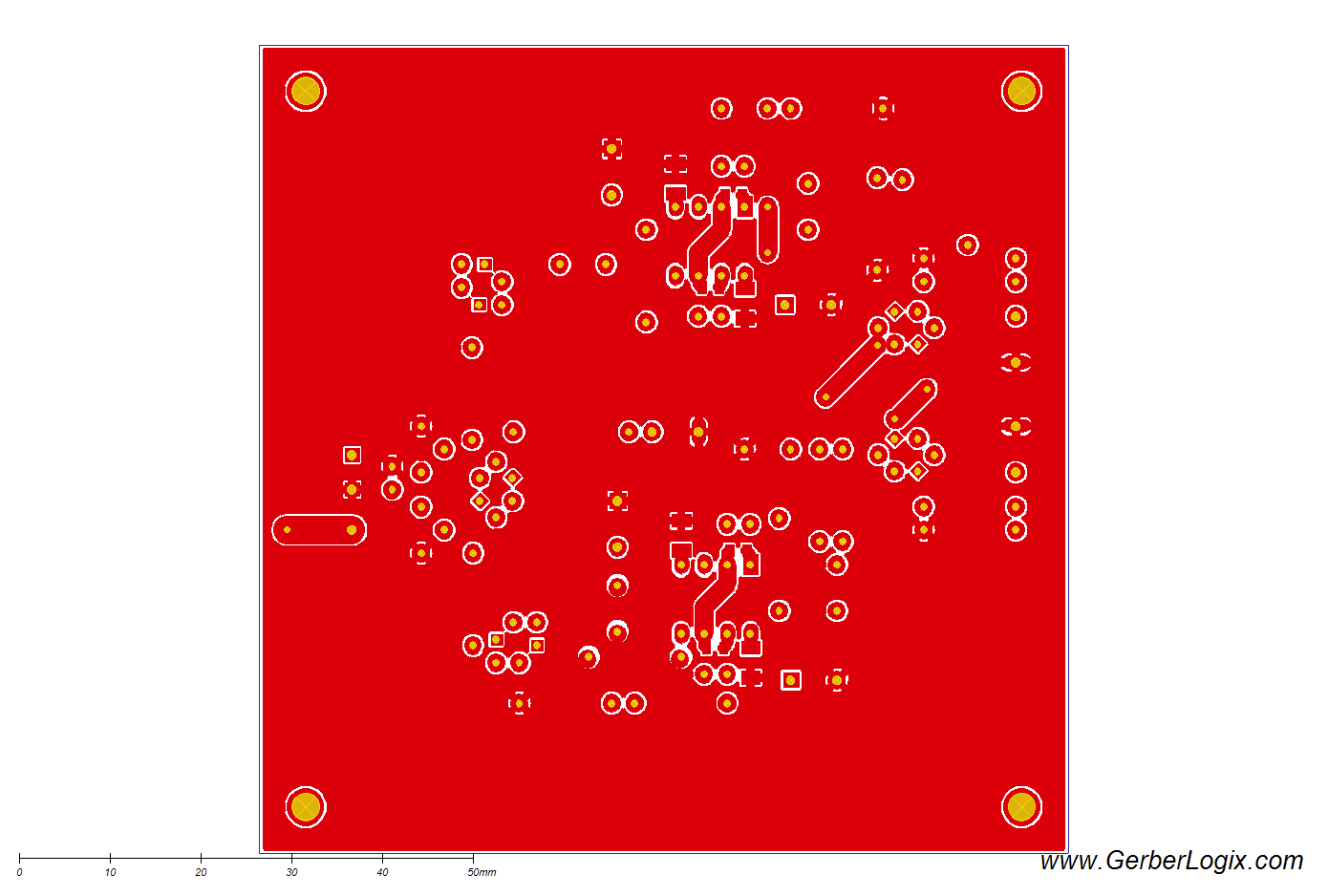

Okay, will look to see if a maybe double sided board will be okay - would do a single sided one but the power supply lines and ground returns make it pretty poor quality design - will see about a SK option too

Looks like you have the low pass sorted but that the high pass is giving you grief. The simmed vs actual is very different, so something's amiss.
I'm also very lazy when it comes to math, and I've been relying on online calculators to get starting points for the filters. I suspect you are actually ahead of me on filter theory!

Yes the highpass Q wasn't right, the two SK stage Fc were too far apart. Using the calculator i didn't get close enough to the desired turnover frequencies. With a little juggling of component values i go to within 30hz of the target frequencies. I haven't measured the curves again yet, but in theory the High pass should be much closer to the intended curve.

I might have finally reached the point where I don't want to change the layout every time I look at the board Latest version attached. I think this will be the one I get done. I've spent way too much time on this for a prototype but usually with me prototype is as far as it goes (ie the prototype ends up being used).
Hopefully the low pass works ok, I will have wasted a lot of time if it doesn't I think that this is a lot better than the earlier layouts I posted.

Hi James, Top layer is ground plane yes, but the main tracks are on the bottom side. I've attached separate pics of the top and bottom layers. I read after I started that ground planes were normally done on the bottom side with tracks on the top, but it felt more right to me to have the ground plane on the top.
I've tried to minimise the number of traces on the ground plane.
This is my first non-vero board layout so I'm learning as I go I did do a PS board in kikad for my power amps power supply but I haven't made that and it is not quite the same level of complexity
Tony.
Tony.
I think I'm a bit pre-historic in that I like clearly defined earth/0 volt tracking to control current return paths and aim for single sided pcbs for ease of making them - haven't any experience about this ground plane 0 volt system but for the purposes of filtering it sure seems a lot simpler - I wonder if I can do it with the simple Express program or if have to get serious with the Sprint Layout - hmmm ...
Really good that you have designed for non-SMD resistors , altho still applicable.
The big Rifa Styrene filter caps (pfe216) won't fit your allocated space altho maybe vertical mounting ....
As you say, you can redesign these things forever and never know if they sound any better/different until you actually build one
This looks pretty good so far - are you going to get more than one made when you order? (just a hint here!)
