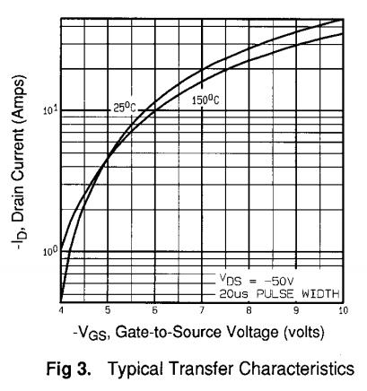

also, i understand that having the lowest possible bias through the bjt (see pic) gives lower output impedance, so i m wondering what obstacles do you encounter when lowering to much the bias. is there a sweet spot? in the pic it is around 4mA depending on the mosfet.

The output impedance will be a function of the error amp's open loop gain and the current follower's transcoductance. R6 gets to be a CCS and the follower's bias gets to be spared higher to trigger more Gfs if we are after decreasing Zo.

you mean that we dont want to be in the bottom portion of the graph in the attachment, where linearity is not so good?

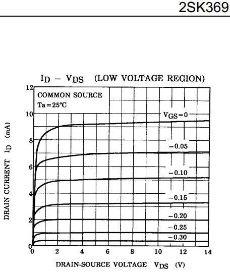

thanks for showing me bf245a looks better than 2sk170. looks also like it would require very low current to be effective. maybe something like the less available 2sk369 would be a better fit(although capacitance is higher...)?

Look how the capacitances enlarge the lower the Vds. Best is the 3rd one for low output voltages for instance. The middle depletion one is out of the question in any case with 0.1S gfs and no sinking ability.

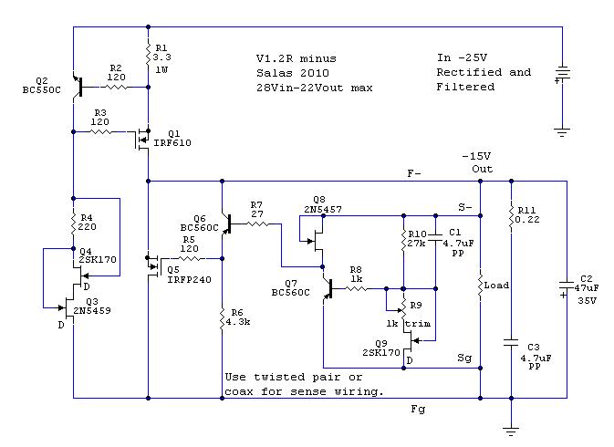

Is it possible to get -3.5V out without modifying the second picture in post 3200?
no. because of the mosfet Vgs. maybe you could get -4V or so. But if you choose a lower Vgs mosfet, maybe you could, just like i m trying to do with the V1.1. i dont know anyone who has tried yet. (the reg you are talking about is attached)

yes the third one could be nice at high current, albeit being t0-251.
the little depletion one is rated 160 mA max continuous Id. But looking at the curves, i thought that a characteristic 0.4S and around 5pF Crss at 3.3V could be interesting to test, if only to know what benefit low capacitance can bring. Or maybe this is a bad idea altogether...? Moreover, a shunt device battle Bc560c vs little mosfet could be cool :)
for comparison, irf610 has around 50pF Crss at 5V and 0.4S at around 150mA and a better 0.8S at 500mA.
