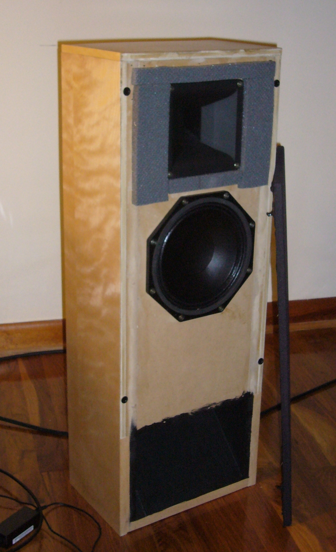

I crossed a DE250/ME20 horn over to an 8" woofer @ 1600 Hz, second order LR. It sounds ok to me.

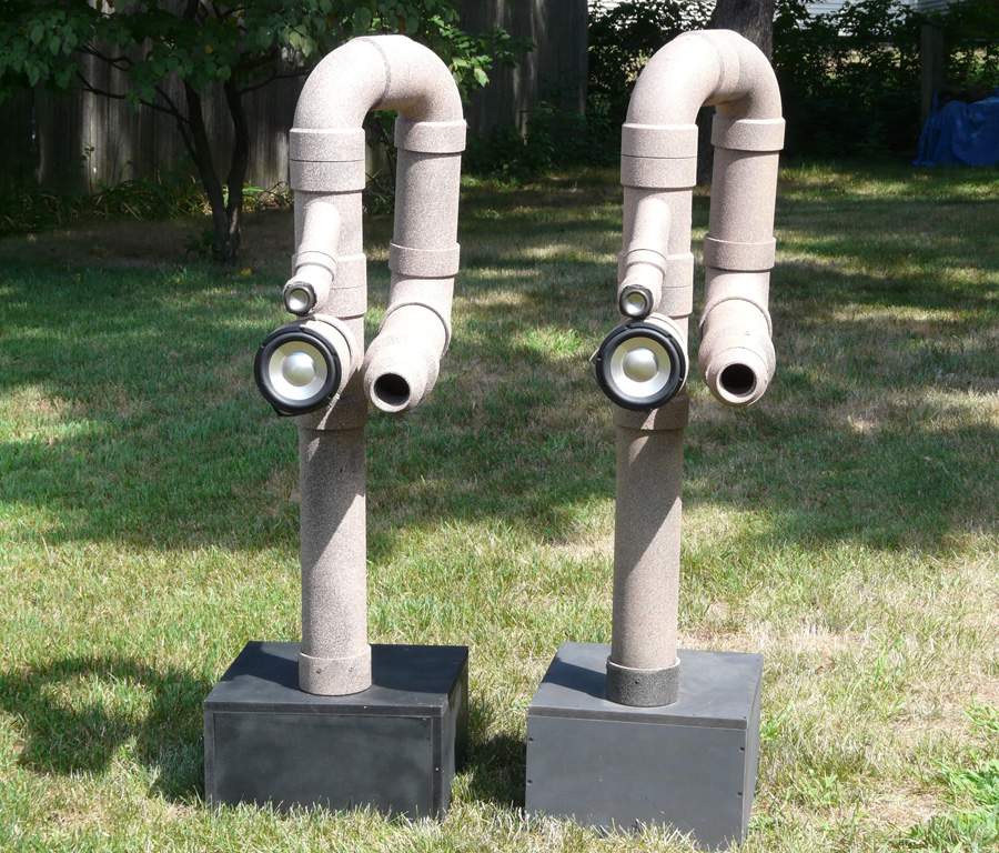

Here's a pic of a project I build I call the "Poor Plumber's Pluto". It utilizes the same drivers used in ZL's Pluto in a TL design with 4 inch ABS pipe and the inclusion of a powered sub woofer in the base of one of them. I have polars comparing my passive xover PPP's to ZL's I'd be glad to share if you want to PM me. I'd post them but they include ZL's copyrighted polars. My project cost about 10% of what his retails for.

Okay, I'm starting to sound like a broken record, but the Pluto's do not!
