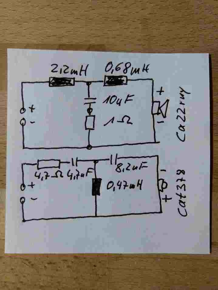

Nice. You tried the software suggestions and found a good L1 value?
No,
i went the easy road...
There once was a very nice diy speaker in the german Klang&Ton published.
(you can find it above in the thread)
A guy in a german loudspeaker forum did a more efficient version with a different tweeter (cat378) and better coils for the crossover.
This is the speaker i build.
link:
Klang+Ton-Forum • Thema anzeigen - CT 252
You did for the CA22RNY 2.2mH 10uF 1R 0.68mH low pass and then for the Morel you did 4.7Ω, 4.7μF, 0.47mH, 8.2μF high pass. Right?
YES, Salas you are right!
DCR of the 2,2mh and 0,68mh are 0,2ohms.(vs. 0,9ohm in the cheap trick)
Now i am playing a little with the 4,7ohm resistor to get my sound.
