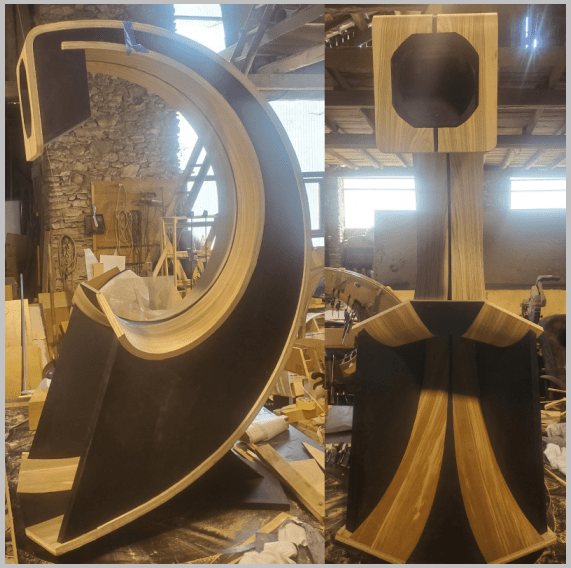

One of my friend currently works on a "Fullrange Half-Rolled Horn" of his own - I heard the 1st prototype (below) and it's very promising, over the remarkable woodwork he achieved (below).
The speaker is a custom designed 8" Full-Range. This horn can operate standalone very convincingly, but a subwoofer can be suitably added on some music styles requiring bass extension under 40-60Hz - and OK, it's not an Open Baffle, but a Horn ...

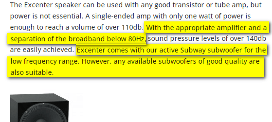

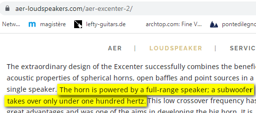

It depends on the driver you used. ...You do not expect a low cost full range will offer you good result. Did you hear the Excentre from AER?
By curiosity, I had a look to the AER website...
... And here's what I read about the Excenter - I highlighted the concerned points :
Clearly, this spectacular AER Excenter OB where you point us, @vkung , is not a completely standalone example of single fullrange OB operation, since the addition of a subwoofer below 80-100Hz option is offered by the manufacturer himself.

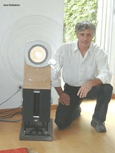

In the late '90s-early 2000s, Mr. Axel Ridtahler - the inventor of the Ripole subwoofer - made similar interesting tests (below) with a Full-Range speaker with a molded transparent horn - in the same style as what designed AER - plus the addition of his patented Ripole sub to complement the bass extension :
That said, yes : the Full-Range speaker is a premium solution for reproducing single voices, single instrument chorusing, Manouche guitars, etc... And only this makes me already a single FR speaker advocate, but I am also honest about its limitations ( as pointed by @Sonce ).

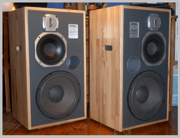

One of the formulas I found satisfactory is using a large 7" or 8" quality Midrange / Full-range loudspeaker, helping that "center role" speaker in the lower and higher extensions, to overcome the bandwidth limitations while retaining the focalisation / image advantages as best. That's what I did in my DIY 375L monitors, where the 8" midrange has a FS at 82Hz, a natural baffle LPF at 110Hz, and is installed in a quite large sealed/filled enclosure (7.5L here - the grey thick resin flowerpot you see inside, at left, in the empty cabinet ) :
Inevitably, there's a crossover here... But it's a 3-way serial-paralleled 6dB/Oct. one, using only 2 inductors and 2 capacitors, with transitions at 400Hz / 5000Hz and all speakers in polarity. This configuration leaves all that critical bandwidth "uncut" into the Midrange speaker, which works as a FR speaker in favourable conditions. The voices, the instruments are not "cut in pieces", as they come from only one speaker, which is helped in the ranges where often occurs those "deficiences" and "colorations" of a Full-Range speaker, if let in charge of the whole music spectrum.
