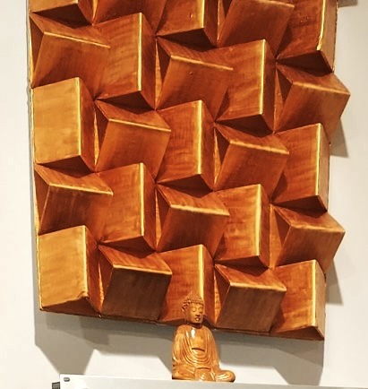

They looks like these things to me:Are the wall diffussors just alternating pieces of 4x4 wedges?
BUBOS Acoustic Panels,DIY Acoustic Diffuser Sound diffuser Panels Full frequency sound absorption(24 x 24Inch),better Acoustic Treatment for Recording Studio, Office, Home Studio(Brown) https://a.co/d/hD4nbjC

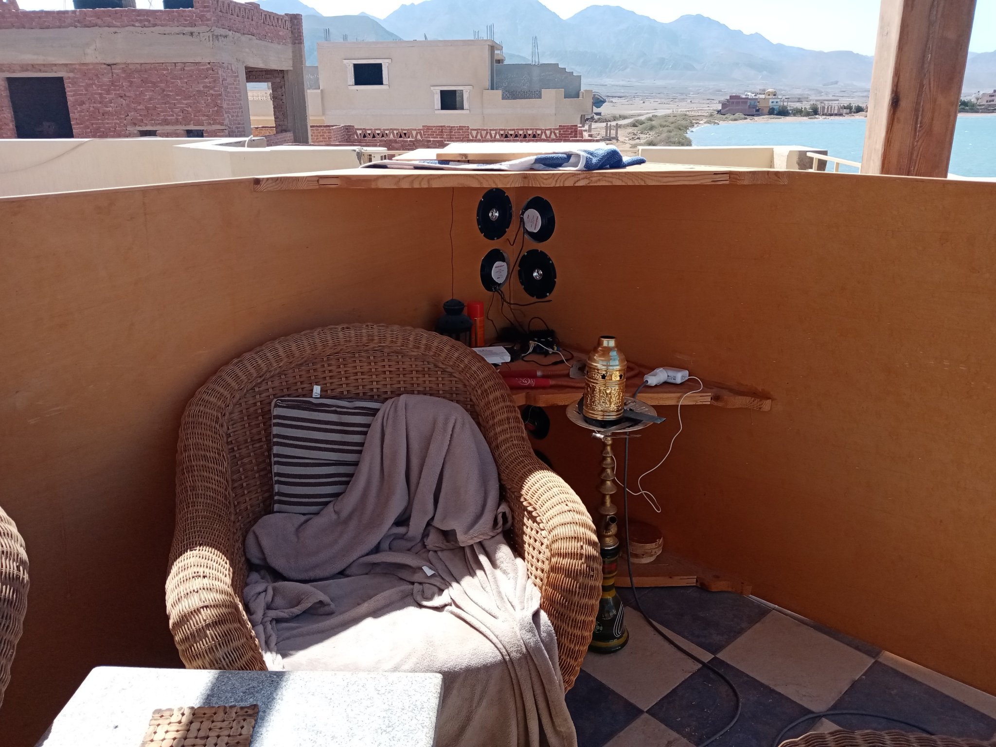

https://www.diyaudio.com/community/threads/corner-horn-meets-open-baffle-cfa.398842/

Add a resonance barfing port that is too long
for even more magic.
Just need pointless weird angles on the baffle.
Basically just cut angles till your table saw almost binds
Then pure magic erupts. Make the baffle so small
the baffle step is close to as horrible as open baffle.
