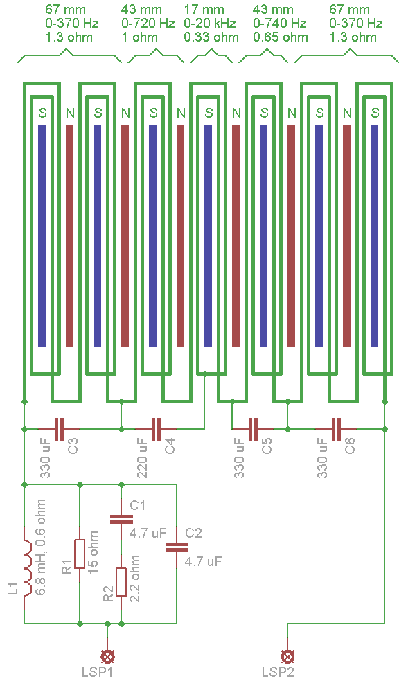

anyone have an idea how to be able to calculate this type of segmentation for a planar ?
is it useing the coil and the caps as a 2 order filter ? i cant wrap my haed around it , im terible at crossovers
The "filter" at the input is likley a trap circuit to deal with a peak, the caps spread out within the tracings I believe are to help with dispersion by making smaller portion of diaphragm work as frequency goes up. I tryed this araingment once but was not impressed with result. also tryed "shading the array" a few times by having much stronger magnets closer to diaphragm at center of the diaphragm with magnet spacing getting larger as you approch edges of diaphragm. That one was interesting as the low freq resonances were much reduced AND the midrange was noticablt more natural, BUT senativity suffers and bass dynamics as well

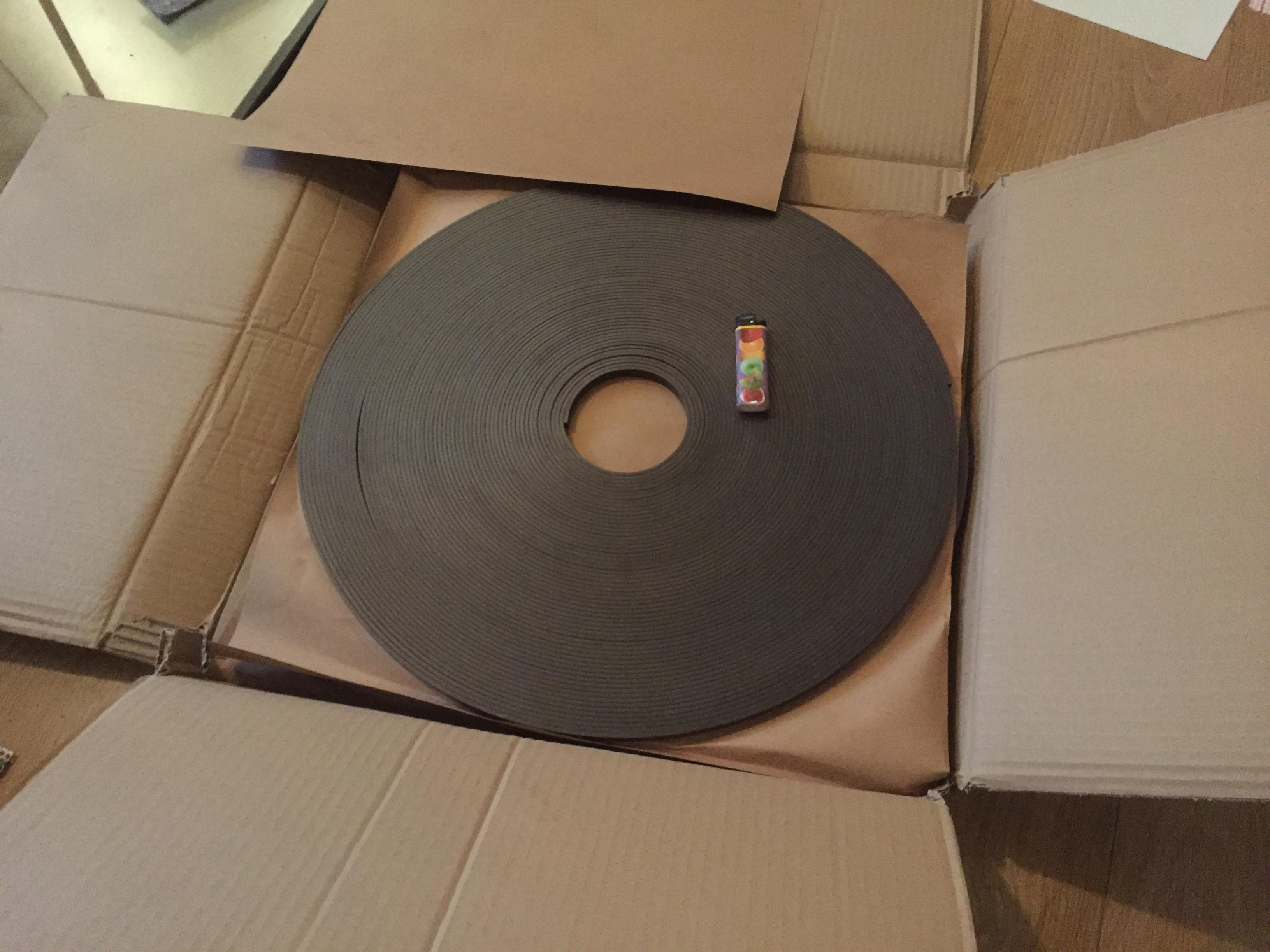

Today I found the source of my magnets :) yeaaah to bad for the guy in the middle but good for me . I will order a hefty amount since this is needed to get something cheap :) I halved the cost per meter so it's worth it I guess :) it's 250 meters before cutting :) I could make a panel or 2 I presume ;) there is only one step up if I want it cheaper and that is knocking on the doors of the German company that produces it I believe. But they redericted me instantly to the importer in the Netherlands , so I guess I can't match there required MOQ. :) must be several km of the stuff :) well I just must be glad I got this far I think.

Au au au ..... my muscles hurt like hell.
my magnets arrived its 1/3 of my body weight damned its no fun walking from the tram back to my house with it.
people looked and thought wtf are you doing its a small box how heavy can it be jesus.
there are 4 more under this top one :) now i got some cutting ahead..... like uhm allot

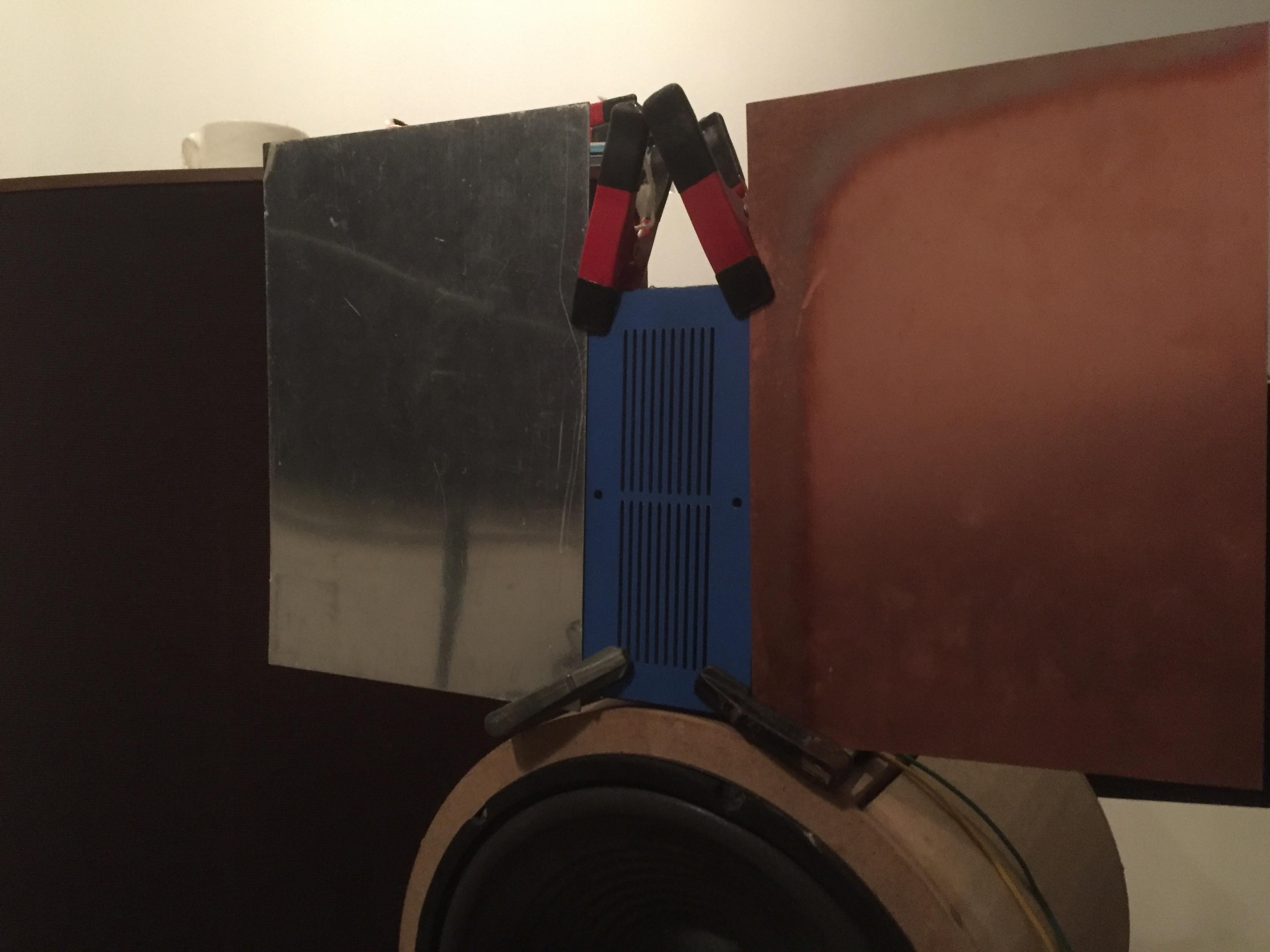

So i did a test with dumping the metal plate, normally its good to have the magnets sit on metal to close the circuit. but my thought was the magnetic strength is so low the metal could be very thin to have still some benefit. but what happens when we completely remove it ? well i removed it from the front side and measurements are exactly the same. no losses at all. i will do the backside to, and see what happens. at least it looks way way better.
it saves on perf metal to, its not that cheap. and i can make any size i want :) yeeej, although my blue HPL is getting low :( must find myself an alternative playing material. thought about a nice black high gloss acrylic front ?
Dumping the second perforated metal piece did not change anything either, if i measure up close the one with HPL instead of metal even has a straighter curve. like flat line (excet for the peak in the 12khz region).. so thats good :)
