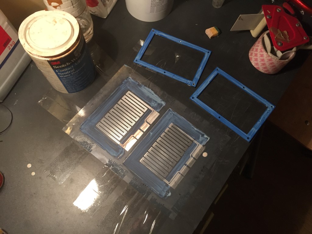

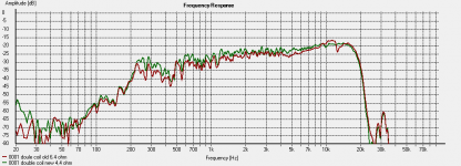

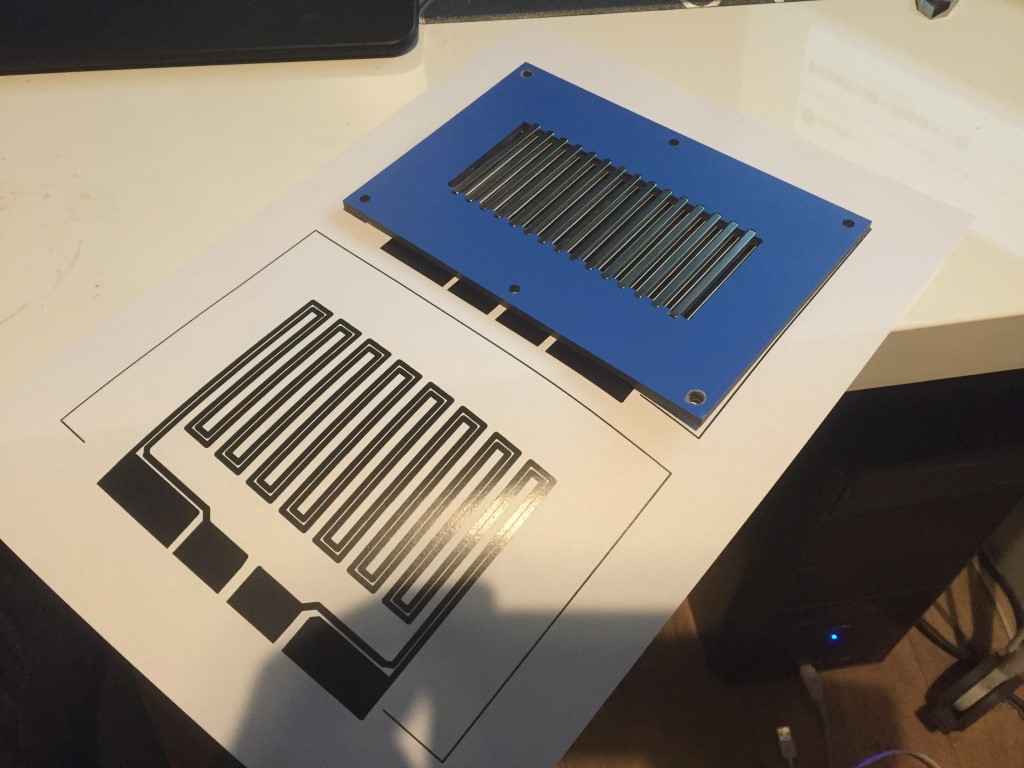

Nice info !here a measurement of an panel with 2.5mm traces and low tension vs one with high tension and 2mm traces. and one image of the first panel not in push pull.
Green single ended low tension 2.5mm wide trace
Orange same panel but in push pull with damping on front.
Red Push pull membrane with damping in front and 2mm traces.
weird enough the smaller traces although higher impedance 3.9 ohm vs 2.8 has higher output. my guess would be more of the conducting trace is into the very small 1 mm gap.
so another thing is worth trying to create a 1.5mm wide gap and see if a trace slightly larger then the 2mm of the second panel can keep up and see what happens to the peak to. field is not as strong with bigger gap, but if the trace does not fit into the gap the question is,, if a wider gap would still get more out of the traces current.
this is the reason why magnepan still uses wires. and you can get away with it in the lower end.
also nice to notice is the red panel has almost 6dB more output down low, they are exact same dimension only the tension is different and the conductor with.
also you can see the peak is pushed upwards. i wonder if you can push it so far it balances the roll off a bit.. would be nice
i am so stoked about the costs of this tiny panel its so low it is easy to decide to fabricate another one to see what happens (although my time is not limitless)

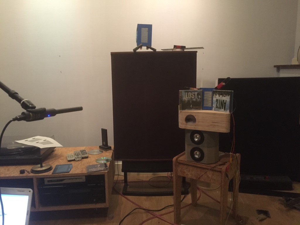

some moving images about what i did last week
https://youtu.be/ASutTwsJRMs

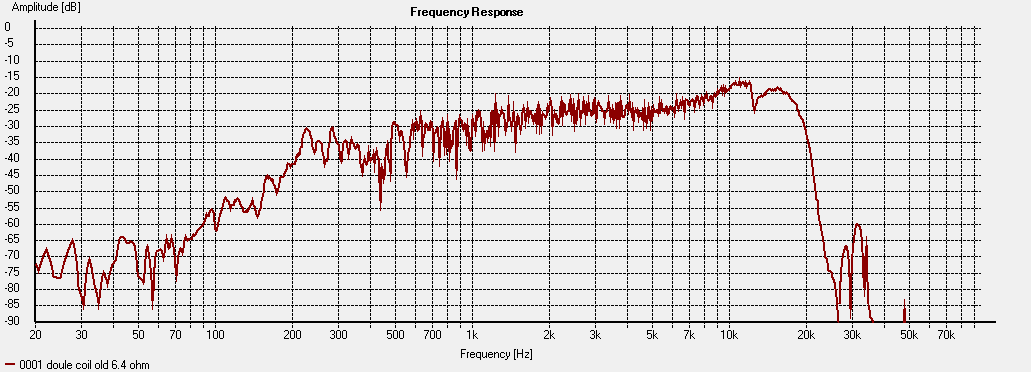

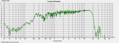

Oh i did another thing, i cleaned the panel from the solid ink and then the huge peak goes up in frequency a bit 500-800 hz, also the lower end distortion goes up a tiny tiny bit like 0.08% or so i just see changes in the distortion graph near the resonance, so i rather let the ink on it for now. first i must try to get the peak further up. i am waiting on the glue to dry on a panel with 1.5mm coil and no alumnium in between, with the neo's i got an peak and a dip when using this sort of layout, lets see if the result are the same. so i know i still have to fill up unused mylar or not

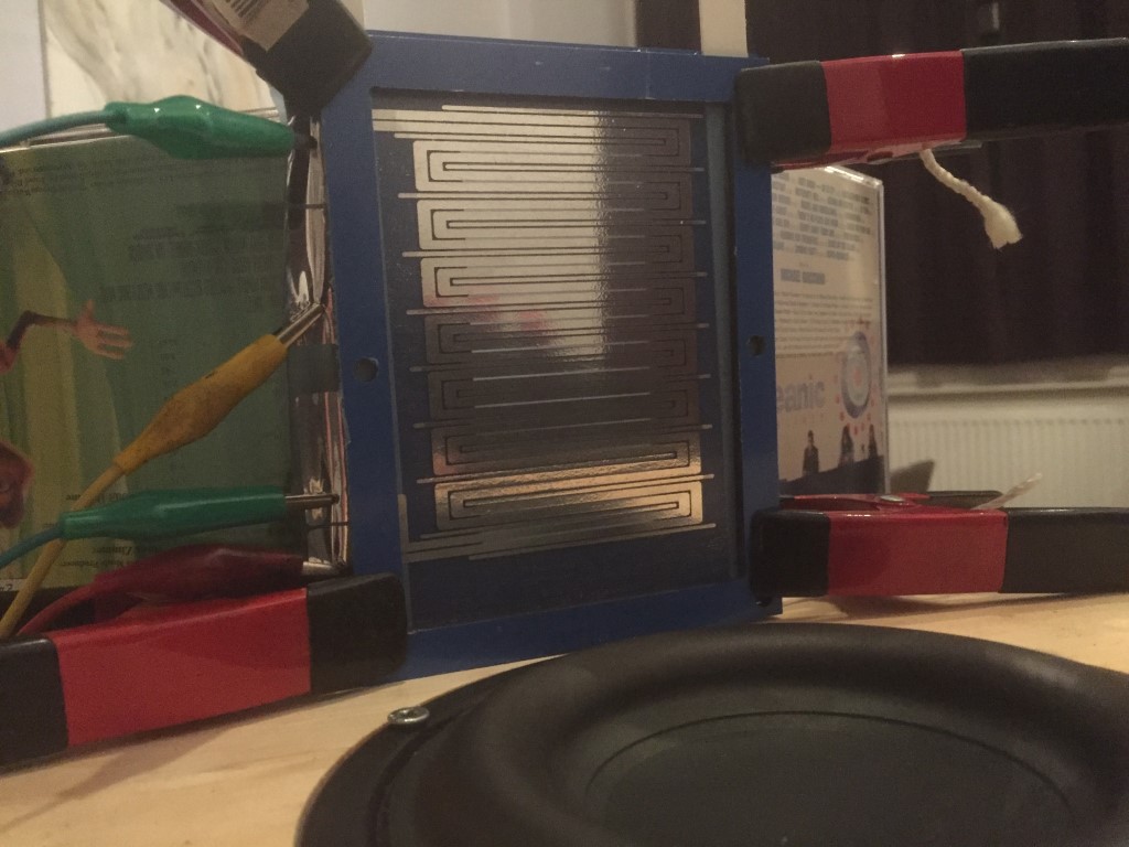

Ok i made one membrane with 12 micron alu instead of the 9 micron, i ordered some samples with my big roll as well of 12 and 25 micron. but the result is the same huge peak at 12khz and then drops at 15, so it has to be something with the structure, and the 12 micron is to heavy for tweeter duty i will try and make a version tomorow or day after with a wider magnet gap. like 1.5mm the field will be lower then it is now, but i would like to see something shift at least
with the neodymium i reached 18khz witch is good enough for me. so i know it should be possible.

I wouldnt dismiss foil heavyer than 12 micron too quickly. Some good tweeters are made with even heavyer foil. Many dont realize that the MRT used in the Apogee Stage and some others use foil closer to 17 microns.
I have built many using much lighter foil with a flatter response out to 20k , they have a certain quality BUT in all honesty my ears seem to like the heavyer foiled ones better IF all is well damped.
AND I dont like flat response at all. It sounds "Hi Fi" a well taylored roll off has always sounded more real to me.
BTW the height / width ratio of those slots, if the width is larger than the height I think you may get a better result. make the ratio as small as possable??

The 12 micron is only the aluminium, the substrate is for both 12 Micron polyester . So it is already on the heavy side.
Slot height is as high as the panel , so can only change width. From 1 mm to 1,5 will be first try. If the width of 1 mm is the reason for the peak, adding as much as 0,5 should change allot.

So i did a test with dumping the metal plate, normally its good to have the magnets sit on metal to close the circuit. but my thought was the magnetic strength is so low the metal could be very thin to have still some benefit. but what happens when we completely remove it ? well i removed it from the front side and measurements are exactly the same. no losses at all. i will do the backside to, and see what happens. at least it looks way way better.
it saves on perf metal to, its not that cheap. and i can make any size i want yeeej, although my blue HPL is getting low must find myself an alternative playing material. thought about a nice black high gloss acrylic front ?
Dumping the second perforated metal piece did not change anything either, if i measure up close the one with HPL instead of metal even has a straighter curve. like flat line (excet for the peak in the 12khz region).. so thats good
here is the video of the first perf plate i replaced. about the distortion, it somehow is there at a certain level. when using 2 panels in series i can match this level without the distortion. so either the panel is at her max, or my amp in 3 ohm its not the DSP and not the laptop
