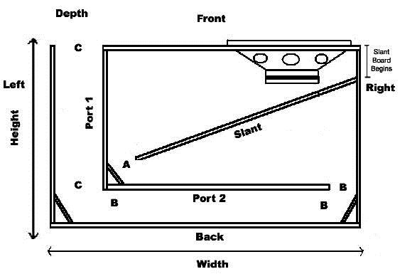

pinkmouse said:What's so impressive? That box is just a non driver optimised mass loaded TL.
Nothing to see here folks, move along now...

DJNUBZ said:Sorry if I didn't make it clear. These enclosures are loud and I do not doubt the videos. Remember though that those videos are made using very powerful amps, high quality subs, and most likely upgrade charging systems.
Most likely, some kind of equalization, like Linkwitz, or equiv. is used in the amp, and very efficient drivers are used to start with. As Linkwitz compensation sacrifices efficiency, even with the labyrinth horns, I doubt efficiency is much more than 90 dB/W/m.
Still, that could give you 120 dBrap with 1000 watts average from the amp.

their "25 cycles" sounds more like mid 30's to me.... but hten agian it was on a camera mic so who the hell knows...
either way 6.5's CANNOT displace the air of 1 even decent 15" driver....
no way no how 2 6.5's in a TL are going to match the SPL of 2 good 15's properly powered...hell, even 2 atlas 15's couldnt be matched by 6.5's....and they are entry level SQ drivers...
it would take
a 6.5 would have to move 5.25 times as much as a 15 to reach equal displacement...on top of the high Fs of most 6.5" drivers....
so that means if a 15 is moving a measly 10mm p2p the 6.5 would have to be movine 52.5mm p2p....that is 26mm one way.... and we all know even poopy pioneer 15's can move 10mm p2p... throw an atlas which can move 36mm p2p at it and it has to move 189mm p2p.... so i geuss we are dealing with 6.5's with parthenons for motors....
it would take
