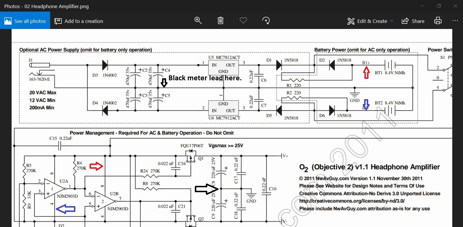

I have built a O2 amp from the diy kit purchased at JDS Labs, and I am facing a few problems. First one being that I didn't pay attention that the power supply needed to be AC and not DC (seriously, who uses AC anymore ? :eek: ), so I have to run it on batteries.
Now I have tried the troubleshooting as described on NwAvGuy's blog and have seen that the voltage on the pins at U4 where in the range of 8V instead of the 11,8 indicated in the testing section.
Anyway, I put the op-amps in and tried the amp (connected to my computer's soundcard) and without the gain the vocals seem to be very "distant". With gain activated it actually doesn't sound bad, but maybe a tiny bit mushy, the sound doesn't seem to be very detailed. I have checked the board extensively a few times, there doesn't seem to be any unwanted solder bridge, the componants seem fine.
Any idea of where that problem could come from ? Thanks a lot :).
[Edit : I've checked again with every op-amp connected, I get a positive (!) reading of 14,9V on pin 4 and 15,5V on pin8 of U4. That seems really weird o_O
Taking the negative side of BT2 as ground, I get ~ +8V at every 4 & 8 pins of the op amps when the amp is not turned on. When it is, I get the following readings :

Put your black meter lead on the common junction of C2/3/4 and 5. That is ground.
Now measure from there to your batteries. You should read + 9 and -9 on the appropriate terminals, and you should also measure zero volts on the remaining 'common' connection between the batteries.
This problem sounds like broken print somewhere. Have the circuit in front of you and then the measurement points will make sense.

I don't get what you mean by "common junction between..." so I took the negative side of one of the condensers (C3 in this case, but same reading with the others), and I got -7.5V on all 4-pins and +8.3V on all 8-pins. I get -7.73 at the negative terminals of the batteries and +8.58 at the positive one. And 0 in the middle ones.

Like this. Black lead to the point shown here, and you should then have +9 on the two red arrow points and -9 on the two blue arrow points.
There should also be zero volts on the ground arrowed at C8 and C9. Measure the voltage to this point by still keeping the black lead on its original location.
I've bypassed the PCB connections that seemed scratched and now the sound seems to be alright, that looks like a victory :D. I'm going to go by a music shop this afternoon to find a 15VAC adapter :).
