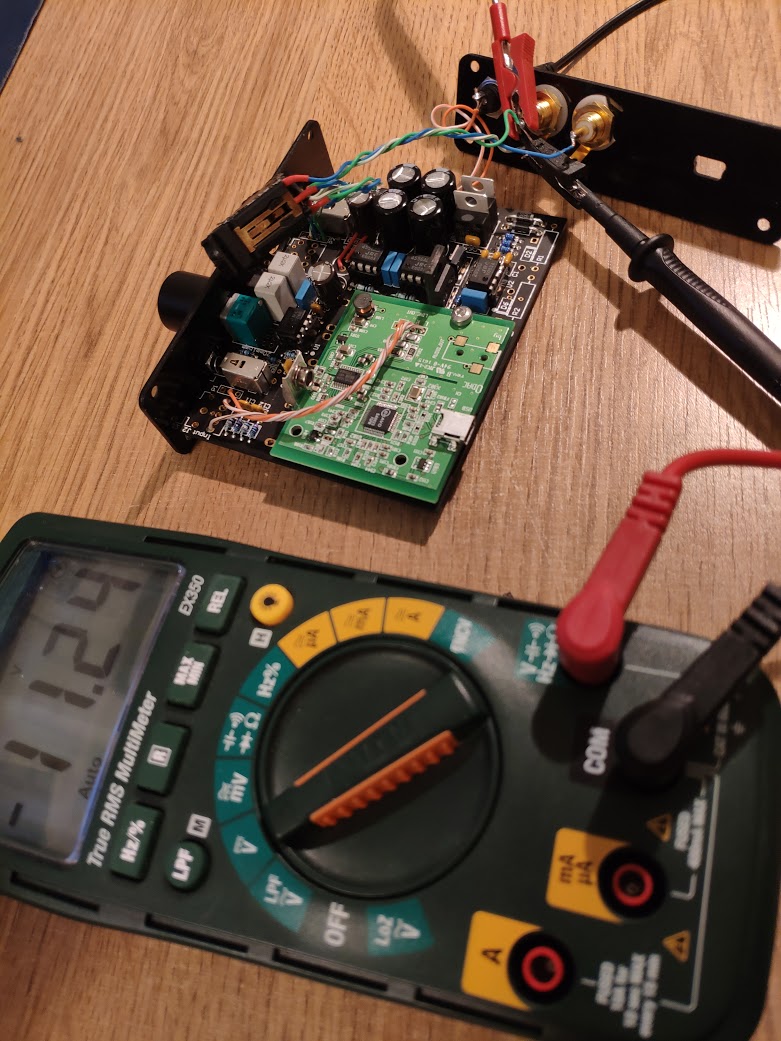

Hello everyone,
I am investigating an issue with JDS Labs OBJECTIVE2+ODAC combo rev-b model. Here is what happens:
  • When I plug in to headphone out, start the O2 and play musing nothing is audiable
  • When I try to move the headphone jack back and forth the music comes up but with very loud pops and crackles, seems like my test headphones are about to blow up
I did go over the steps Mooly described (thank you!) and all passed. The one interesting thing I noticed though is the DC voltage on outputs - see attached photo. Is this normal? What else I should look at any ideas?

I've only ever looked into faultfinding on the O2 headphone amp, not the DAC.
First thing to say is that whether a fault exists or not, physical movement should not cause the symptoms to alter, something you say yours is doing. That needs looking into first. Perhaps the DC offset resolves at the moments you hear the music.
Alternatively you can trouble shoot the DC offset present by beginning with voltage measurements on the parallel opamp output stages. The output stage is AC coupled at its input and so you should only measure supply voltage on pins 4 and 8 of the chips. All other pins should be at zero volts DC.

So I measure parallel opamp 4556 DC voltage on pins 4 and 8 to common ground located at C2-5 and get correct voltage (~11.7V). Then I checked the voltage same way on other pins and also get +/- ~10-12V. Do I have to measure differently or something is wrong?
That doesn't sound right. You should have +11 V and -11 V on pins 8 and 4 (respectively), and all the other pins should be at ~0 V. Maybe compare to NJM2068, which has the same pinout.
Somehow I suspect one of your supply voltages is missing or at least not making it through. Check at the regulators, series diodes, NJM2068 4/8 and NJM4556A 4/8. It has got to get lost somewhere. Check continuity between known good and bad spots.

I did same test on NJM2068 4/8 reads fine at ~11V, other pins are 0V. NJM4556A as mentioned before - most of the pins show +/- 11.7V.
I also did go through the raw DC voltages test mentioned in nwavguy guide here
All voltages are as described except the P2 where I measure ~11V :confused:
You mention continuity tests - what exactly should I check?

Sure thing, I can measure what you need to get things sorted out. Below all measurements of DC voltage:
U3 4556
Pin1=-11.22
Pin2=-11.22
Pin3=-10.55
Pin4=-11.74
Pin5=-10.55
Pin6=-11.22
Pin7=-11.22
Pin8=11.71
U4 4556
Pin1=-11.47
Pin2=-11.47
Pin3=-10.87
Pin4=-11.74
Pin5=-10.87
Pin6=-11.47
Pin7=-11.47
Pin8=11.71
Administrator
Joined 2007
The stand out error has to be pin 5 and 3. That should be ground referenced via R12/13.
Check the voltage on each side of those resistors. One side must be grounded as shown on the circuit diagram. If you have this negative 10 to 11 volts on both sides then there has to be a break in the ground print to that area of the board.
If the above checks out OK then remove the two IC's from their sockets and recheck ALL the pin voltages again. Apart from pins 4 and 8, all have got to be zero.
Hi everybody! We don't know the background on transcendent's exemplar of the O2, but I find it strange that JDS could be selling O2s with this kind of fault?..
I'm sure this is an exception, but I've already read from reviewers checking the inside of JDS assembled O2s that the soldering job isn't always first class...
One side 0, other ~ -11 volts for both resistors.
All pins except 4 and 8 are 0 volts after I removed the IC's.
