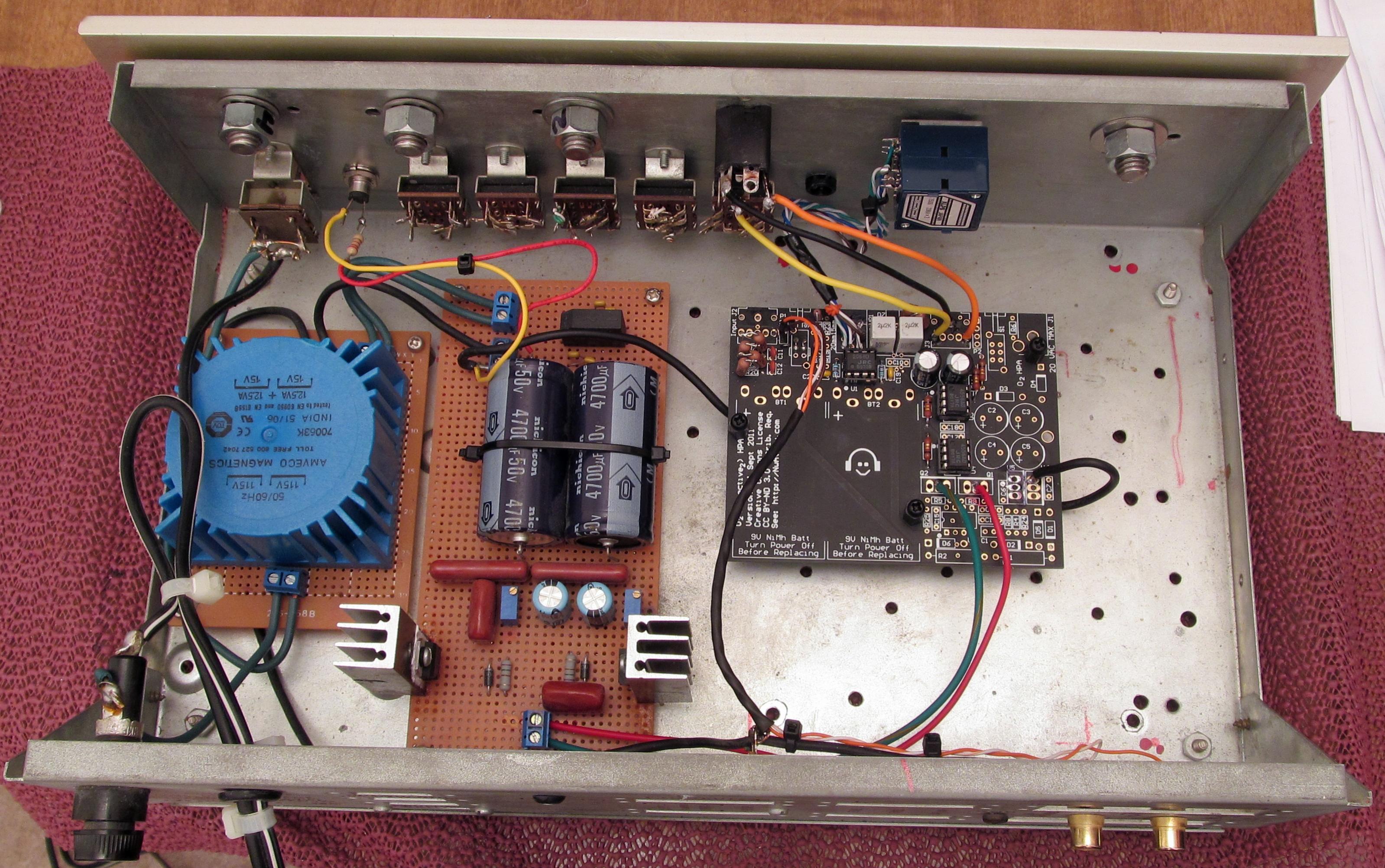

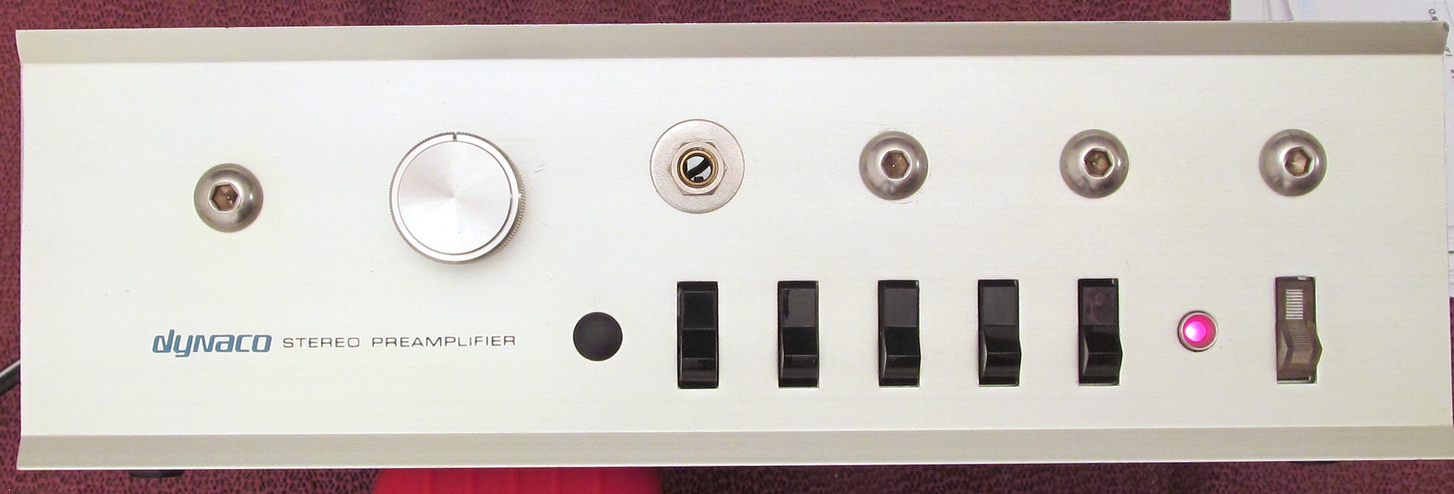

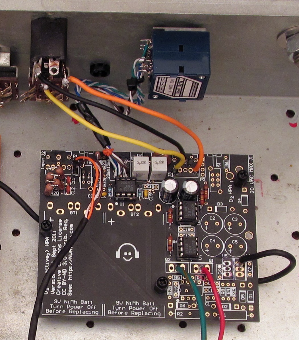

Old Dynaco / AMB Upgrade to an O2 HP Amp.
This is my 2nd O2 build, minimally utilizing just the audio portion on the board. Originally, there was an AMB headphone amp. board that was supported by the current regulated linear supply. The shell is from an old Dynaco Pat-4 preamp. The regulated supply is a standard LM317 / LM338 supply heat sinked and set to +/- 12V. The original AMB Beta 18 amp was actually quite good, but after building my 1st O2 I always seemed to prefer the it over the AMB. Purely subjective! I also traded the older Alps pot. (Radio Shack) up to a RK27. The large power supply is a little overkill for this amp. The noise floor is absolutely dead quiet. The sound is neutral and effortless with my Senn. HD580 and HD650. The RK27 pot measures and tracks well.
The turn on thump is extremely low. and verified on my scope. Much lower than NWAVGUY's shown in his measurements. The turn off thump (click) does not seem to exist at all. This might be due to the large storage of the supply and lack of bleeder resistors. The gain is set to 2.5x (1K) which is more than adequate for my needs. I use an Odac with this amp. I enjoy updating old audio with new modern electronics. I'm currently building an ESP P101 amp. around a 1980's Tandberg 3012 transformer and heat sinks.

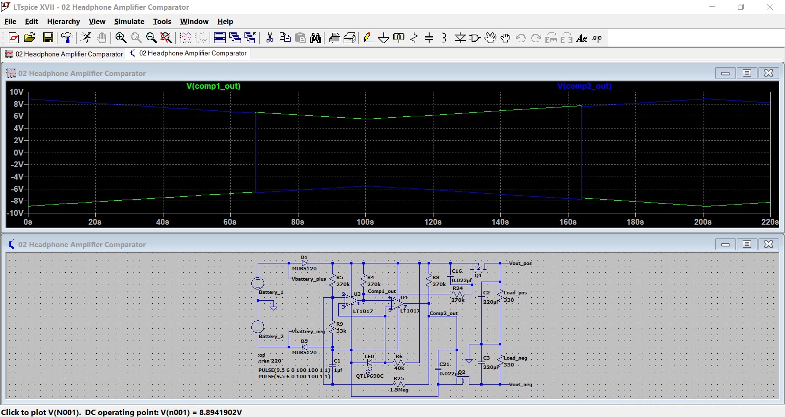

and by the way, could you guys tell me how the NJM2903 work in the power management, I mean to control the FET fqpf10n20c right. but on what condition did they turn on or turn off?
Thx beforehand.
Administrator
Joined 2007
The NJM2068 is an excellent device and I doubt it would be much different in sonics to the LM4562 in this application. The 4562 is also more power hungry which is always important in battery powered equipment.
The first comparator takes an LED as an absolute voltage reference, and by comparing the supply (battery) voltage against this fixed reference allowsthe comparator to flip states when the supply voltage drops below this reference value.
R5 and R9 form a potential divider to 'scale' the supply voltage to a suitable range.
The second comparator is used as invertor to generate effectively generate the two control voltages needed for the FET,s.
When the gate of the upper FET is pulled low the FET turns on and passes the positive supply to the amp. The lower FET needs the gate pulled high to do the same.

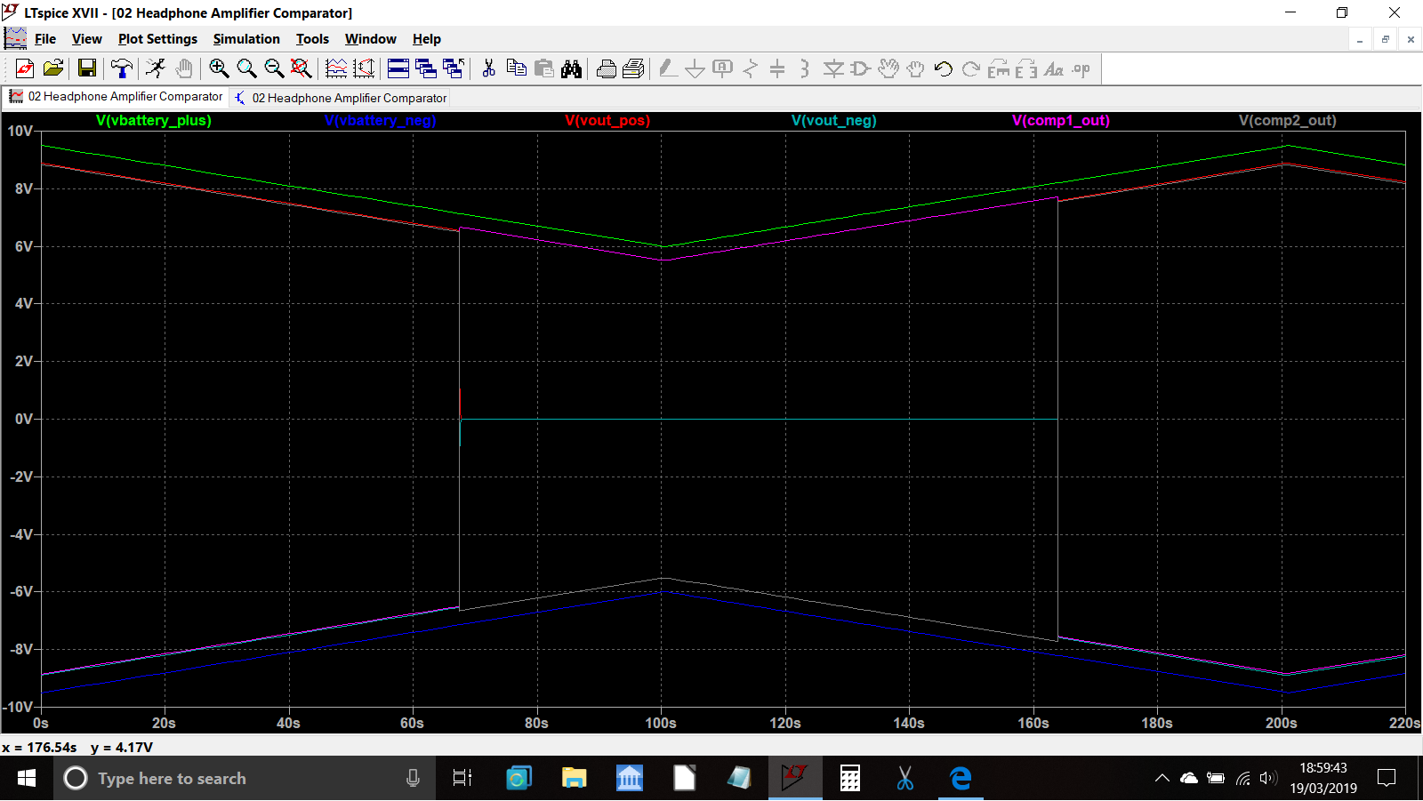

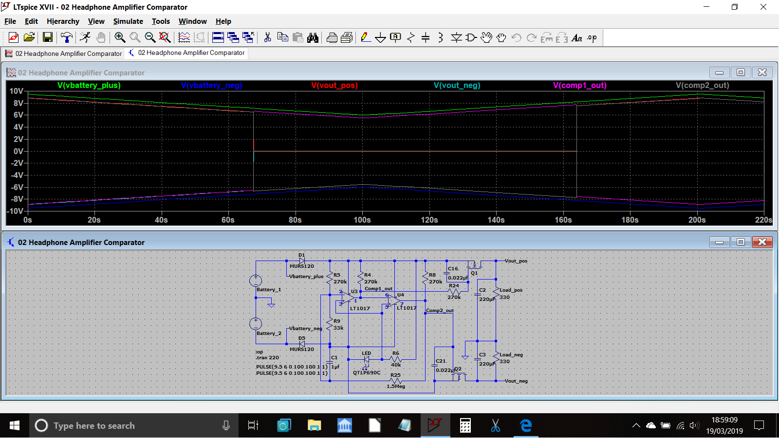

This shows the what happens as battery voltage falls:
OK, thanks for the explanation. But I still wonder why the FET's gate is connected to rail voltage via R4 & R8. Also why we have R25 as global feedback, we use them as comparator right?
Administrator
Joined 2007

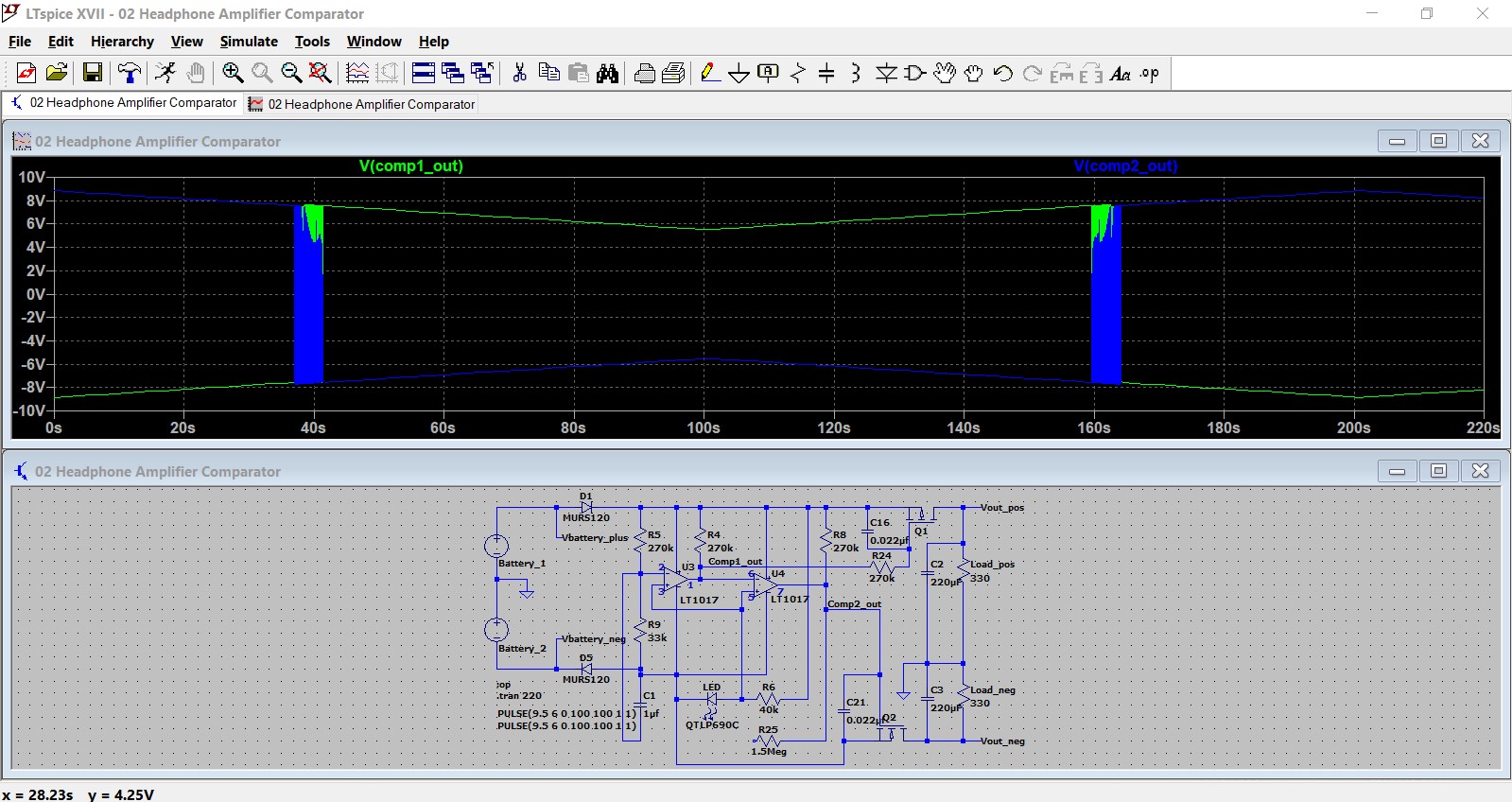

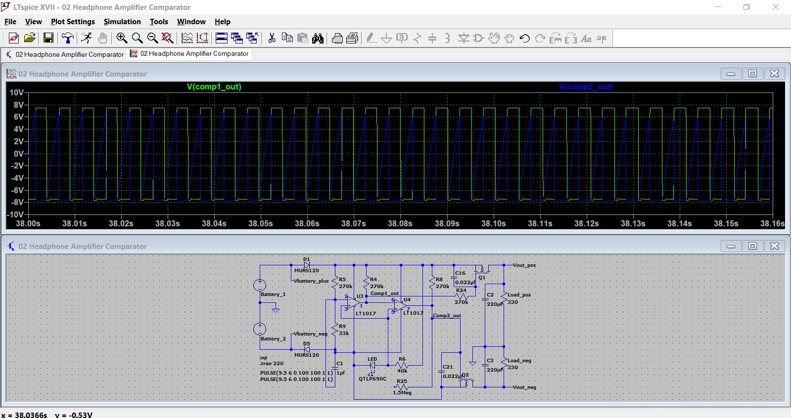

R 4 and R8 are needed because the comparator has an 'open collector' output stage with no active pull-up.
Open collector - Wikipedia
R25 add hysteresis and ensures that the output switches cleanly by slightly modifying the voltage to be sensed. As the threshold point at which the comparator will switch is approached (when the - and + inputs have identical voltages present) the output of the comparator is unstable and is massively sensitive to the slightest variation in input voltage (uV sensitive). This would mean the output passed through an indeterminate point (unstable and oscillating) and so we artificially add a little extra pull or push to the voltage being sensed by means of the high value resistor. As soon as the comparator flips state, the junction of R5/R9 is pulled a bit a lower or a bit higher depending which 'flip' the comparator is doing.
This shows the output of the two comparators in response to falling battery voltage both with and without hysteresis. You can see how noisy the switching has become. Middle image is the noise in detail.
