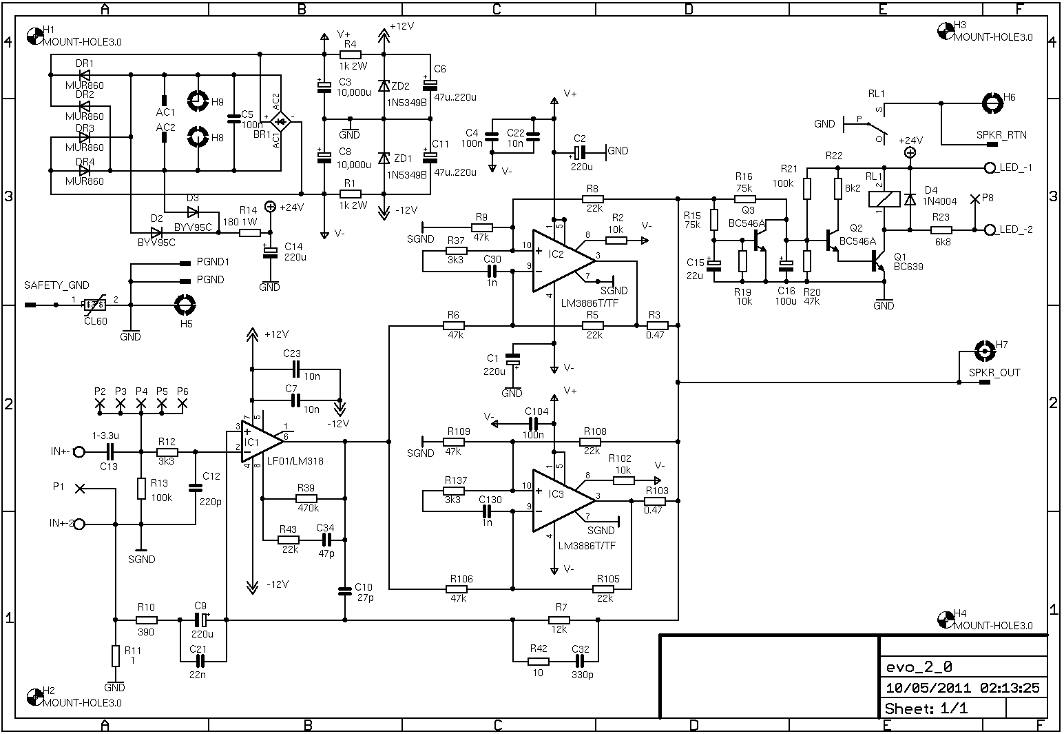

This is a preliminary schematic of a MyRef RevC derivative amp using 2 x LM3886 in parallel for delivering ~80W into 4 ohms. The compensation schema is subject to revision, and is a modified (after simulation) version of Dario's RevO/RevFE compensation.
If implemented, this will be an incremental evolution of the stock RevC board, and will be DIY-friendly. I will continue to use a socketed DIP-8 LM318, through-hole parts, etc. SMD parts, if any, will be limited to a plug-in module like the LF01 hybrid opamp. The board will be slightly bigger than the current RevC V1.4 boards (say ~1.25x the current board area).
The name of this project will either be MyRef Rev E or the MyRef Evo2, subject to approval from Mauro Penasa.
