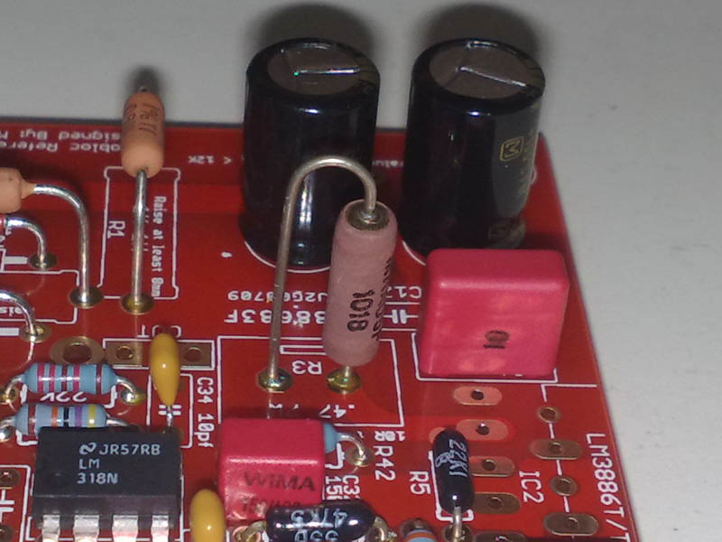

also Dario, was the mills resistor you tried out for r3 a 5w ceramics? installing them in mine has indeed made the sound sweeter but tone is now also a tad bit sharper. still waiting on caddocks...
No, it was not ceramic... see the attached picture
