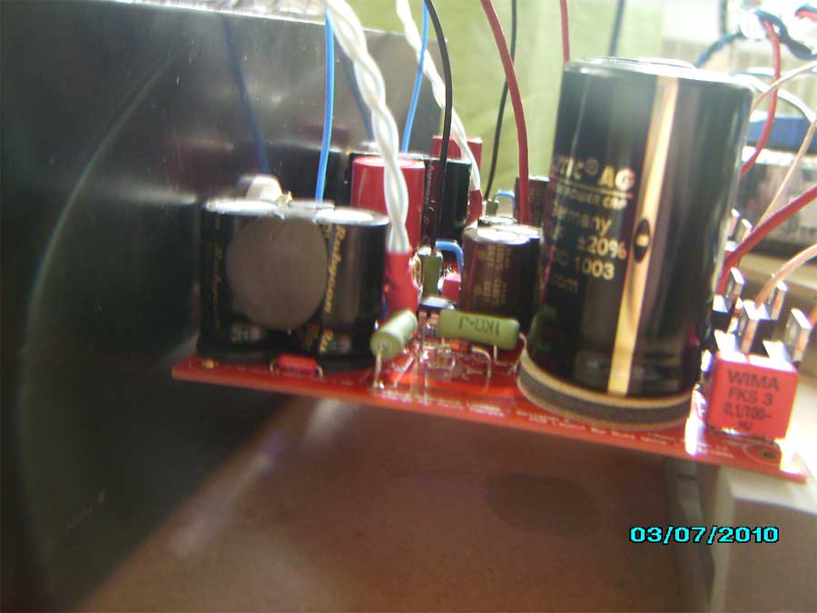

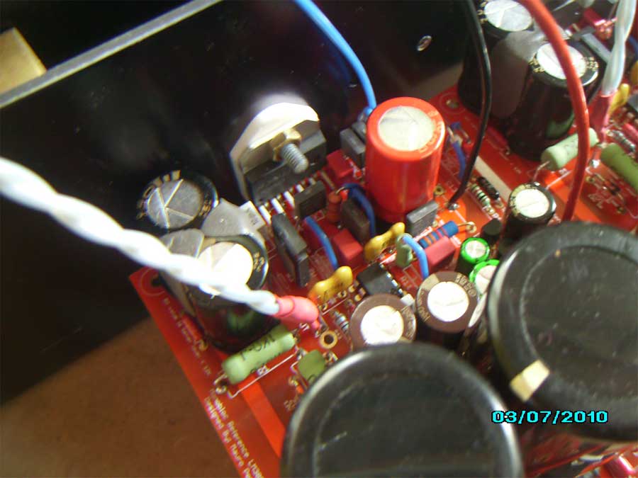

In atthached some poor imagines of my MyRef,w/o case...
Sorry for my poor english
Marco
