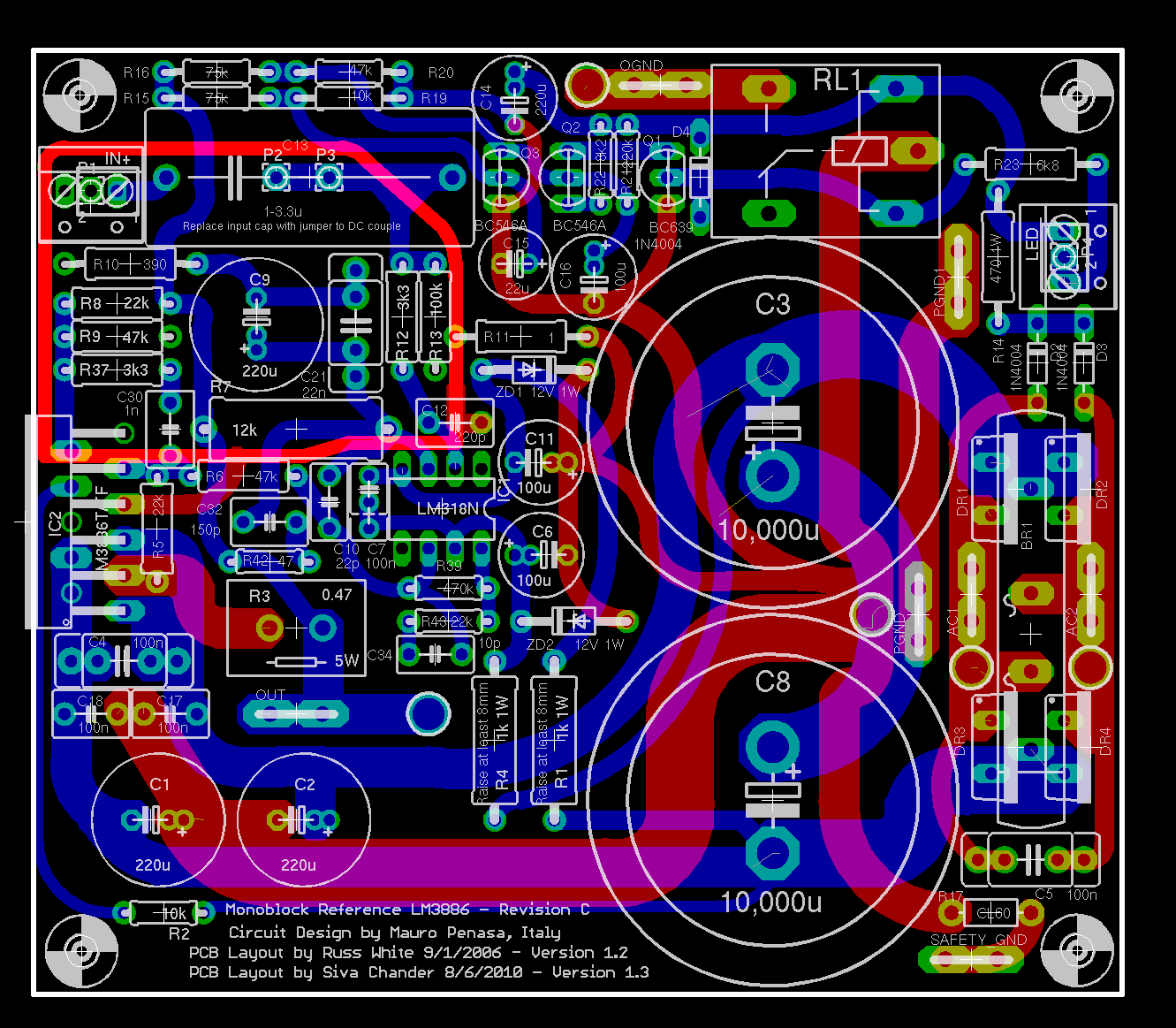

OK, here's the current version of the 1.3 layout, which is the release candidate #1 (rc1). If there's no show-stopping problem that's found over the next 48 hours, I will post the schematic and board files here, and also extract the Gerber and Excellon files for sending over to the local PCB fabrication outfit. I haven't yet decided on the number of PCBs for the first run, but it may be a small batch (< 50 boards).
Edit: The ground net is not fully routed near the PGND PTH - 2 small unrouted airwires are still visible. I'm leaving it as it is, and don't anticipate any problems.

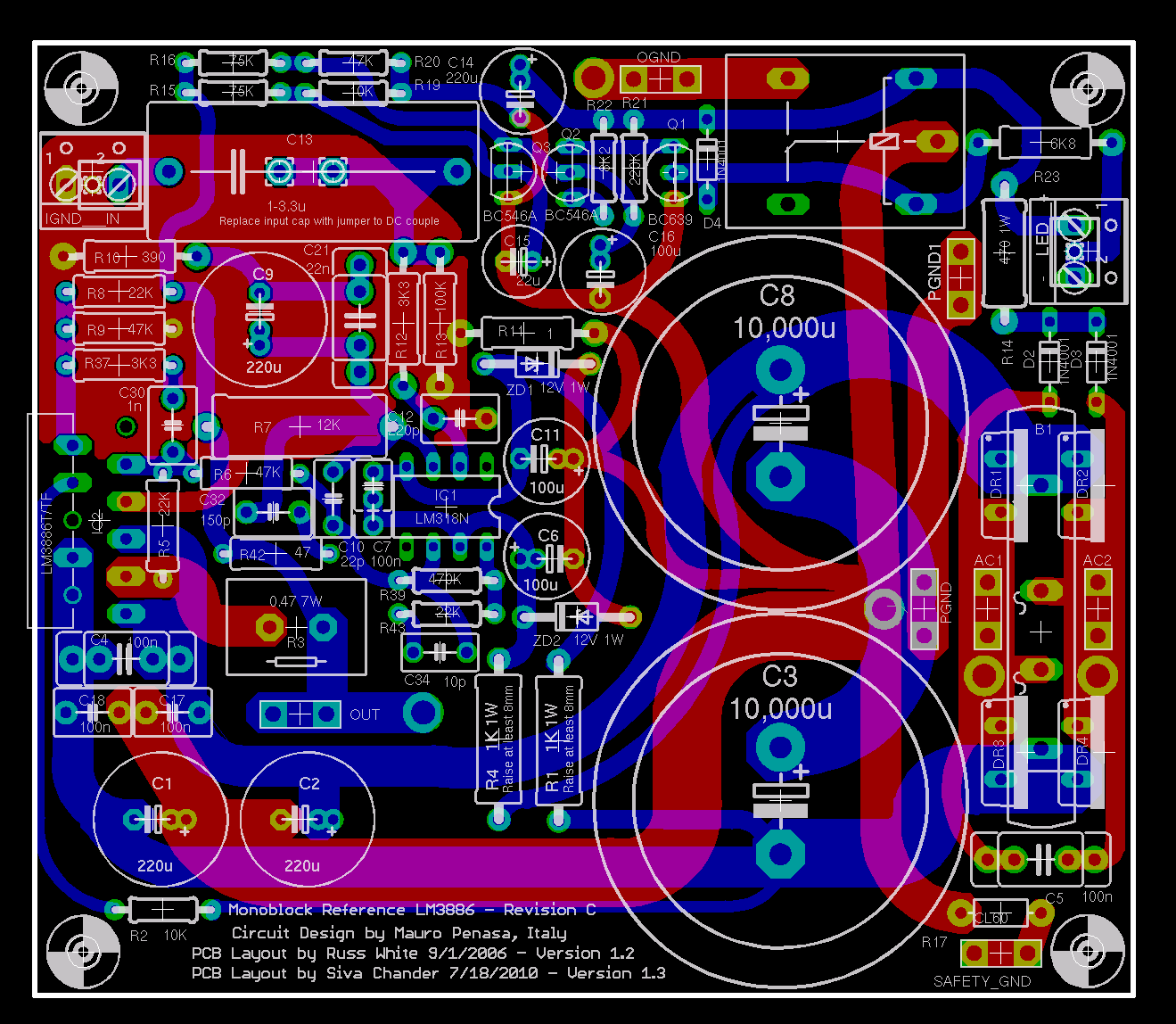

I am down with a unknown flu/cough, which has shot the schedule off the wall. Anyway, I was able to use some of the time to do some fine-tuning of the layout as well as drill optimization (now down to 5 drill diameters only). Here's the current version 1.3 layout - which is Release Candidate 2. Some changes suggested by Quadtech haven't made it into this layout - I'll merge them in later.

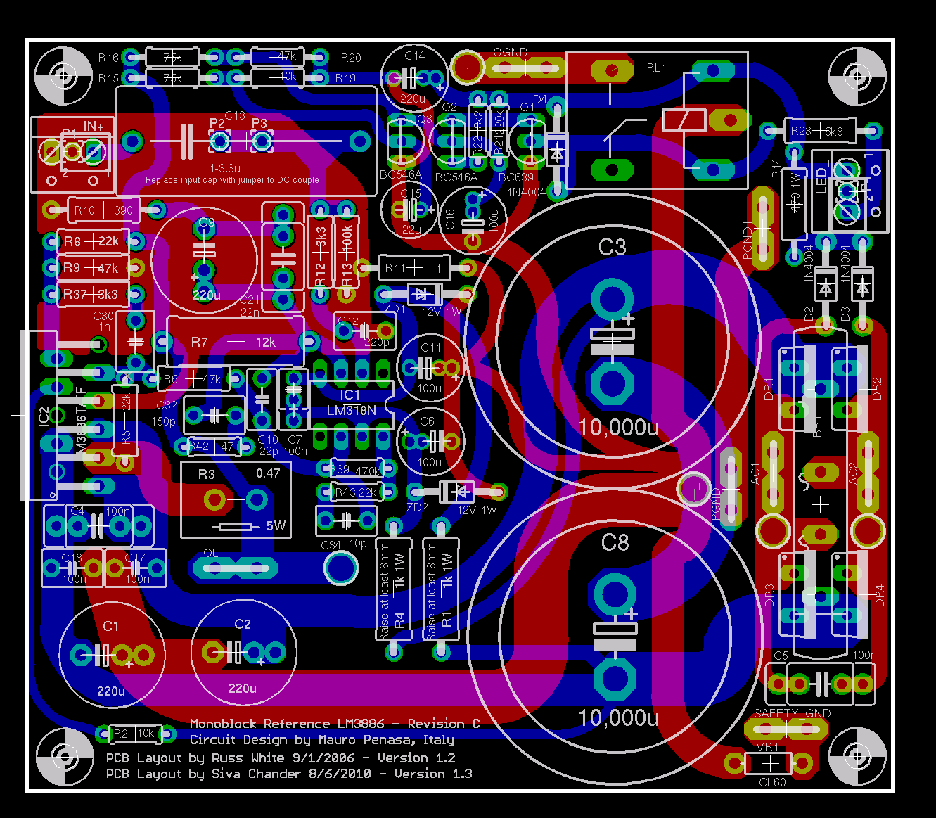

OK, I'm done with the optimizations - this is the final Version 1.3 release. The changes from 1.3rc2 are as follows:
1. C1, C2 and C9 now have dual 5mm/7.5mm pitch - which is more useful than 3.5mm/5mm.
2. Orientation of C3 is now correct (it was accidentally flipped earlier).
3. The 1N4004s now have a 10mm pitch vs. 7.5mm earlier (should be easier to fit some brands with the longer plastic package).
4. The CL60 has now been brought outboard, while the safety_gnd connector has been moved inboard - should help reduce stress on the PCB.
5. The number of distinct drill diameters is now reduced to 4 (from 5 in 1.3rc2).
6. Some minor placement and track-routing fixes to increase clearances at a few places.
The attached .zip file contains the .brd and .sch files in Eagle V4.16 format. The terms of use are the same as those previously offered by Mauro and Russ - generally unrestricted for further use and modification as long as all the design credits are retained in some form. If anybody becomes a millionaire from this, they are to remember Mauro.

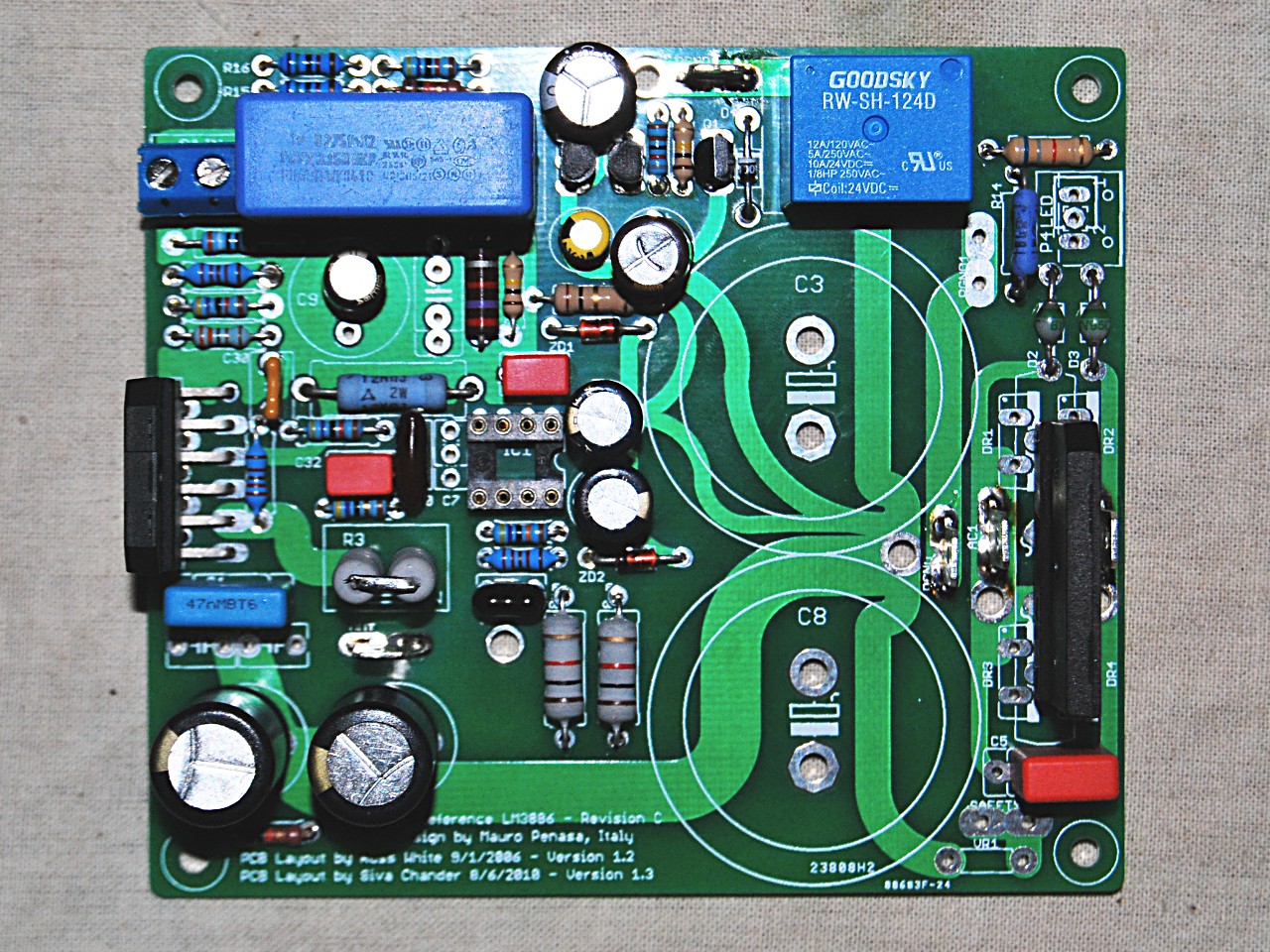

OK, the first Version 1.3 boards have been populated and powered up. No smoke, everything cool or mildly warm to the touch, output offset is 1.6 mV, and it is sonically similar to the Version 1.2 Twisted Pear board with slightly different components.
I went with (Version1.3 prototype vs. Version 1.2 Twisted Pear):
C12: 220pF/630V Wima FKP2 (red) vs. 220pF/100V Wima MKI2 (black)
C10, C34: Silver Mica on both
C7: 10nF/275V X2 Rifa PHE840 (blue) vs. 100nF/63V Wima MKS2XL (red)
R10: 390/0.25W Panasonic ERD2FCG 2% CFR vs. generic 1% metal film
R11: 1/0.5W 5% generic CFR (non-magnetic leads) vs. 1/0.25W 5% generic CFR
C9: 220uF/4V Rubycon Black Gate PK on both.
IC1: Natsemi LM318N PDIP vs. TI LM318J CERDIP
C1, C2: 330uF/50V Panasonic FC vs. 100uF/50V Nichicon MUSE KZ
First audible impressions: Both are very nearly identical - however, there is a slight metallic tinge to the upper mids in the Version 1.3 prototype. I can't blame C7 at this point before giving C9 at least 10 hours to burn-in. After that, I might have to revert to 100nF on C7 - we'll see. I'll also try rolling between the Natsemi and TI LM318.
(Picture below shows a partially-populated Version 1.3 board, minus main filter caps and a few other components).
