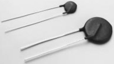

Could you post a picture of the CL60 and/or provide the dimensions and pad size, etc.? Will a vertical resistor decal from Eagle's RCL library suffice? There's space for this near the lower right corner, but if it's too large, I'll probably leave it out in this version.

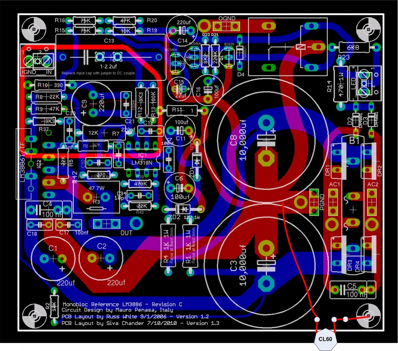

Here's the current state of the layout, still work in progress. Things left to do:
1)The small caps have to be updated for larger circular pads and dual 5mm-7.5 mm decals.
2) Some placement may have to be fine-tuned. C21 placement still not resolved.
3) Some fonts and text placement to be adjusted.
4) Drills for small resistors to be up-sized one step.
5) CL60 decal, placement and routing is tentative - may still be removed if unsatisfactory.
Layout freeze may be pushed back to the weekend, if necessary.

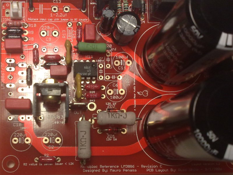

I would suggest to:
  • remove the connection between the mounting hole and safety ground. Your solution is already elegant.:cool:
  • make the connection between PGND and CL60 thicker.
  • Revise the Zeners and associated resistors, the original was way more elegant.
  • In any case remove the ground connection between C6 and C11 and replace it with a connection betweeen C6 and the star ground
  • Space around R3 is still not enough... (see photo)
Nice work so far... :D

I would turn C11 90 degrees counterclockwise, so it will be closer to C7 and the zenner. The other leg of C11 goes to ground, so is not so important to keep it short.
I can see an slim red trace going from R13 resistor's leg to R9's leg, and then it continues. What's that supossed to be?

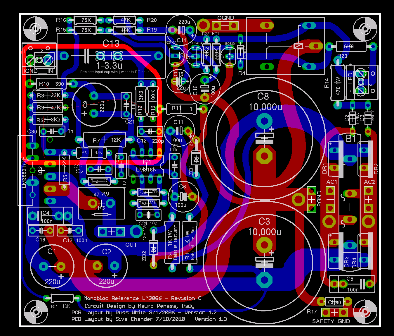

The CL60 does not have to be tied to the standoff if enough holes are provided to program that connection with a jumper wire. Still the connection to the standoff is quite convenient and most builders would probably use it.
Zeners are rather high impedance compared to regulator IC's so I don't expect the placement to be ultra-critical. C11 and C7 appear to be optimally placed and I would not recommend your suggested changes. C7 should be connected with shortest traces to the LM318. Next shortest traces to the LM318 should be C11. Ground and supply traces add equally to degrade the effective impedance of C11 so both must be considered carefully.
The trace from R13 to R9 indicates connections that are part of a copper shape or mini-plane if you prefer. This was part of version 1.2 as well.
It's a zero-width trace to ground, to keep Eagle happy that all signal traces are routed. However, it seems unneccessary - if you hit the 'rat's nest' button, Eagle optimizes these out if they are airwires. I've removed some of those zero-width traces now, will try to remove all extraneous ones (many are buried inside thicker traces) before extracting the Gerbers.
I've now removed the copper trace from the connector (below the CL60) to the standoff/mount hole. It's now an option to the builder whether to jumper it to the standoff or to use a lug-connector or similar, from the safety-ground connector to the chassis, where it may be terminated (star-connected) at a single point.
I'll try to provide an additional pad to make this jumpering easier.
One concern that has occurred to me is that there are now several pads (including the safety-ground connector and one row of the LM3886 chipamp) that are very close to the edge of the PCB, and may cause the PCB to fracture near the edge if unduly stressed.
Here is the current layout - not many visible updates today. I've made C4, C5 and C21 into multi-pitch 5, 7.5 or 10 mm outlines. Next on the agenda is to make C7 (and maybe a few others) a 2.5/5/7.5 mm multi-pitch outline. Then some minor clean-up near C6/C11 and the zeners. Some drill and pad size fixes, and it should be good to go - maybe by the end of the week.
The R3 heatsink issue is messy - maybe the best option is to use a high-mounted heatsink without the lower fins, which should allow it to comfortably clear the components around it.
