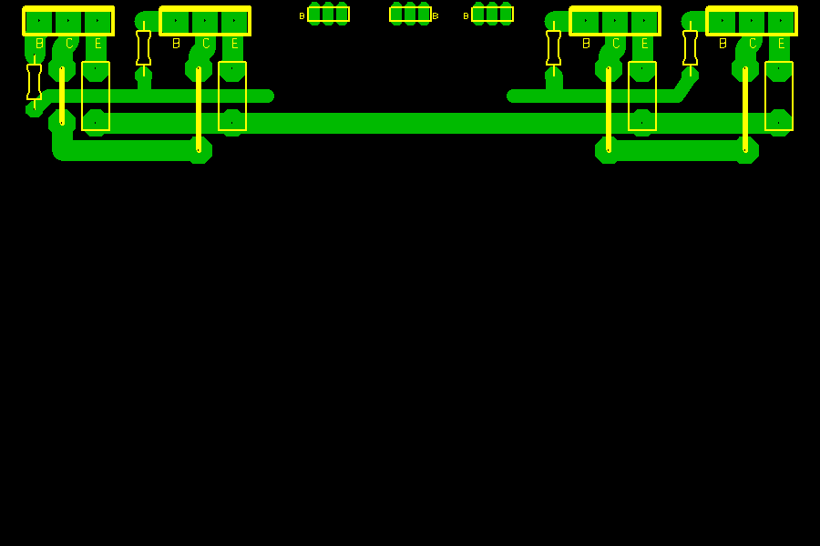

(below 1 is my initial work).The layout of the power and ground routes is the most important , I am using 10mm .22R/5w emitter resistors (below 2). Sprint layout works VERY good on Win7 !!

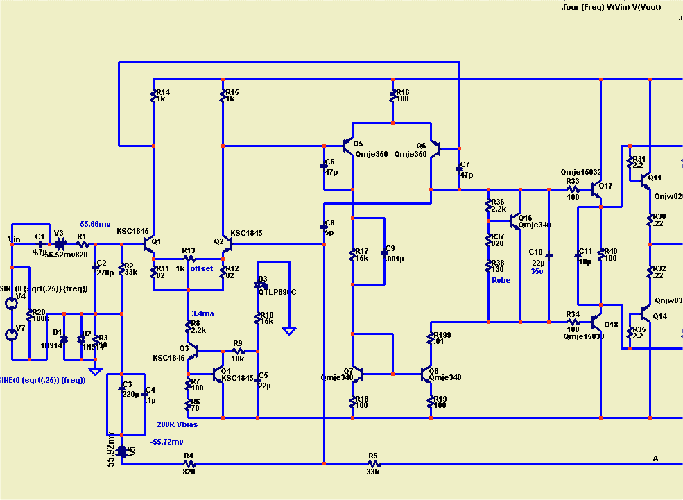

Sorry for confusion , it is the EX. A VERY simple symasym/goldmund type design. I am still using/testing it. (Below 1) What is so crazy about this design , it sounds better with the "ancient" MJE340/350 . I will add into the "collection" soon ... it works very good.

I have listened ... for hours (below - ugly CM's) .... can not note any audible changes with the diode/ CM. I did not let any non-objective statements or opinions sway my decision. Same music , 2 pairs voltage stages (w/diode - no diode BX1.3's) , same power supply/output stage and bias. NO change.
Edit: where this "diode trick" DOES seem to have major effects, is in a non-beta enhanced VAS where the CM/LTP sees more load (also according to LT).
OS
Question: Is EX and/or Frugalamp a non-beta enhanced that could benefit from magic diode current mirror? Please pardon that I just don't know what the term "beta enhanced" means. I was just all fascinated because this diode trick could increase the performance of a simplified amplifier, but I don't really know what that means either.
The "magic diode" trick is no more effective than the use of a suitably chosen series resistor between the unloaded side of the LTP and the CM.
In the case of the Silicon Chip ULD2 , that works out to approximately 130 ohms.
This assumes of course, that both halves of the LTP are well matched for both HFE and VBe, and are preferably thermally coupled.
With low rail voltage Class A amplifiers such as the SC 15 and SC 20W,
the dual transistors LS313 and LS352 are ideal for this purpose.
I agree with SandyK. It could be diode, diode + trimpot or trimpot alone
on the unloaded side of the LTP to set their collector voltages as close as possible to 0.0mV.
But I have seen the trick to work only when the VAS is preceded by a buffer stage of some sort.

You are right SandyK, but I should have added cascoded VAS as well. I have tried this and it works great. Try removing the cascode and with a single transistor VAS, I doubt it. In some cases, I have seen the circuit become very unstable or a large DC appears at the output.
