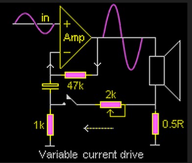

Again, thank you, me personally not interested in power.
Amplifier is a reliable, worked with the test transformer(2x45V 500W) almost all day in full force.
Of course the artificial resistance, several resistors in series.
Since I have Fullrange speakers (sonido) a few watts is a lot for a listening.
Greeting
Hi Nikko!
Series resistors?

Hello Daniel, long time no see.
It seems at first dubious to me to make the amplifier perform the function of the resistor, when a few passive components will produce exactly the same effect easily. That is unless of course, the series resistors were large enough to make the speaker not very sensitive, so that a higher power amplifier were needed. In this case, it is more economical to use current drive, all other things equal. At this point it occurs to me however, that perhaps adapting the amplifier to perform also the function of the resistor would actually eliminate a component from the signal path, if we accept that the amplifier's distortion will be present whether using current or voltage drive (although the distortion mechanisms may change).
Hmm.
- keantoken
Hmm.
- keantoken
