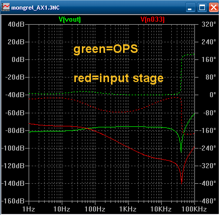

Real life is different , I have used my new CRO probes extensively (just pokin' around) and the actual performance is slightly short of what the simulation predicts. Voltages are right on , currents are right on , but ground and rail ripple are much more dynamic with an actual signal. The single device multiplier with a second order setup is good to about 1V main rail ripple. This can be improved by sacrificing more rail voltage with the multiplier resistive divider. With a darlington multiplier you still have to sacrifice 2-3V , but the ripple drops way below 1mV.
(below) is what the normal 1st order R/C input stage filtering will get you , PSRR wise. No filtering at all plots out 3dB worse. This must be the amp's "natural" PSRR (-80db). I will say it ... this is ALL you will get building most of the amps on this forum. You can go dual mono , but still have each individual channels ripple to contend with...Good old PS IM at 200w+ output. None of this matters much at normal listening levels , as PSRR scales with output.

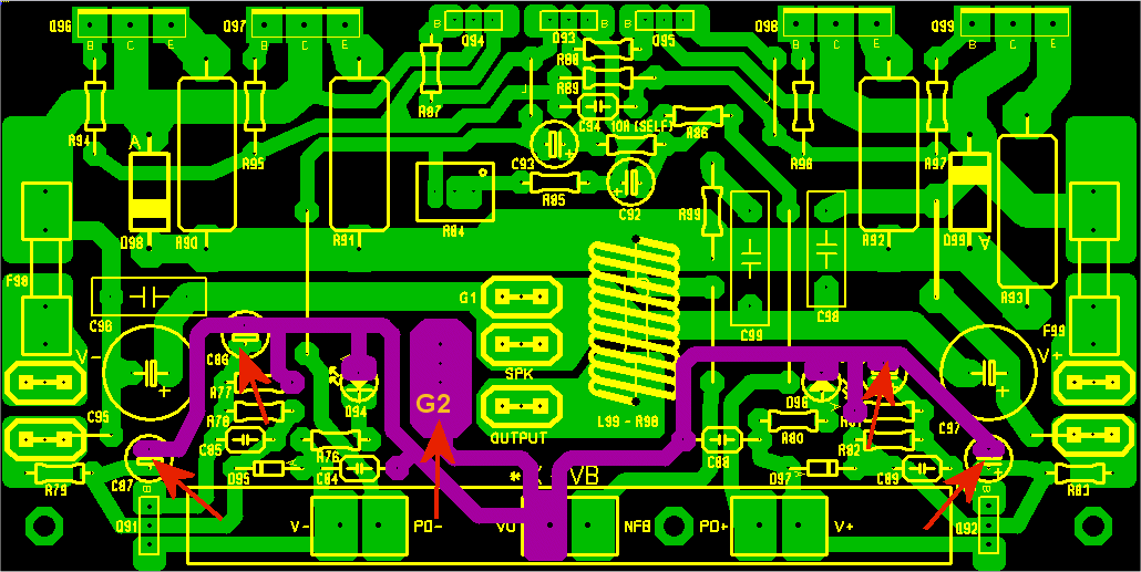

Well, if I look at the layout for PB120N, the ripple/noise current flowing through C91 (100 uF filter cap) flows through the G1 trace that serves as the ground reference for C91 (the "multiplied" cap") and the voltage divider, and then continues some distance to the G2 terminal where it flows through a "long' wire before it gets back to the HQG point. So the ripple current through C91 is contributing to the amplitude of the cap multiplier output. My interpretation of Cordell's description is that C91 should connect not to G1 but to the noisier G2 trace.
I see your point now. In theory you are right, but have the "G's" reversed (Below).. G1 = noisy - zoble / OPS decouplers - G2= clean -VAS/IPS. The initial "dirty rail pulses" from the main PS go through R79/83 to the first decoupling caps (C87/91) , I agree ... with a single supply , these caps should go to G1 (dirty ground). On the real amp (I have 4) , the actual ripple and the ground pulses measured at G2-C87/91 are 1mV or below. Since the voltage stages use only +/- 18-25ma , very minimal switching pulses are present at the first 2 caps (R79-83 are "lift" resistors). So , seeing that I had sub mV ripple at C91 and might have a dual power supply (second set of fastons V+ / V-) ... I chose to make G2 the common star for BOTH sets of caps associated with the multiplier.
The end result of this is that I have my desired .1mV ripple at the 2 Voltage stage rails (at a -2V penalty) and scoping G2 , the ripple is nearly immeasurable at full output of the amp. I have a "non-multipliered" CDRC (cap/ diode/ resistor/cap) power board (the PB60X2) , this is my 60W test amp and pretty much the standard fare here at DIYA. It has the standard single ground star configuration. I can see .1-.25 VOLTS !!! on the voltage stage rails and the ground ripple is measurable. For the PB120/250 , I had to come to a minor compromise which did not degrade performance but allowed for the optional second voltage amp power supply option. I DID think this out (reckoned it ) in every way before I finalized the design. The only benefit to the G1/G2 setup is with a "split" power supply board (PS100) ... 2 banks of capacitors with the appropriate "lift resistor" between banks. The voltage boards also have a "lift" resistor/double diode (D1-2/R3) for the CCS/ input stage.

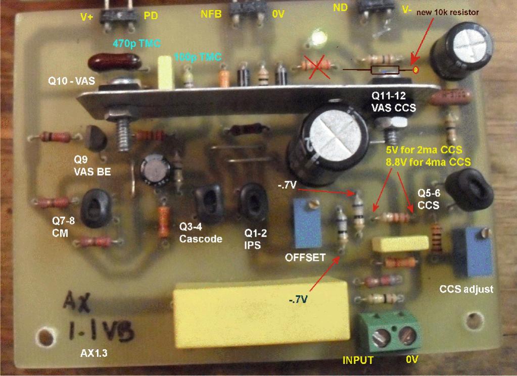

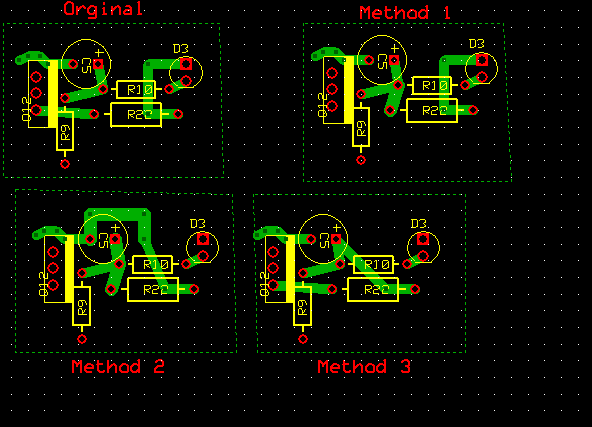

R22 is now changed to 10k. But im really not sure how to tie it to C5..
Could you take a look at the attached picture and tell me wich method is correct?

330p will just raise the input HP filter a little , 470p will lower it. Neither will be anywhere close to the audio band. As far as the 10k resistor ... look below (pix) , drill 1 hole .. all done !
