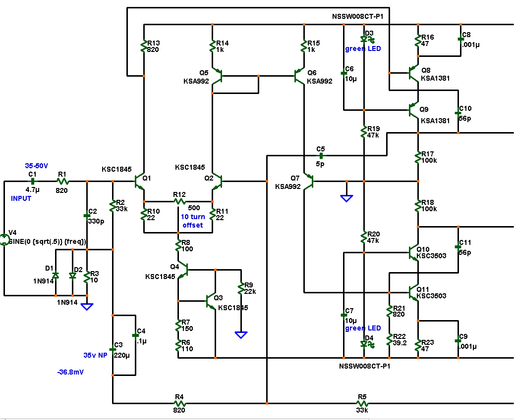

Okay, replace C6 with 5pF instead of 22p, and C7 with 680pF. Then make sure the line reads ".param dlycyc=1", I turned this off to find the oscillation. C7 prevents the CCS from oscillating.
Now THD reads less, at .0005%. I forgot I made those changes.
I would comment more, but don't have time at the moment.
- keantoken
I was never able to honestly compare, here is a file for full simulation of both versions. I was in a hurry before. Yes, there is barely a difference in distortion for this position. I think in the LTP the CCS would work better.
Some say a precisely matched LTP improves sonics audibly, and if this is true I wonder what effect the voodoo CCS will have.
I wasn't able to simulate the CCS for the LTP because the simulator won't converge (not soon at least)... It evidently has problems with this type of CCS. So I don't know how much gain there is by putting it there.

Ah , you got it... keen. 6- 1 millionths of a mA , WOW. Must be voodoo. :D
a ??? :confused: R21,22,20 custom values. Are these needed to make this thing stable ? By that huge 560pF cap at the base of Q13, it appears that there is a stability issue ??? And wahib's fourier shows very little improvement in performance. Hmmmm.
OS
I wouldn't expect it to make any difference in the VAS position, but I would try it on the LTP.
The higher R22 and R21, the better performance, because the feedback loop has more to "kick against". I don't know if the bootstrap is necessary, I'll let you be the judge of that - the rail filtering probably works well enough. I chose the resistors to keep at least 1mA quiescent through Q13 and Q12. R22 current subtracts from output current.

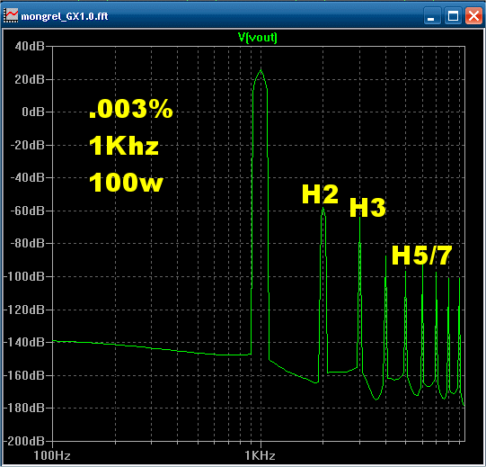

Next on the "chopping block" is a real classic. Called the "APT1" , it was designed in Cambridge ,Mass. by a Tomilson Holman. I had a chance to chat with the designer http://www.diyaudio.com/forums/solid-state/70261-apt-1-power-amp-undeservedly-forgotten-8.html when I was "green" (still am). He said " but I don't think it can be reproduced today since some of transistor types are no longer made."
HA HA , eat your heart out.... (BELOW) I am VERY pleased with this one as it spec'ed out to the original's performance BEFORE the refinements. On "first click"

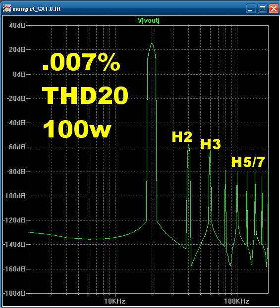

thd was .015% and even dropped to .01% at higher freq's - 20Khz/100w (strange). I then added a cascode under the level shifting current mirror to allow for the use of the KSA992, which is a much better device than the originals or the mpsa92 that I used before to handle the 150v rail to rail voltage requirement.These changes dropped the THD to .003% .. all the way to 10khz... and just slowly increasing to .0075% all the way up to over 30KHZ!
Same story at 200w , it "held" that same .003 to .007% all the way into the ultrasonics while also keeping the same H2 dominant harmonic distortion "signature". H5/7 were real low , as good as the AX (blameless).

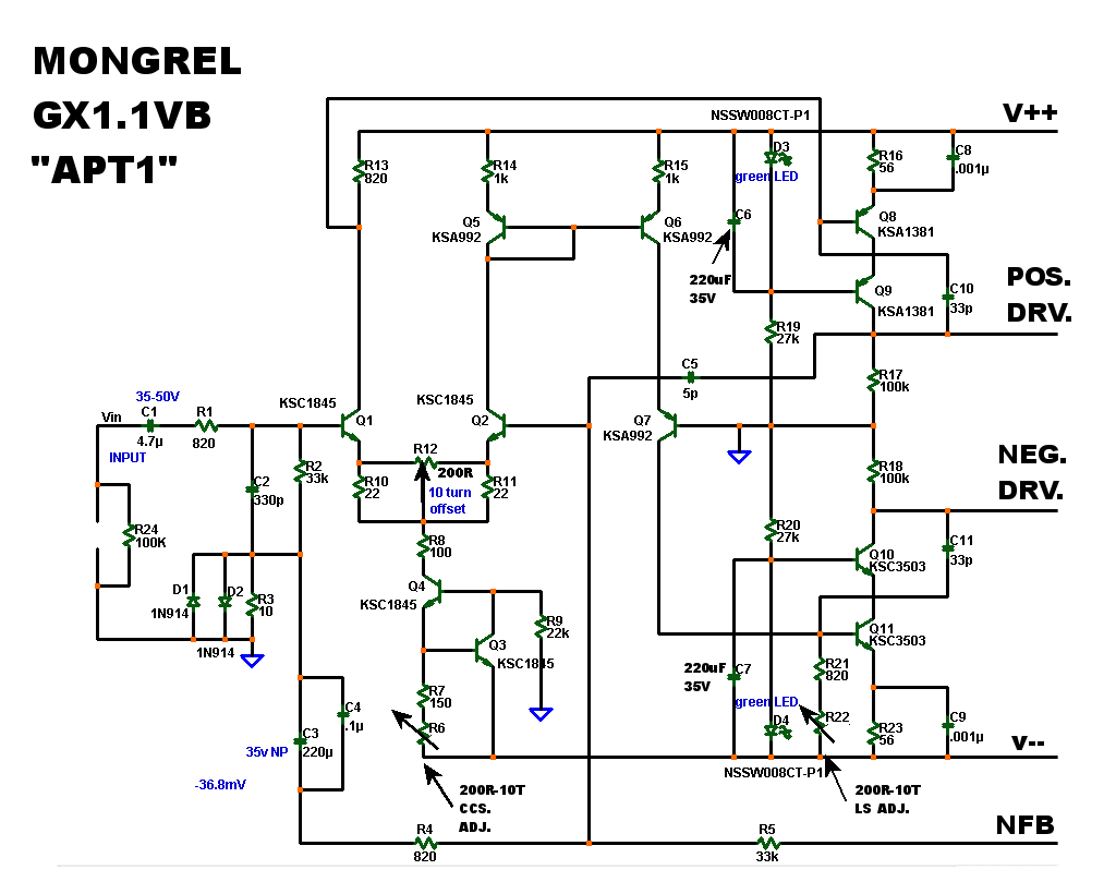

Below is the GX. I am so impressed by it's harmonics that I might build this one for myself FIRST.
Another thing unique to this topology is that it seems to "force" a balance between LTP currents.. (last pix) at all power levels and frequencies, I attribute this to the use of the level shifting CM.

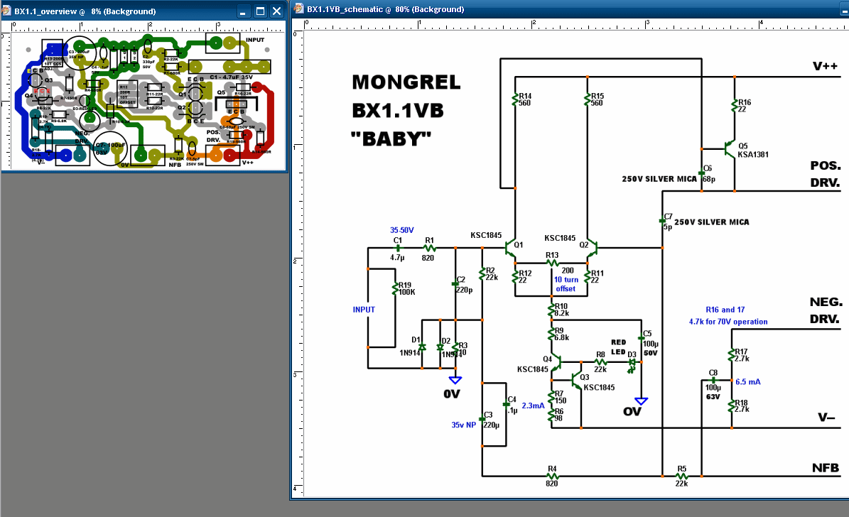

as you can see below , I already do the "guard ring" technique on my VB's(input section). BTW the "APT" GX1.1VB is DONE! Look for the errors.. Ha HA. Compare schema to layout , for this was done mentally , It COULD happen !! :p

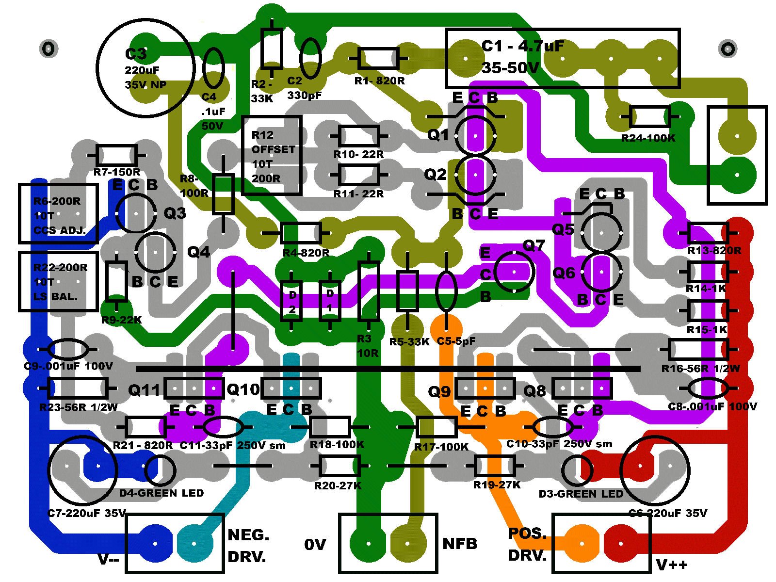

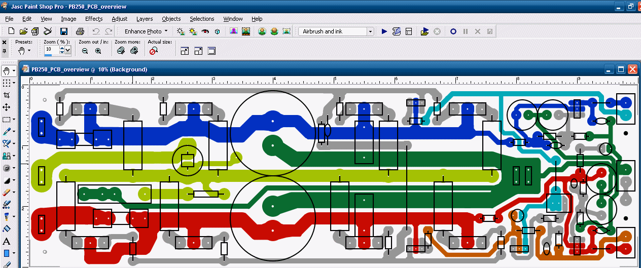

Hi OS
I'm keen to build the PB60 with CX1, and have a few queries.
1) KSC3503 appears to come in different hFE values depending on the suffix letter, for example KSC3503D (hFE:60~120). Could you please confirm which variant to use? (or not matter)
2) I can't source Qnjw0302g/Qnjw0281g, but can source njw0302g/njw0281g. Likewise, I can't source Q2SA1837/Q2SC4793, but can source 2SA1837/2SC4793. Could you please confirm these are the same devices?
3) Could you please explain how to build the 3.3uH inductor (gauge/turns/diameter)?
4) I'm not familiar with getting PCB's professionally printed. Is it sufficient to simply submit your PCB jpeg and parts mirror jpeg?
I take it that the parts mirror is intended to be top-side?
and is it normal to submit the screen-print in a mirrored format?
5) I take it that the output and driver transistors protrude out beyond the PCB for mounting onto the heatsink (as per photo examples of your previous builds), but this creates a form-factor issue for people like me retro-fitting this into slimline cases/heatsinks (which I imagine would be typical for the PB60). My case is 80mm high with 75mm high heatsink, and your PCB is 76mm plus the height of the transistors, so it doesn't fit. I have a work-around but is a bit messy. Your original powerboard prototype would have been perfect. Anyway just a bit of "food for thought".
Thanks for your assistance, and I really appreciate you making this public domain for DIY'ers like me!
Craig

1 - ksc3503/ksa1381 Hfe... classification E or F will be sufficient. I use the "E"
2 - The "Q" is a remnant from my simulator (I will correct that on schema) ,your assumptions are correct.
3 - Inductor - use 1/2" dowel or pencil , wrap 18 ga. magnet wire 15 turns one layer or 8 turns 2 layers. Mount 3W resistor (R98) on board first , then bend the wire on the outside of your new inductor into the inside of the 1/2' circle. Inductor mounts vertical on PB60 V1.1.
4 - About the PCB's , print them out on (staple's) photo paper , iron them on to your pcb material at high heat , soak in warm water , etch in peroxide/HCL (muriatic acid). they look as good as what a pro will do. I have never not made my own stuff , so I can't tell you. Mirrored image is top screen print.
5 - If you could hold on a few days I will make a PB60 "low profile" , I made these (PB60-250) for the standard 125mm (5") aftermarket heatsinks.
As far as boards ... I am going crazy with "Updates" 1/3 of amp performance is layout. The PCB/schema programs do not have all the "tricks" integrated into them.
The PB250 (Below- 1) - TONIGHT ..I will have an advanced version with Dr. jagodic's Cap multiplier , larger voltage board caps, LED'S :xmastree::xmastree: better star grounding , AND the proper implementation of Doug self's magic Vbe resistor. NFB return will go shielded direct from inductor to euroblock.
PB60 - I did not change that. ALL is good.!!
NEW!! :eek: :magnify: BX1.1 (below-2) the "BaBy" smooth sounding classic RCA bootstrapped. amp.. :eek::magnify:
TO DO ... I will make the low profile board (will be the PB60LP) couple days.
