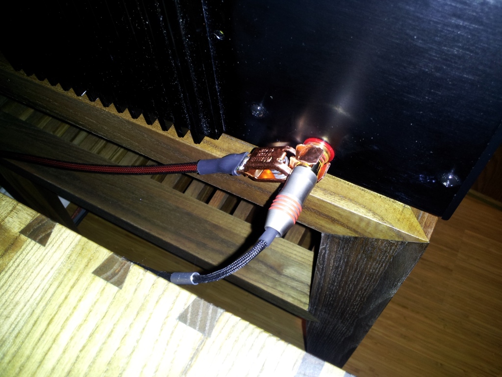

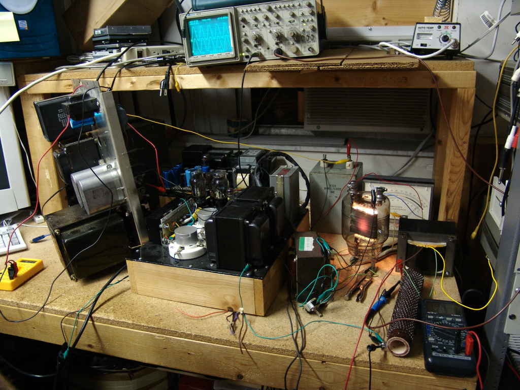

Because of the 4 power transformers and six chokes in each monoblock, I generate some substantial chassis voltage mismatch between the amps and the other components, which had left a stubborn little bit of ground loop hum between the components up to now. Well, I have finally gotten the hum/buzz in the amp down to zero. I mean ZERO, with my head right up to the speaker drivers. An almost inaudible thermal hiss is all that remains. Yay!
The final touch was the addition of a Parallel Earthing Conductor (PEC), from the input RCA jack of each amp to the chassis of the preceding component (in my case the shell of its power umbilical). Picture 1 shows one of the PECs, made from 9.5 gauge copper Litz wire. I used these neat copper spring clips on the end which are PERFECT for clipping onto the shell of RCA and umbilical connectors - they are actually made for connecting geophones for seismic monitors up to their associated electronics, and are available from Digikey for $1.48 each! They have a vice-like grip! Picture 2 shows one installed on the shell of the RCA connector.
I picked up this trick from reading about pro-sound installations, which often use a very heavy gauge PEC running alongside the interconnects to handle the interchassis currents from their massively powered gear. They can have enough current running to actually fry the shield wires of their interconnects without a PEC!
Before the addition of the PEC, there was a low-level hum/buzz that was audible with my ear within 6"-12" of the speaker driver. Now it's dead silent. No negative effects that I can hear, either.
Just thought I'd pass it on, it's a nice tweak to get that last little bit of ground loop hum out of the system, without lifting any ground pins or using any loop breaker circuits.

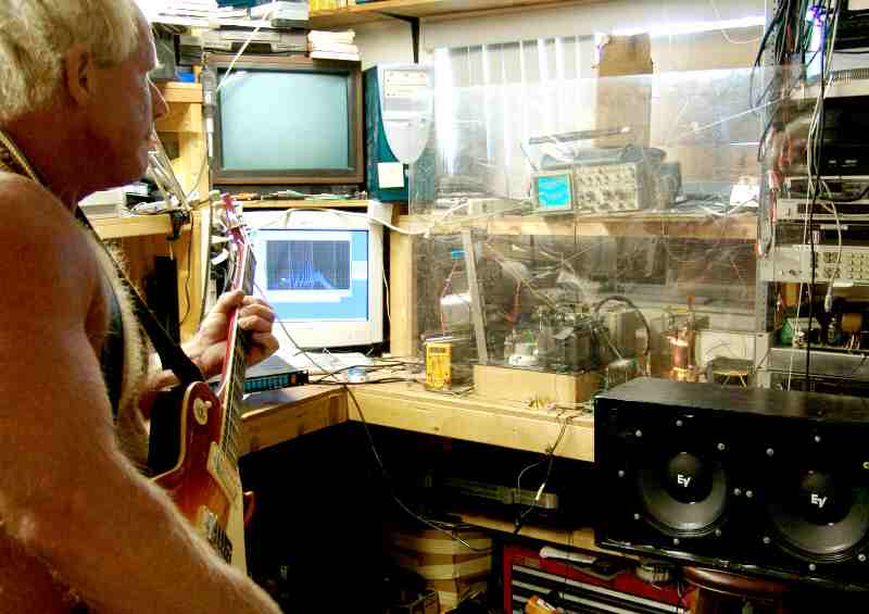

Note the current meter behind the tube. It is measuring plate current (about 270 mA). It does not move until the amp is driven into severe clipping by a blonde with an electric guitar cranked to 11. At this point the amp is nowhere near class A!

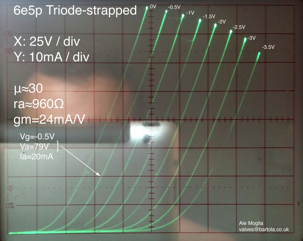

You don't interpret I-V curve linearity from the tangents to each curve. Below is a set of plate curves for the 6E5P in triode mode (my driver tube). I stole this from Ale Moglia's website, BTW, so that's not me reflected in the CRT! Each curved line represents the I-V at a particular grid voltage (noted at the top of each curve). As the grid swings with the signal, it would go left to right across the plate curves, intersecting them. The more evenly spaced the plate curves are from each other, the more linear the device is. A triode is extremely linear and as such can often be run without negative feedback (except for that inherent in the triode itself).
Unfortunately, I have not found such curves for the 833C output tube, as it's usually biased into A2 territory (drawing grid current) for it's day job as an AM transmitter tube. I'm running it biased into class A1 for the first 40W or so.

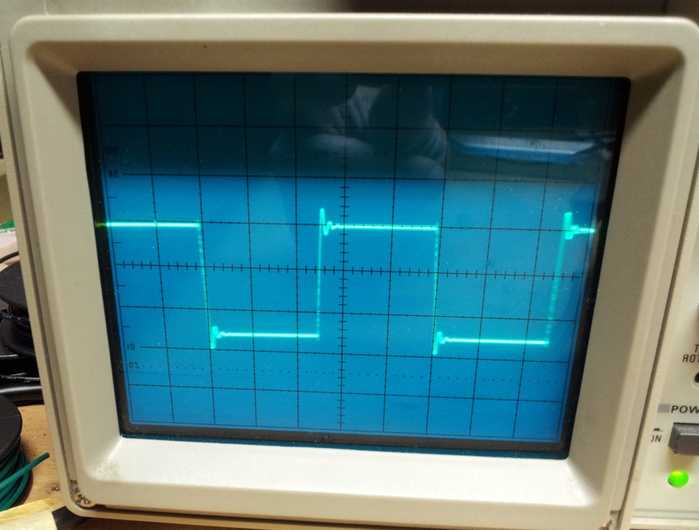

As a measure of frequency response, the 2kHz square wave is often used. Here's mine (also posted earlier in this thread) with a 4R dummy load in place. Nice flat tops and steep sides for a monster OPT. A little bit of overshoot in the front but ringing is well controlled. Considering the amount of parasitics in this 62lb beast, that's pretty damn good!
Sound-wise, there no annoying or fatiguing sound in the highs to indicate that the overshoot is anything serious, so I'm leaving it as is. Once it's hooked up to a real speaker, that will change pretty drastically, anyway...
