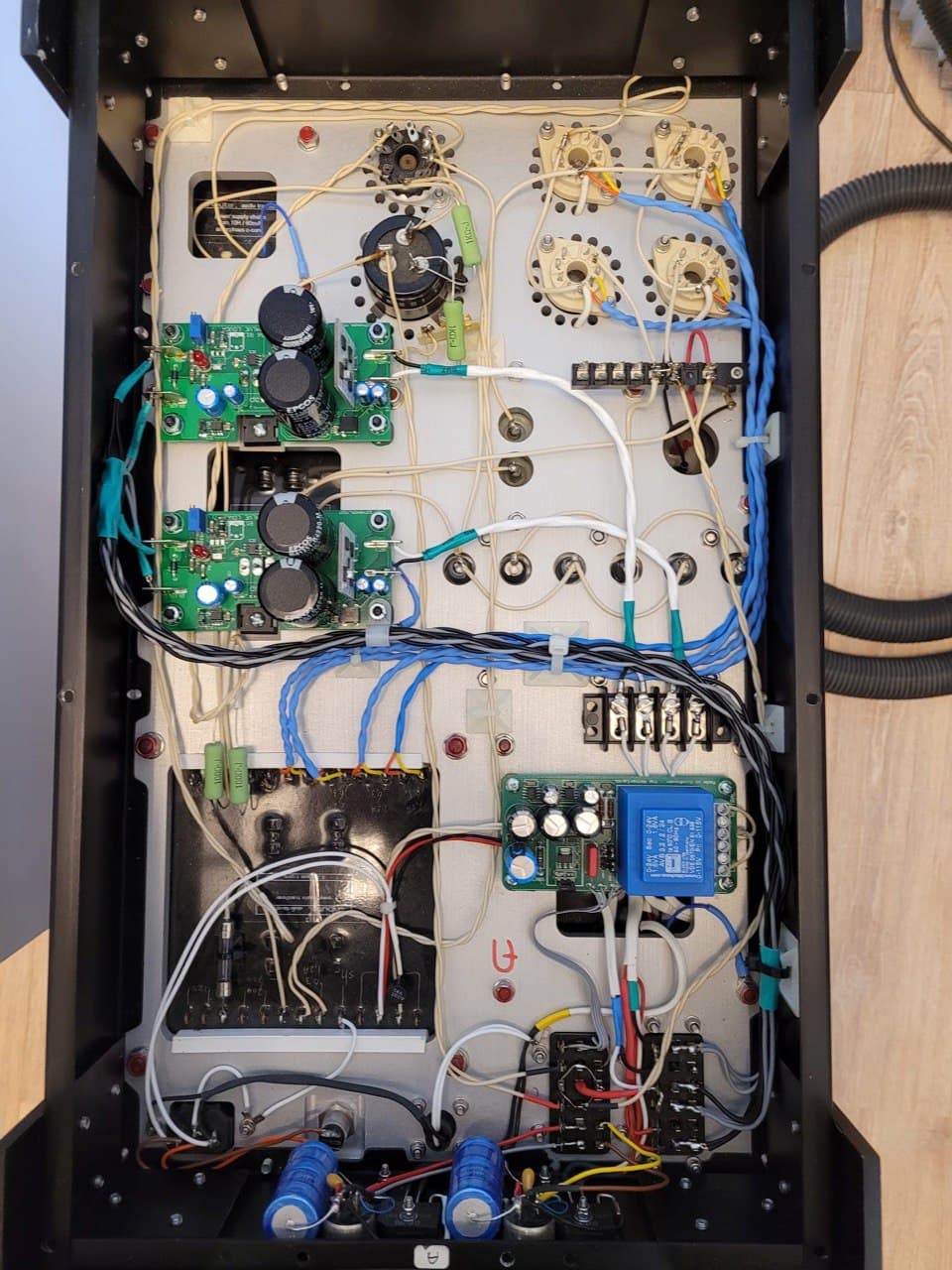

I have also built a 833A amp, which has been working happily for two years now. My solution for the 833A filament is: I have a transformer with two 15V 5A secondary. The secondaries are bridge rectified separately with a 10000u capacitor each, and fed through a total of four LT1083 constructed 2.5A constant current sources, delivering a total of 10A to the 833A filament. The result is hum only audible when my ear is within a few inches to my 98db speakers. Using CCS also achieves the benefit of a soft start.

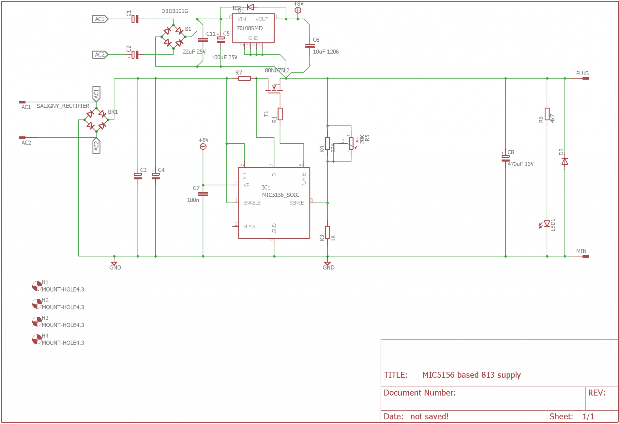

Ive built some supplies for a client that run of 10VAC to 10VDC with LT4320 saligny boards, and MIC5156 LDO controller, IXTH80N075L2 pass device.
works flawless and doesnt need much in the way of cooling, power loss is less than 20W for DC fillaments. And all in a 52x100mm package.(for813) and 52x160 for 833.
PM if you want me to roll you some tailored to 833.
