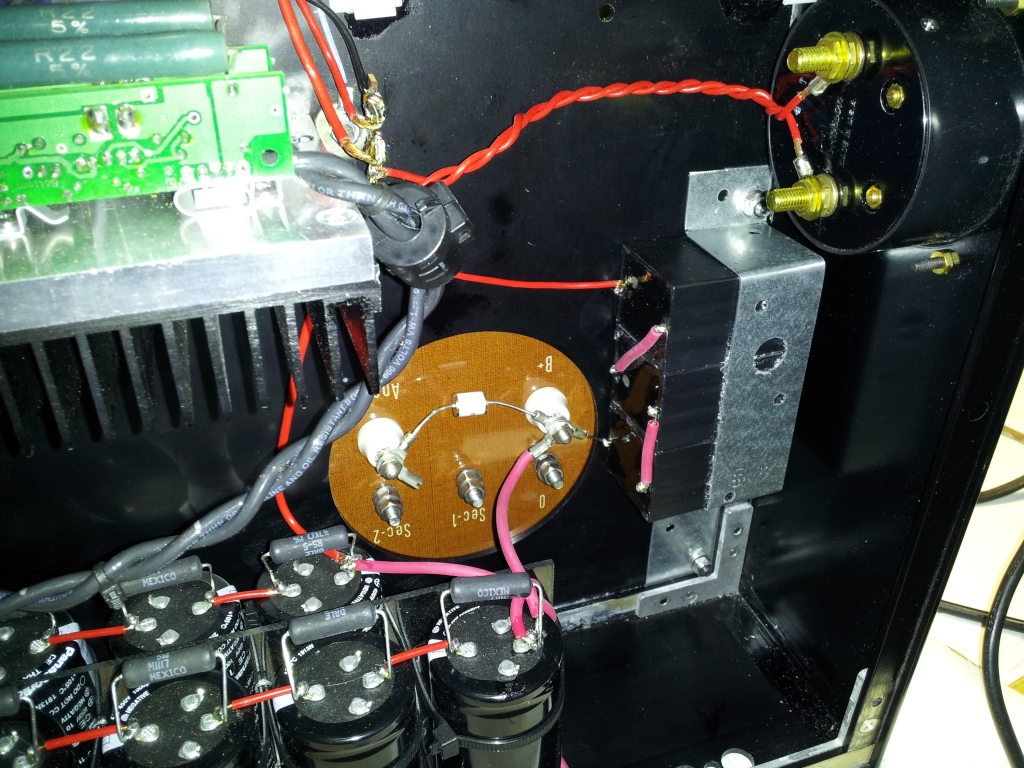

I decided to add some film decoupling caps to the output stage power supply, to help out the 7 series TSHA electrolytics, so I put three 10uF, 1000V Mundorf MTubecaps in series to make a 3000V, 3.33uF decoupling cap, with an ESR of 39mohm. The 7 series TSHA caps have an ESR of 1.2 ohms, or 31X higher than the decoupler. I fabricated a bracket for them and bolted them to the chassis using the output transformer bolts - it worked out neatly in terms of the mounting (see picture). The caps connect directly to the OPT B+ connection with a very short 18ga lead, with the other end connected to the circuit ground.

I agree with you it looks a bit to close the chassis...not only that but I would have mounted them on a piece of Paxolin (or suchlike) and had them vertical with the connections upwards. In addition to having some equalizing resistors across them as well as an HT Bleeder Resistor to ground

Yes, I thought of the proximity issue too, while trying to get the cap as close to the connection as possible (as decouplers should be). The pin for the cap is bent away from the chassis and coated with a couple layers of corona dope (3000V/mil dielectric strength). I was also planning on sliding a piece of insulation under the pins (there is some space for it), but just haven't done that yet. The caps aren't glued down, just bracketed, so it's not a big deal to slide some insulation under them.
I was under the impression that with film caps the equalizing resistors usually aren't needed because the film caps are much more consistent than electrolytics. However, in the name of extra safety margin I may add them in anyway just in case.

Regarding the balancing resistors, PP film caps have leakage in the low nA range. Balancing resistors calculated according to the usual method for electrolytic caps would thus need to be in the range of 10000Mohms to allow ~10x the leakage current to flow.
Anyone know a good source for Gohm resistors??
Seriously, though, I can't find any references recommending balancing resistors for film caps. If the capacitances are close to each other, and the leakages are so extremely low, it doesn't seem that resistors would be needed - am I missing something?

The dielectric in a film cap is much better that the oxide layer in an electrolytic, so the equalizing resistors can be a much higher value but finding small resistors with a suitable voltage rating can be difficult.
Absolutely, some insulation and/or a different position would be good.
I would also question the dielectric strength of the plastic case the caps are made of, maybe not now, but after 10 years of heat, humidity, and dust. Reccomendation: Kapton tape is your friend. I bought a 2 inch wide roll at a hamfest several years ago for $30. Its way neater than corona dope and looks better. I would put a layer or two on the chassis under the caps and the connections, and some on the mounting bracket.
Thanks for the kapton tape recommendation, I'll have to pick some up!
So, from your comments I assume you feel the balancing resistors are necessary, correct?

Should give about 8uA of current, plenty to swamp out the nA level leakage of the film caps.

This is only for the bypass caps (decoupling). These are connected to the main electrolytic cap bank which has 5W 47k bleeders, so it should drain through those. Keeping these at a high value keeps the dissipation low, so I can use small resistors and not generate unnecessary heat (there's plenty already!).
