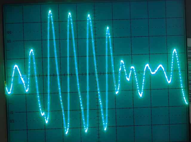

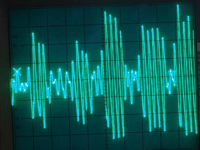

I have measured clean sine waves of 65 V P-P across my Yamaha speakers with an SSE being fed by bass guitar. That would correspond to about 60 watts....from an SSE! WTF????? No, the SSE can't make 60 watts, the speaker is about 30 ohms and it provides some assistance due to the flying woofer cone. The 65 V P-P corresponds to a plate voltage swing of about 1300 volts. The B+ is only 450 volts, so yes it's possible to exceed 2 X the B+ and I haven't even hit clipping yet.
The pictures are taken from the scope screen with the scope set for 10 volts per division and wired directly across the speaker. One picture was taken at 10 mS per division, and the other at 100 mS. The OPT was a One Electron UBT-3 (3000 ohms) and the SSE had a KT88.
Guitar amps often run into hard clipping. This causes the output tubes to act like switches alternating between saturation and cutoff. There is often a brief period where neither tube is conducting due to bias shift and stored energy. If the amp is operating into a mismatched load that is near resonance, the plate voltage can spike to several KV.
It is the magnetic energy that is stored inside the OPT that causes the "spike" that we talk about, and this is the only real concern that we need to protect from in a real world amp.

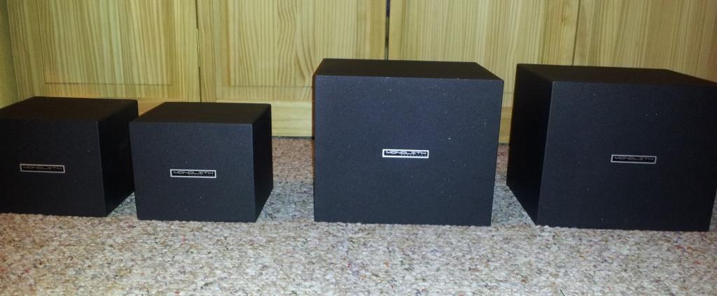

Speaking of "Monster Amps with Massive Transformers"...
I picked up my shipment from Monolith today. Check out the pics.
Each OPT weighs 62 lbs, each choke weighs 24 lbs (that's as much as my HV power transformer!). The chokes are rated at 35H at 180mA, 100Hz. They'll be L1 on the 833 B+, choke input.

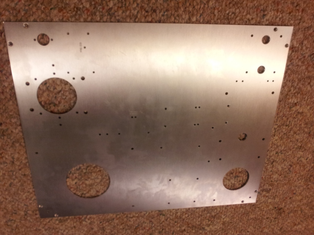

A little more machining to do, then anodizing, then assembly.

ONLY 62lbs !!!!!!!!!!!!!! don't you feel cheated....joking aside I am envious. You can not beat plenty of iron...big trannies are like 12 inch woofers you need to move that Air and it can not be done with only 4 inches....size really does matter

So... You'll have roughly 110 lb of iron per channel. I hope you're planning to put casters on the chassis.
Or perhaps a big eye bolt at the center of gravity of the amp, and a ceiling mounted winch in your listening room...
~Tom
Actually a bit more. There are 6 chokes and 4 power trannies in addition to the OPT, per channel.
I plan to invite a few friends for a "listening party"...after they help me carry them out of the basement.
Dave from Landfall...if you're reading this, this is a true test of your aluminum chassis!
How much do you think they'll end up weighing?
~Tom
About 150 lbs per side is my estimate, give or take 5 lbs or so...and I saved weight by going two-stage, solid state rectification, and aluminum chassis.

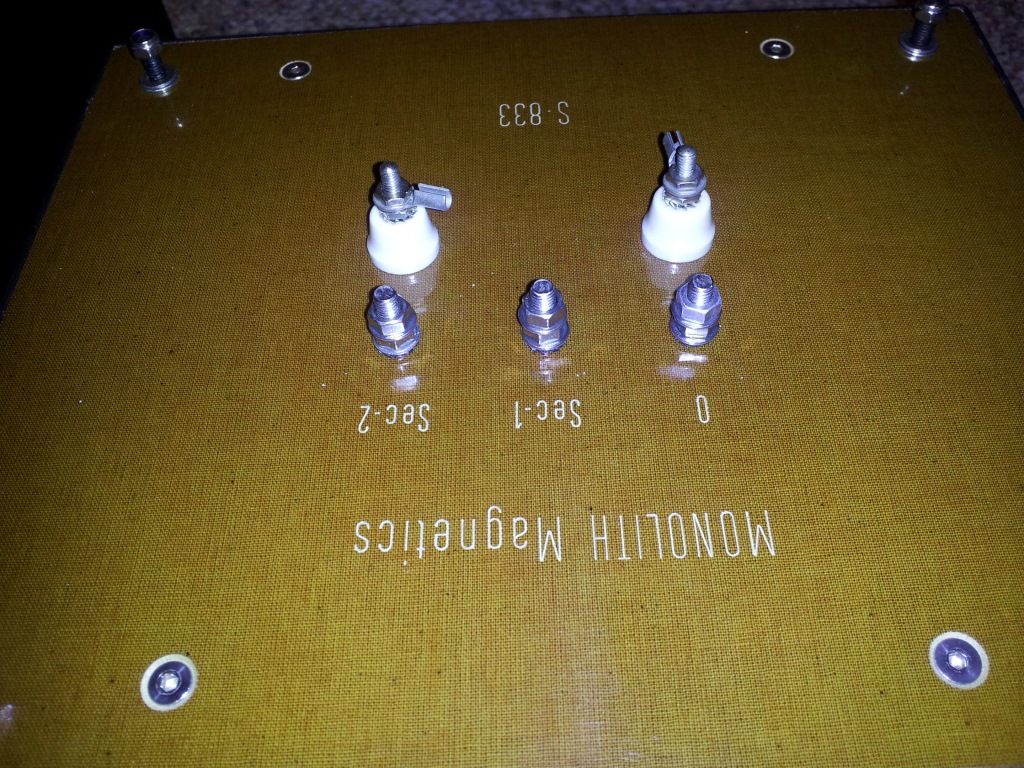

Here's another shot, this time the bottom of the OPT. Note the heavy duty ceramic insulators for the HV.
awesome, what is the clearance between the HV and the secondary terminals?
the biggest traffo i ever made weighed in at about 22kgs...
2cm.
This will definitely be a first.
