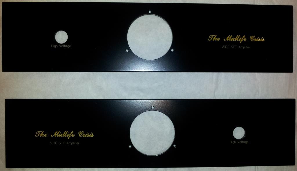

I received the front panels back from FPE today - they came out very nice.
I made the holes with hole saws before I decided to send them for engraving, powder coating and infilling. The big hole is for a Simpson DC ammeter and the small one is for a remote low voltage switch for the 833 B+ soft start.
