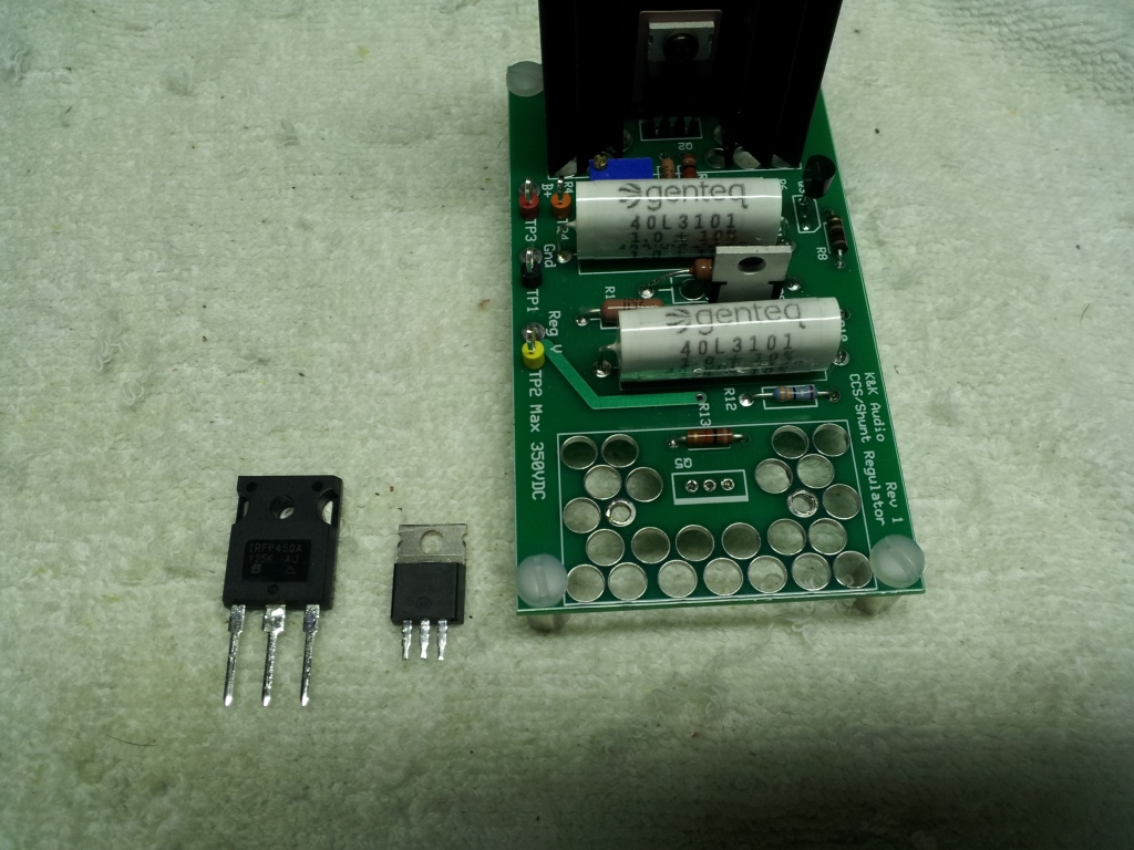

OK, I'd like some help thinking through the power dissipation and heat sinking requirements of the AOT1N60 mosfet driver. Here's the way I figure it.
Looking at the graph in post #23 of this thread, at full power the circuit is pulling grid current about 1/3 of the time. Assuming the worst case scenario of a square wave of grid current at 180mA plus the 32mA DC plate current for the 6E5P, the average current would be:
.67*32mA + .33*212mA = 91.4mA
Average power dissipation at full power would be:
91.4mA*(400V-216V) = 16.82W
The AOT1N60 is rated for 41.7W at 25C and derated at 0.3W/C to 31.2W at 60C. I'm hoping to heat sink the mosfet sufficiently to keep it at 60C, so the 31.2W figure would be applicable.
So, for a sanity check, does this look about right? Sounds like the AOT1N60 should survive, correct?
If not, I could upsize to the AOT2N60, which is rated at 53W at 60C, but which has twice the capacitance of its smaller brother.
Thoughts?
Looking at this another way, using the Safe Operating Area graph on the datasheet, the AOT1N60 chip looks like it's good up to ~800mA max for 300uS pulses at 200Vds (25C case temp), so it appears it should survive 180mA pulses just fine given proper heat sinking. Since I don't intend to be running at a full 200 watts of power for very long periods of time, I'd think this ought to be sufficient.
One of the key design features of this amp is the use of a shunt regulator under the cathode of the 833 to hold it at ~247V and allow adjustability of the bias, while sinking the cathode current from the 833. I'm using shunt regulators from K&K Audio, based on the Salas SSHV design with a cascaded CCS in front. At first glance, the shunt transistor, IRF840 seemed like it had plenty of power dissipation capability (125W), but looking closer at the heat sinking required, junction to case thermal parameters, package size, etc it will be really close to blowing up as it tries to sink its 15mA set current plus all the current passing through the 833. In the interest of reliability, I've decided to upsize the Mosfet from the IRF840 to the IRFP450A, which has 190W power dissipation and comes in a TO-247 package for much improved heat dissipation.
The junction to case thermal resistance for the IRF840 is 1degC/W, which drops to 0.65degC/W in the IRFP450A. That's a big difference when you're trying to dump that much heat through the case into the sink/chassis. The Mosfet will be mounted off the board on a solid 10mm thick block of aluminum bolted to the chassis.
A snapshot is attached showing the two Mosfets and the regulator board.

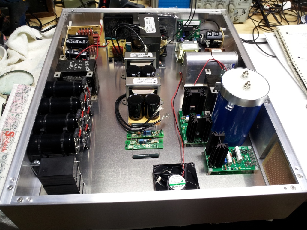

The other reason I selectively use SS is SPACE! Attached is a picture of the components (most of them) laid out in the Landfall Chassis, which is 23" x 18" x 4.25", and the fit is pretty tight! The transformers for the driver and power tube supplies, the first choke for the 833C and the OPT will be on top of the box. From left are the 833 B+, 833 Filament and Driver B+, heater, bias supplies. I haven't built the input board yet with the gyrator; the empty board is tucked in the front right corner of the chassis.

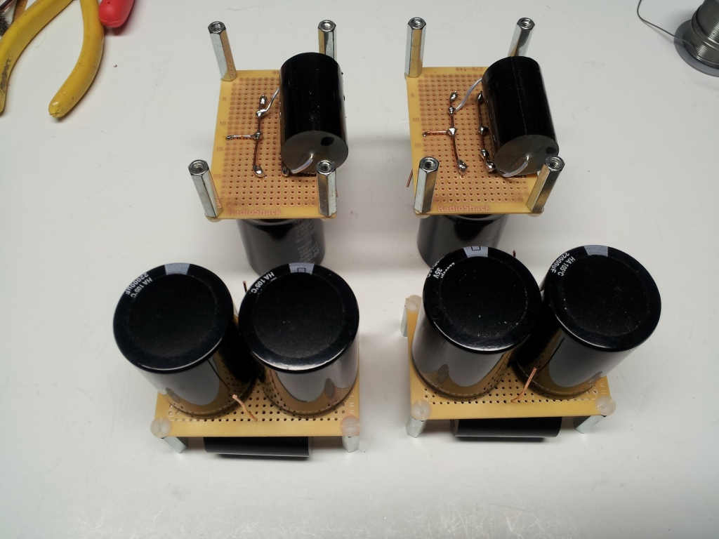

Finished up the 44mF cap assemblies for the 833 LCLC filament supplies, and added 4.7uF Solen PP films as bypasses. I usually bypass large electrolytics with films, but I prefer to use a few uF rather than the .1uF or so often seen. It's made an easily audible difference in some of my projects, and not much of a difference in others, guess it depends on the rest of the circuit as always.

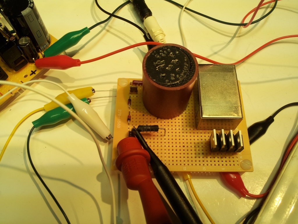

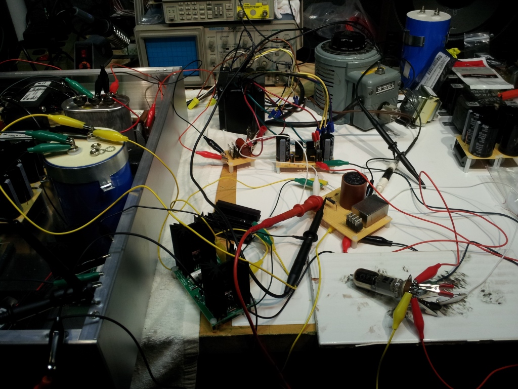

I built one of the Input/Driver boards, containing the grid choke, 6E5P bias diodes (Cree 600V Schottky diodes), gyrator circuit, zener protection diodes and the gate supply resistors for the AOT1N60. Picture 1.
I now had all of the driver circuit components built so I decided to wire it all up (the input/driver circuit and its power supplies) with clip leads and test it. Picture 2.

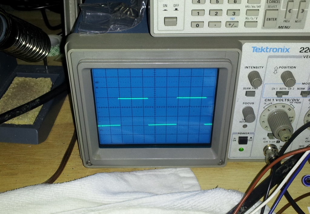

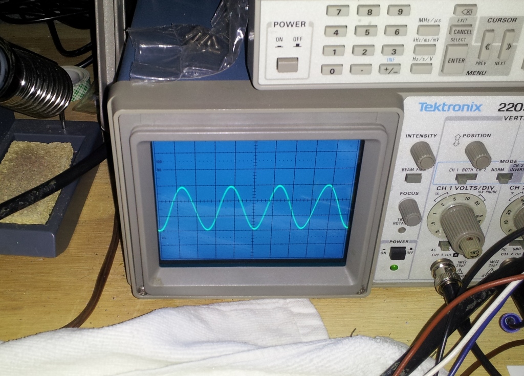

I fired it up on the variac...no smoke, always a good sign! After a bit of adjustment on the shunt regulator that supplies the MOSFET gate voltage, everything was about where it should be on the DC front, with 216V at the 1N60 source, and 28.5mA coming through at the cathode of the 6E5P.
So I then sent some test signals through, 2kHz sine and square waves, and they looked good too! Pictures 3 and 4.
So I can say at this point that this circuit works fine up right up to the 833C tube. Good news.
Time to build the other input/driver board in the first one's (mirror) image!

Since I had the circuit set up, I decided to test the performance of the AOT1N60 vs the AOT2N60, to see if there were any differences to be seen.
Spec Differences:
The 2N60 is rated for 74W dissipation, as opposed to the 41.7W of the 1N60.
The 2N60 has higher capacitances, with the Ciss (270pF vs 130 pF typical), Crss (2.8pF vs 1.8pF), Cdss (29pF vs 14.5pF) all higher.
The 2N60 has about 1/2 the Rds(on) of the 1N60.
Results:
DC-wise, substituting the 2N60 for the 1N60 resulted in identical DC voltages at the test points. Temperature of the chip was similar (~60C after 5 min).
AC-wise, sine and square waves also looked about the same. For both chips, square waves didn't start to roll off until the leading edges of a 100kHz square wave, so ~1MHz or so, plenty good for audio!
So, I really didn't see much difference between these two chips in the test circuit. Why? Perhaps that level of capacitance isn't significant when they are used in source follower mode?
Anyone care to offer their opinion on that?
