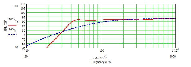

Concerning the simulation made by Jim for the ff165wk, I had a hunch that the ripple was caused by the Z driver being equal to 1/2 L, so i went and remodeled it using Bob Brines' measurements of the ff165wk, and altered the parameters provided by Jim Shearer for the enclosure using the following:
L= 55 inches
Zdriver= 30 inches
So= 1x5 inches
Sl= 10x9 inches
Rport= 1.5 inches (diameter= 3)
Lport= 2.5 inches
Stuffing density was kept standard at 0.25
And this is the result I got.
I seems to look better than Jim's simulation upfront, by I have a feeling that there's something terribly wrong that i did not account for.
So if anyone could shed some light, please go ahead.

That looks nice! Less ripple & F3 is a bit lower.
I had hoped that Scott might comment earlier, as he is much better at this than I am.
One thing that stands out for me is that the Met design is reasonably robust/tolerant. Small changes in dimensions don't result in disastrous loss of performance.
Cheers, Jim

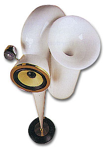

On the issue if TQWT:
Would the B&W Emphasis be considered an inverted and folded metronome?
It appears to be a tapered cone with a port in the mouth.
Trying to understand the terminology and see how it can be translated into a very aesthetically pleasing design.
Hmm, it does appear to be a flared vent, offset driver, TL of sorts, but the driver filter chamber makes it more of a funky BLH than the Metronome's simple vented pipe horn.

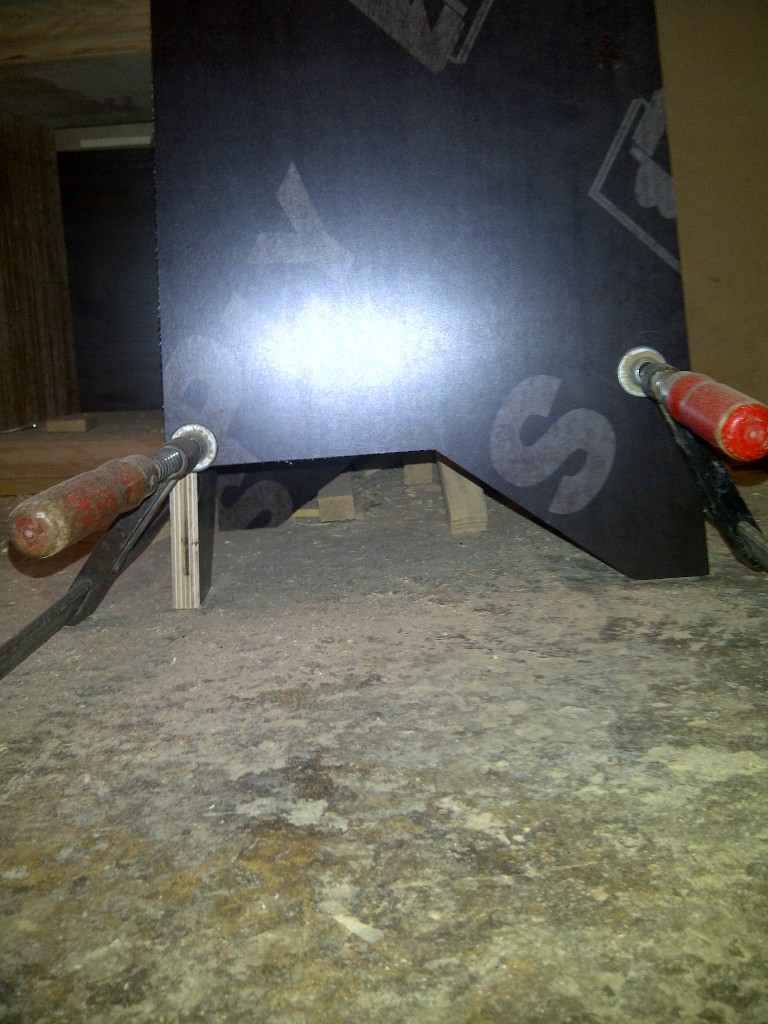

ff165wk construction
So, after running all the sims over and over again for the ff165wk, I had mustered enough courage to actually build the enclosure (or to be more precise, have the enclosure built by a professional carpenter).
Below are some pics of the build during dry fitting just to get a peak at what it'll look like.
I ended up redesigning the feet, giving them a more "modern" look that'll better go with my listening room.
The enclosures are made out of 18mm marine plywood, CNC cut down to 1/10mm precision.
As you can see on the leg closeup, I made a design mistakes and did not account for the plywood thickness when drawing the side panels, which left me with a step from front panel to side panel at the leg level.... well you live and learn.
Paint should be done by tuesday, will post more pics then...
Regards
Nick
P.S: sorry for the bad pic quality, but there's only so much one can do with a crappy phone camera...

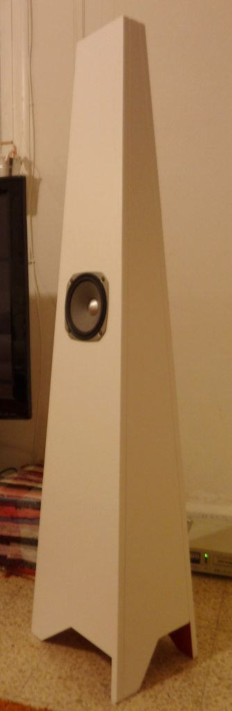

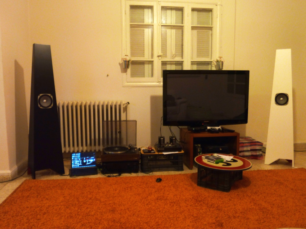

Here they are, finished and singing...
I ended up lining the inside of the back panel with acoustic foam from top to bottom, and am now in the process of voicing them by adjusting the stuffing in the upper part of the line (above the driver).
So far, they image like no speaker I've ever heard before!
Another thing is that they definitely need a BSC filter, but i'll do that once i'm finished with the break in (30 hours down, another hundred hours or so to go...) and once i get my measurement rig up and running
The ff165wk are very smooth drivers compared to the usual full ranger i'm used to and i can't say they're lacking in the upper registers....
I'm a happy happy metronome owner.

Thanks,
I wanted something that would be easier to do and does not require a router, so this design was the best fit, the cool factor was just a lucky coincidence
Glad you like them!
Those asymmetric base arches look cool
Steve
