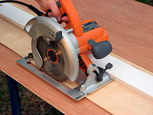

Cutting long lengths straight with a skilsaw
I did see some remarks on making a jig for the table saw.
Howver you can easier work with a skillsaw: make a jig for it. Find a piece of material that has a straight edge and glue that on a piece of mdf or ply or what ever you have (I like MDF since it makes it nice smooth cut which makes it easy to line up).
Afterwards you run the skillsaw against this glued on guide.
Next time when you need to cut you just put this exact on the edge where you want to cut, clamp and cut away.
See pictures (taken from the web)

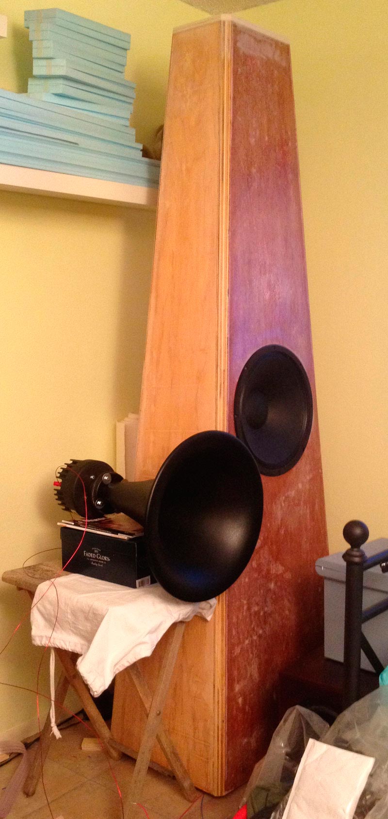

Well, I have cabinets built for my Faital 15 inch macro Metronomes, and they have been once again moved into my tiny listening room. They have been playing for about 4 weeks now, off and on (mostly on), and my Stereolab Tractrix horns arrived about 2 weeks ago, and were promptly attached to the pair of TAD 4002 drivers I've had laying around for a few years. I put a simple first order crossover on the woofers at 150Hz and a first order on the TADs that I settled on at about 1100 Hz. The huge 20 Ohm recommended series resistor for the TAD came in handy- in concert with a parallel 6 Ohm resistor, it brought the levels pretty well in line, but I'm working on my 18 Db high pass filter for the horns this weekend, as there is a dip in the response about 5-600Hz or so that needs to be addressed…
Overall, a really great sounding system for being so thrown together. The bass is more than powerful enough- I simply raised the base of the unfinished cabinet .75 inches from the floor to fiddle the response to my liking- the system signs off about 35Hz or so, but makes up for that with some of the fastest bass I have ever had in MY system. That, and the tremendous power handling makes for a system that can literally break windows with the kettle drum. I'm moving them to a larger room to make sure the system balance is good, then they are going to be finished in copper, and the height adjust mechanisms added to the horns, which are to be mounted on the sides of the cabinets.
I made my own resistors… The commercial units sound markedly inferior to about 14 feet of Nichrome V arranged in a hairpin bundle. The finished crossovers will mount to the back of the cabinets, wired completely with silk wrapped solid silver, which the Radian diaphragm equipped TAD seems to prefer over my commercial offerings. Haven't decided on my final caps- probably something beeswax and copper foil, though. There are a LOT to listen to…
Excuse the room… Getting ready to move things, and, you know, prototyping…
Whats strange about the whole setup is- the horns currently sound best when they are down low like that. I'm making the height adjustable on the mounts.

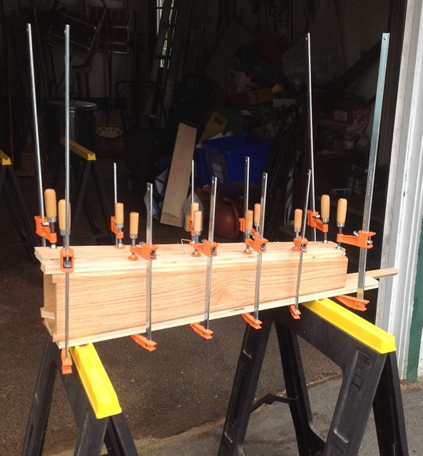

Photo 1: partly assembled
Photo 2: final glue-up
Photo 3: finished! ‘family’ photo

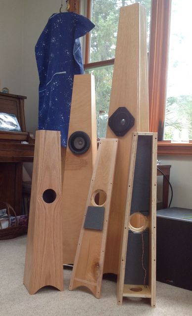

In the third photo, from left to right:
-- mini-Met from the front;
-- FE167e Met;
-- FE108eSigma Met;
-- F120A Met;
-- mini-Met from the back.
So how do they sound? Good.
As expected, they are much like the MJK passive OB (from which two of the FF85k’s were extracted) in both sonic presentation and limitations. They need to be at least 3 feet from the wall, or else there are sonic issues: e.g. when I placed them only about 12” from the wall, there seemed to be a suck-out around 400 Hz, and they were, well, just sort of weird. They are way smaller than the OBs, and have usable response only down to 80 Hz, so they need a sub to help on the low end. And because they are playing full range, they are more limited than the OBs for spl, especially with complex orchestral music. Putting an XO on them, at say 120 Hz, and placing them on top of a woofer unit would be a significant improvement.
They have that property of extracting the ‘hall sound’ from a recording that I find attractive in OB and panel speakers--the very property that some folks love, while others run screaming from the room. Certainly not everyone’s cup of tea, but I find them very engaging.
