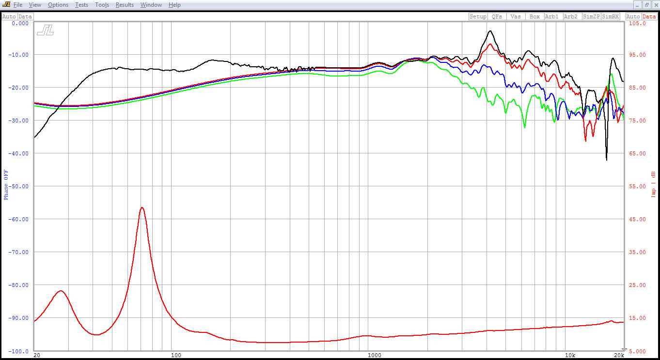

I think that the 165WK is at a least as good as the 167E, probably better. The only issue is the narrow peak 4kH. It give a Lowther like brightness to the sound, but it is just below the sibilance range, so it is not that much a problem. A parallel notch filter would fix that. the attached FR plot is in my 40" MLTL. The 165WK is more likely to need tweeter support than the 167E, but that depends on the listener. FWIW the 225WK definitely needs a tweeter and I found that at 1st order filter on both drivers @4500Hz works well. Low passing the full-ranger removes some rather obvious combing.
The FR plot is 0,15,30,45.

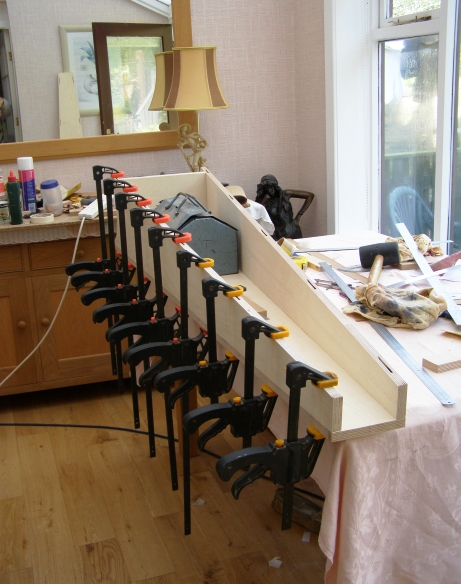

Number two under construction.
Note slots for biscuit joints
These are going to be STRONG.
Youve got to love a picture like that!!! I thought it was only me that went clamping overkill! I think i managed with only 5 clamps
using simple furring strips would be much stronger.
If by furring strips you mean cleats then I couldn't agree more. They also do the aligning when you apply them to one panel first and take no longer than biscuits. My joiner has years of dust on it as I just don't use it any more.
Cheers.
EDIT: It appears furring strips and cleats are one and the same.
