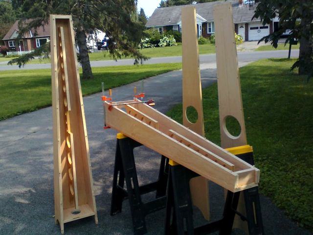

Last summer’s project was supposed to be a pair of FE167e Metronomes. Having already made Mets with FE108eSigma and F120A drivers, I wanted to hear what a 6.5” driver could do in this style enclosure. (I obviously like the performance of this enclosure, and my wife finds them attractive--although she is growing concerned about the total number of speakers in the house.) The 2010 building season was instead taken up with making kitchen cabinet doors--a worthy endeavor to be sure, and one which earned some serious points for me.
I did break in the 167’s last year in an OB set up, so they have more than 400 hrs on them, and will only need a few more to ‘wake’ them up.
I ran the numbers from Dave Dlugos' Metronome tables in MJK’s MathCAD worksheets and tried tweeking the dimensions to see if anything looked more appealing. The box dimensions (generated by Scottmoose IIRC) appear optimal, but I decided to try a port length of 3” rather than 2”. It’s easy enough to trim the port down if I don’t like what I hear with the 3” length. This should give a couple Hz extension on the low end with only a small change in the bass output SPL.
So I have been working away for about 2 months now. Only final finish left coats left to go. Pics below show the 167's breaking in (sitting next to my MKJ OBs) and what they looked like a few days ago before I put oak veneer on the front baffles. This is to hide the edges of the ply. I cover the entire baffle because I use a round-over on the edges for cosmetic reasons, and I don’t like the look of exposed plys.

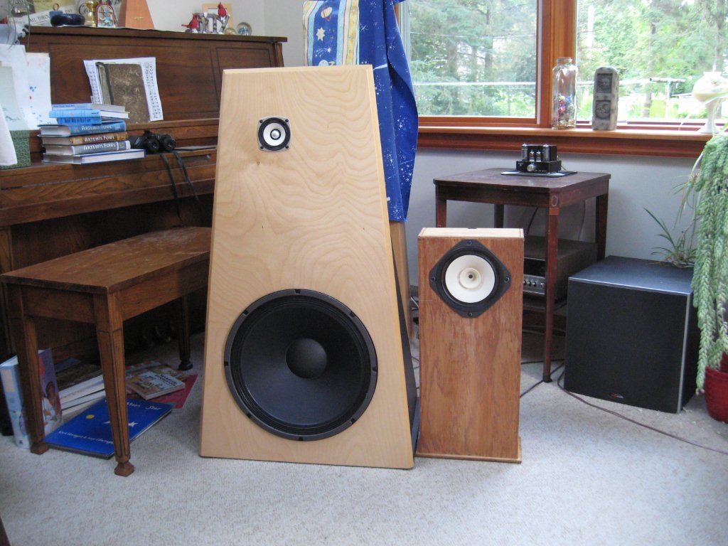

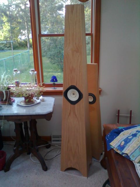

The FE167e Metronomes are finished! The pic below shows one of them standing in front of a FE108eSigma Met (my first build). I don’t think I will build a Met with larger drivers than the 167--these still have that svelte, high WAF character. With larger drivers, I think they would begin to look bulky and awkward.
After about 20 hrs. of playing (to wake up the drivers from their slumbers, even though they had more than 400 hrs. on them already,) I began critical listening. They naturally have a more bass extension than the 108’s, and even a bit more than the F120A Mets. I plan to make a simple cardboard tube port 2” long to see if I prefer them as Scott designed them, or if I will leave the ports at 3”. I need to make measurements, but from the sound of tacks like “Temple Caves” from the CD Planet Drum, I believe they have useful output into the mid 30 Hz range. The deepest notes are not as strong as they should be (and would be with subwoofer giving extension flat to 30 Hz or lower,) but definitely there and palpable.
The freq. balance wasn’t right though. A little too detailed and ‘hot’. So I ran a quick BSC calc using the Excel sheet from Quarter Wavelength Loudspeaker Design and got the following numbers:
for 2 dB of BSC: 0.5 mH and 1.8 ohms;
for 3 dB of BSC: 0.8 mH and 2.9 ohms.
I happen to have 0.7 mH air core inductors and 1.5 ohm Mills resistors. Adding these to the 167 Mets gives a satisfactory result. Still lively, yet not fatiguing.

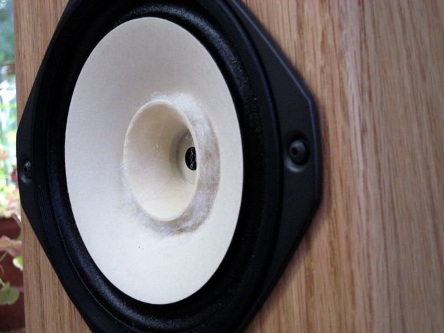

I also tried the ‘bearded whizzer’ tweek. I placed a small amount of PE AccoustaStuff around the whizzer (see photo) to see if it would result in reducing the touch of high freq harshness produced by interference between the whizzer and the main cone. Both my wife and I agree that this makes a small, but worthwhile improvement.
Conclussions:
The FE167e Mets are a success! They give up a bit in the mids & highs compared to the FE108eSigma and F120A drivers. OTOH, they hit deeper, play louder, and handle complex, large scale classical music better than their smaller siblings.

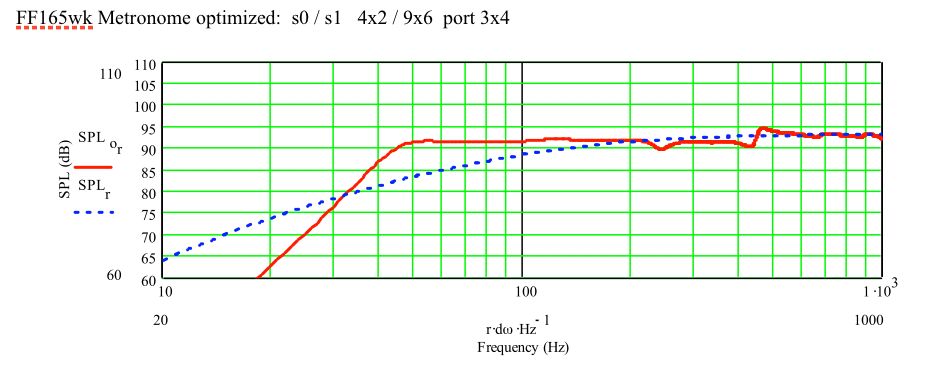

Before I built my pair of FE167e Mets, I looked at the FE166e to see how they would work in a Met. Models in MJK's MathCAD worksheets lead me to conclude that I should grab a pair of FE167e before they disappeared, rather than using the 166's.
When I saw your question, I wondered about the recently released FF165WK. When I modeled it in a Met with the dimensions for the FE167e, it appeared to be useable, but could stand to be improved. So today I had a little time & ran some models of the FF165WK in a slightly smaller cabinet than the FE167e. Below is about the best I found in my limited time. Scott can probably do better.
Using MJK's MathCAD worksheets where:
L= 60"
Z(d)= 30
S(0)= 4"x2"
s(l)= 9"x6"
port dia= 3"
port L=4"
Note: I did not check to see if the drivers actually FIT into this cabinet, so if you decided to use these dimensions: make careful drawings to check everything first!!!
Cheers, Jim

Jim, your sim looks good. Mets are fairly tolerant so yours is likely good to go.
