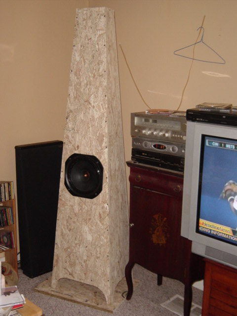

Here's my very rough model of the Metronome/ANS10.I used heavy duty Advantech flooring from the dumpster at work and got carpet underlay free also.The driver cost $35.I had to change the cab. size to fit the driver and ended up placing it 32" from the floor.There is a little room to raise it up a bit so I'll probably cut a new front.Also need to make a BSC at some point.I actually liked it better in the quikie OB I had it in for a day.
