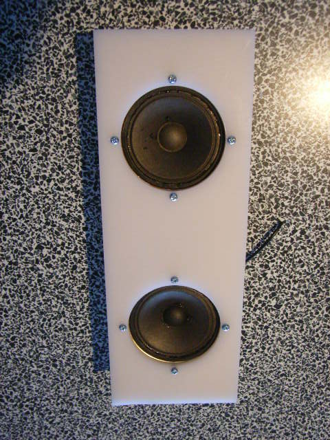

Correction on the tweters
The tweeters were actually in parallel..................:eek:
I was thinking about puting them into a plate like this.
Phase plugs in these.......wow they would have to be pretty small.
frugal-phile™
Joined 2001
Re: Correction on the tweters
Are the Ts 4 or 8 ohms? If 4 ohms nominal XO would be ~ 7k, if 8 twice that (which would mean they were being used where they are at their best)
You'll find that they will work best if used singly... 1 likely won't keep up with the RA so you might well need to stash them for another project
Typically these have 1/2" VC -- i used a tapered foam earplug and cut it down till it fit. The hard part is getting a perpendicular cut. You need to attach 2 pieces of metal to the bottom -- with only 1 (i started out with a washer) they want to flop over.
dave

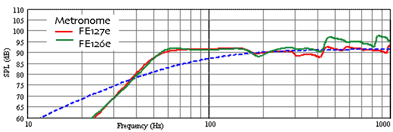

I'm looking for a design to build as a 2nd speaker after a pair of Needles. I was going to do a BIB pair, but there are no corners in the room where they'll live :) The Metronomes are very pretty - if they go down to just below 50Hz like the Needles, they're probably the top candidate.
I think I want to try Fostex drivers - I can't forget how cellos, guitars and live Squarepusher sounded on a simple pair of FE103 boxes.
So:
* Is it known how low the Nomes will go, in-room and with proper port arrangements, with FE126 drivers?
The graph seems to indicate 55ish Hz:
http://homepage.mac.com/tlinespeakers/FH/images/MetronomeFamFR.gif
* Could things like port tuning help them go a bit lower?
* Are the FE126'es OK w.r.t. Xmax when playing low notes in a cabinet of this type?
