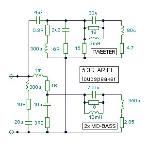

Hi Ingrast.
I note that the LD6C has no impedance compensation about the mid range.
This is the approximate I have used for the 'Ariel' loudspeaker.
Two choke resistances included, they are not separate series resistors.
Cheers ....... Graham.

Hi Ingrast.

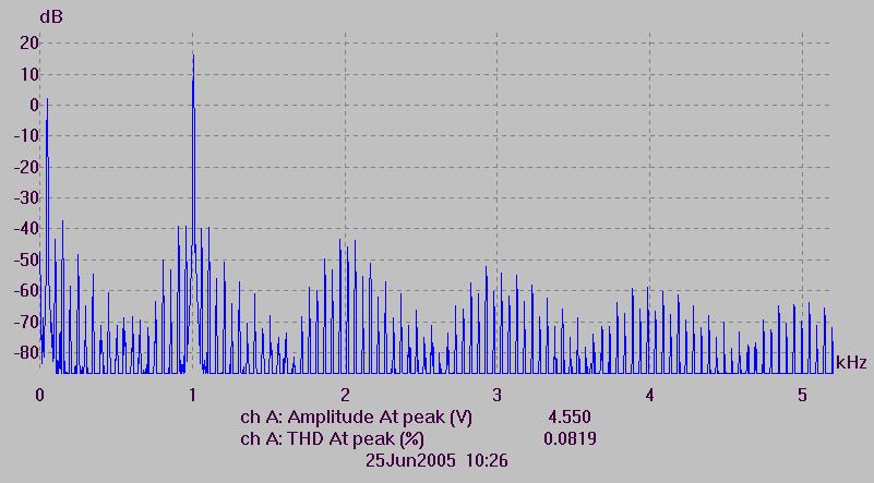

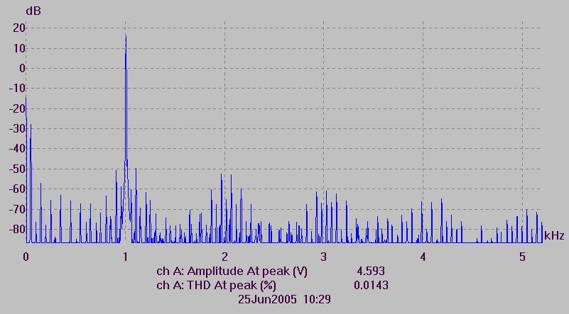

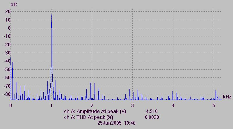

Hi Graham, in your post#129 you have exposed exactly my conclusions, is as answered to lumanauw that to me.
I am able only integrate the reasoning with a little series of demonstrative measures.
The setup is the usual trafo+filter@2.4Vrms of the firsts (IMD) graphs, but the measure is relative to 4.5Vrms 1khz ( rather than 3Vrms ). The first thing that it is note is an increase percentage of IMD with the grow of the signal of entry ( but this is obvious )...
P:S: No problem for new "d u mping structure" ( Only after showing serve to improve this problems);)

But the "secret" ( believe ) to the proposed problems by Graham is this: if you notices the encircled to High and mid NFB have the first signs of IMD to about -25dB from 50Hz fundamental . If we increase the DF reduce all altogether. The graph of JLH has a difference of about -40dB. This means that to parity of DF the circuit JLH is a lot of more linear ( immune from back-EMF ).
Ciao
Mauro
