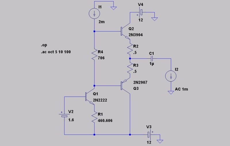

Food for though...
Here we have a basic circuit that could be part of a headphone amp or whatever.
A VAS stage feeding a complementay EF pair. There is no feedback (besides the degenaration on the VAS emitter).
Q1 is biased at 2mA, Q2 and Q3 at 5mA.
The output impedance should be (25/5 + .5)/2 = 2.75 ohms.

It's related to the intrinsec emmiter resistence at 25 deg C, 1/gm or whatever (I really don't remember ).
One can simplify it using 25/Ic at room temperature (this I remember...).
So, for 5mA emmiter current, re is 5 ohms, plus 0.5 ohms of external resistence, divided by 2 because both transistors conduct at the same time.

What the output impedance shows IS source impedance/HFE!
Which is the output impedance of a degenerated CE stage feed from a low Z source (such as an emitter follower)?
If this same output pair was feed by a voltage source, output impedance would be quite low (of the magnitude I've calculated).
Maybe that's one of the reason's for the VAS to ground resistors in the Leach amp...
The reason for the previous posts is to show that, depending on the output stage topology, all the damping is obtained through feedback, and so there's a very high likehood of back EMF been feed to the input.

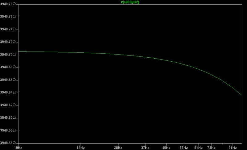

So Jorge,
Your example gives an OL Zout =4K due to hfe=200 and 200K source impedance (Zoutvas) from the Vas. Alright.
Now lets put a chip at the front and apply 94dB of NFB at 50Hz. bingo. DF =100, Zout =0.08 ohm AS SEEN BY THE LOAD. or.
You can load down the Vas with leech like R's to GND, let's say 2K total. So open loop Zout=10 ohms and if we apply 42dB NFB we get DF=100. SO THE LOAD SEES THE SAME Zout=0.08 ohm. But at the same time we have degraded the amplifier by wasting 40dB of Vas gain exchanging it for flat OL gain. Also we have increased by 100 times the modulation of the Vas and signal level of preceding stage(s) so increasing distortion in the OL amplifier but with 40dB less NFB to correct it.
The load sees a similar low Zout and a more nonlinear amp.

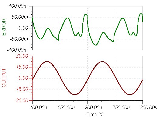

Hi Rodolpho,
As if I do not understand basic tennents you are asking me to clarify on your terms of accepting superposition based investigation of linear circuitry whilst including one significant element, which as Luminauw has pointed out, is not *linear*.
The effects of multiple amplifier non-linearities cannot be real-time minimised due to stabilisation and device capacitances slowing the NFB correction that actually generates one of the 'circuit elements' we are obliged to include.

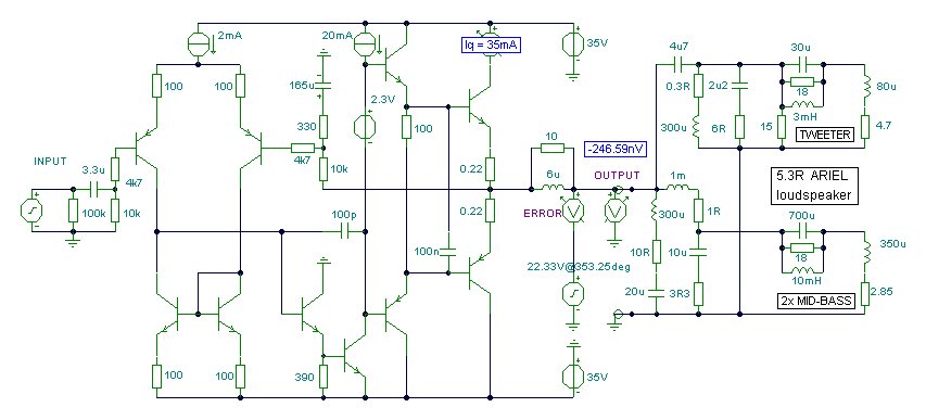

Please allow me to put some meat on the bones, as per this typical NFB amplifier - often accepted as being a *linear* performer.
As attached.

Hi Greg,
That is an excellent explanation of design choice in relation to Jorge's contributions.
The amplifier with the loaded down VAS is an exact opposite of the circuit I have just posted, and as you say it will have 'flat' open loop gain.
This means that the loaded down VAS should introduce significantly less internal propagation delay and less back-EMF induced quadrature output error. This also means that it will much better prevent leading current induced fractional reverse bias voltage commutation as can be seen on the error trace a few microseconds prior to zero signal voltage crossover.
True these errors arise at inaudible frequencies, but that does not mean that their effects are inaudible.
Cheers ........ Graham.
