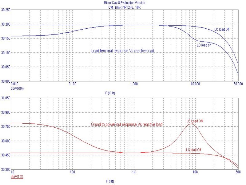

Analysis of the distortion caused by back EMF
Mauro:
Let me first voice my apreciation for all your efforts.
I know first hand things are easier said than done, and that you have put several hours hooking up test gear, solving glitches, getting and checking measurements, and drafting results for us to enjoy.
Unfortunately I have serious drawbacks to point out in this last series of measurements.
The square wave signal you are using for the DUT at 3225 Hz is a cute way to put together several test signals at once, but since they are harmonicaly related, you cannot resolve during the test how much of the measured signal (at second and higher harmonics) is original and how much is distortion products from the fundamental due to the load setup. The same applies for the higher tones, for example the fourth harmonic if measured, should include part original signal, part forth harmonic distortion of fundamental, and part second harmonic distortion of the original second harmonic and so on.
Second and related as will be seen, you are keeping the paralell resonator at 1 KHz intended in the Hiraga test to isolate (at 1 KHz) the DUT from the 50Hz source.
This isolation only holds at 50Hz, meaning that when you apply the 3225 test signal, what the DUT sees at its output is the intended nominal 8 ohm load in paralell with a 6.2 ohm resistor in turn in series with (basicaly) a 3.3 uF capacitor and whatever impedance transformer T1 reflects from the variac. It goes without saying that this impedance is basicaly unknown and of course frequency dependent.
What all this means is that what you are actually measuring indirectly is the DUT output impedance at different frequencies, and at a lower and complex reactive load. This has consequences with regard to amplifier behavior, eventually depending on cases increased distortion which as indicated formerly clouds the actual measurements for they cannot be distinguished from the input signal itself.
Again, I am sorry to have to flag this problems. I think you have the drive to produce important results, but you strayed in this last case from the former goal of assesing EMF impact on IM, that was the original Hiraga setup goal.

With regards to the added 0.27 ohm series resistor for the GC setup, any series resistance will contribute to make the DUT load impedance a little larger. I must confess the graphs do not show a substantial improvement, something to be expected given the low resistor value.
You are right. the tests that have performed have underlined practically the ability of interface on reactive load of the launch amplifiers, and not there are elements applicable to dividing the effects of the Back-EMF from that reactive. Among the other discovered have that a ground loop has given of the measures slightly alters.
The associations among sound and behaviour on reactive load staies valid, but am not associable ( perhaps ) directly to the behaviour with EMF.
This setup doesn't isolate the single problems and not me likes.
Praies you to understand my errors, because I expose the results of my bench practically on real-time, without the time to filtering in "scientific" way the data that draw.
Ciao
Mauro

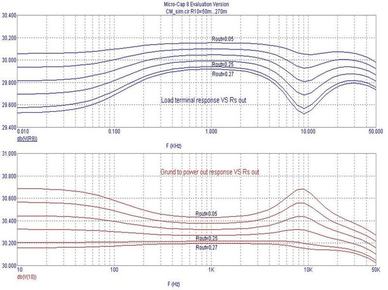

To depart the fact that we have established that this setup defines more the linearity on reactive load that from EMF, the effectiveness of res. 0.27 ohm is underlined by the values of 3 and 5 harm measured first and after the reactive load. In first 2 graph ( no res ) the variation is of about 1 %. in the graph with R0.27 the variation is of 0.15 |max|. Naturally this is fruit of a general increase of the Rout, but the linearity improvment of the dumping are concrete. To get the same resulted without abdicate to the dumping, techniques more risky is had to use by the point of view of the final results...
P.S. I am happy that you understands my errors...

To clarify any affirmations done in my relationship ( and close this capitulates ), I do see the simulation of the conditions of my setup. On account of a ground loop non anticipateded, the instrumental analysis had the characteristics simulated in the graph ( " ground to power out..." ) while the situation on the load is that in top graph. When he speak of sign |+| make a report on me the conditions that are seen under...
I conclude showing the simulation (lifelike) of the Rout joined situation( to clarify Ingrast the motives of her near perplexity ).
The condition that I saw is that of the graph under. Notice does it bewilders, that to the listening, the condition more linear is as that of the bot graph (with R=0.25ohm), while in theory to the load corresponds a greater excursion with the reactive load. This phenomenon would deserve a greater study...
Ciao
Mauro
Ciao
Mauro
