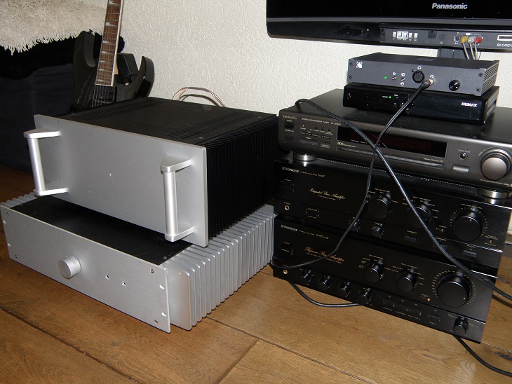

Restyle of the amplifier is finished. After consulting with koldby, asking him if I could "rebrand" it to my pseudo brand name Vandermill Audio and got permission for that I went on with that job.
If you folks remember, it originally looked like this:
664775d1519577553-towers-25-driver-range-line-array-goldmond-jpg
(top of the left stack)
That style with the grey front didn't do particularly good with the missus.
So I figured if I would do my best to match it to the line array theme it might be a little more acceptable to her and fit in a little better overall.
Here's what it looks like after the make-over session:

Overall I'm quite pleased with this make-over. I guess I have a "thing" for the black/chrome style.

The amp looks absolutely stunning. I envy you your talent of taking the right decisions to make amp design just right and look like a million. Nice work!
Thanks koldby,
I wanted to make it look like what's inside :).
Nice work with the amp wesayso. :)
What did you use to get the aluminum black?
Rattle can automotive spray paint, 3 thin coats of satin black. As it had a nice brushed finish which was anodised, I wanted to keep that look.
From a thread about Fuchs wheels finishes I remembered reading the advice from Harvey Weidman, a wheel refinish specialist, about anodised finishes and spray paint. Only light (wet) sanding as preparation in the same direction as the brushed finish.
The harder part was sanding back the anodised layer from the handle bars leaving deep scratches.
A lot of sanding needed with finer grit each step to get it ready again for polishing. An electric drill helped to speed it up though.
