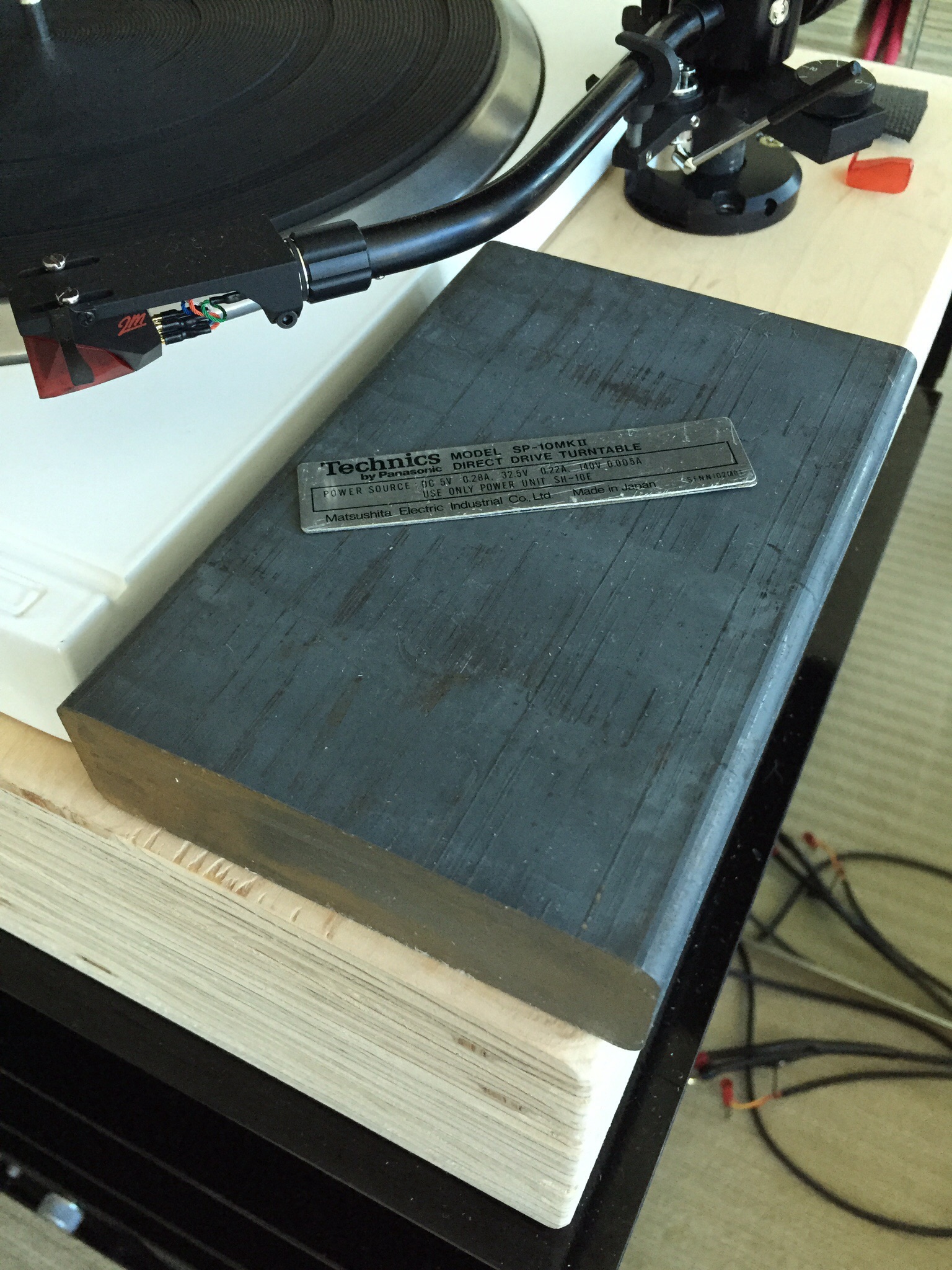

I recieved the piece of iron for the bearing drain, high graphite cast iron. Ordered from speedy metals. It measures 6 3/6" x 4 3/8" x 1 1/4"
It weights at about 10 lbs.

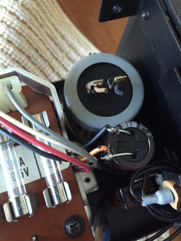

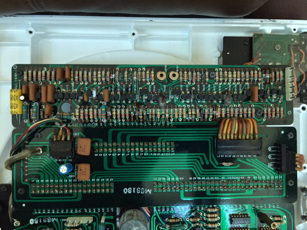

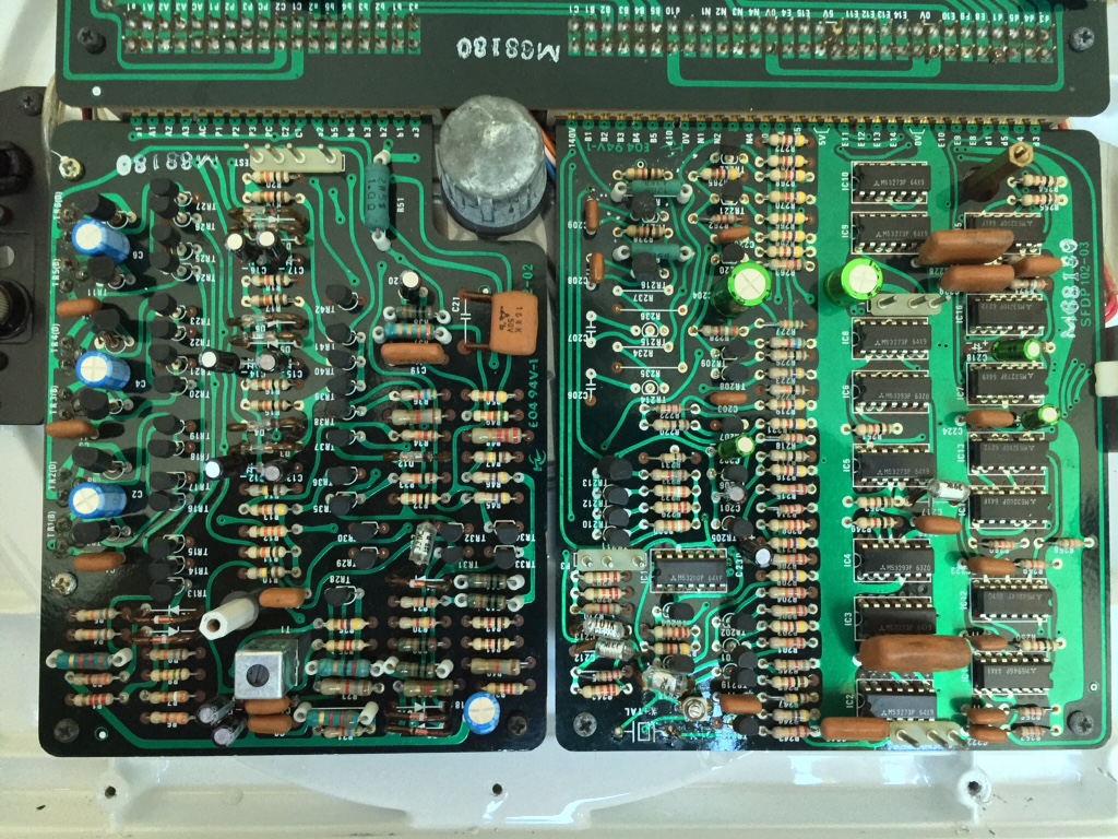

Getting closer to the day I start to upgrade this TT. So I pulled the covers off to see what shape everything is in. Someone has been in here before.

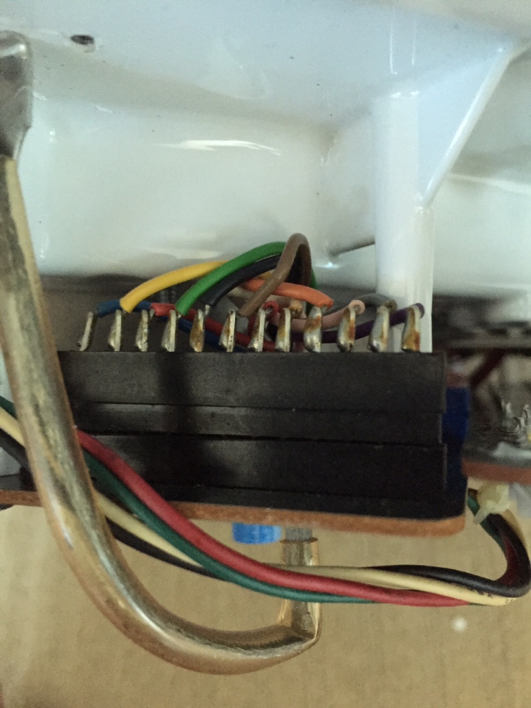

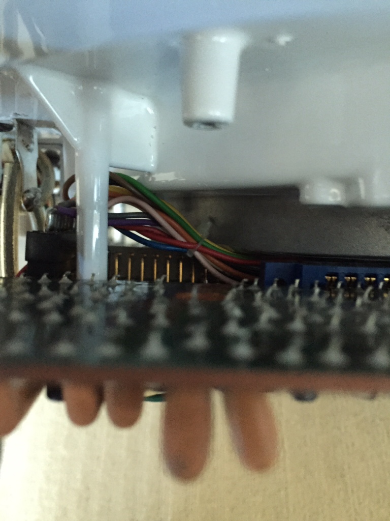

Concern has been mentioned about the umbilical cord when out boarding the electronics. There are 12 wires, as seen in the pic. They are all run together with no shielding between. Is the concern about the umbilical interference with other pieces of audio gear?

Dave, thanks for the reply. What guage wire should I order and is the strand count important? My plan is to shield the various voltage pairs from each other, and then shield the entire umbilical before covering with the braided sleeve. Good plan?

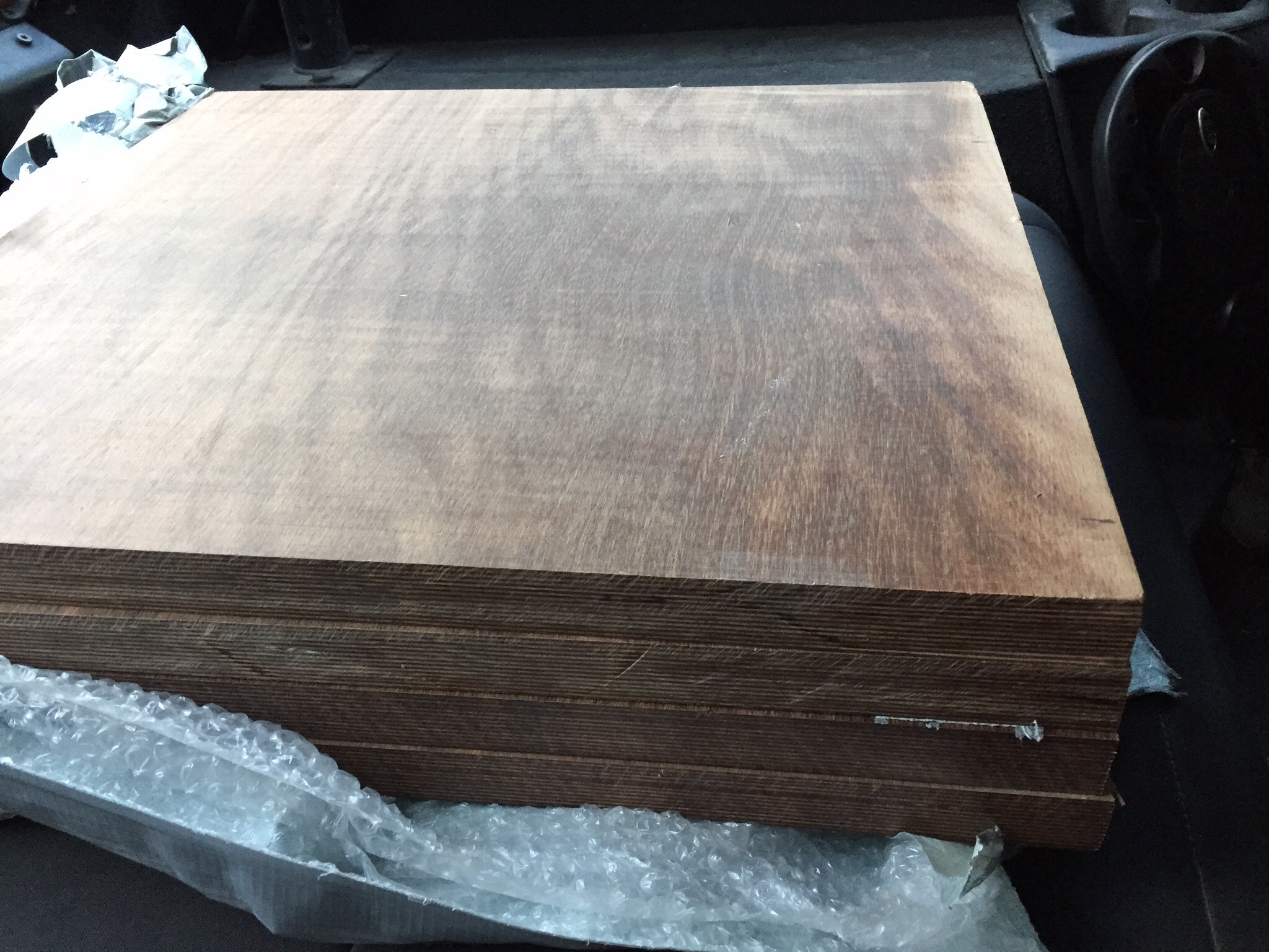

The panzerholz arrived yesterday
Just order a new chassis for the electronics from Landfall Systems. This is my fourth chassis from David. Great guy and product!
6L6 thanks for the reply. We will see how this stuff cuts. But no saw blades. All CNC. The only flat spots are the bottom and the two sides. Front, back and top will be curved. If everything goes as planned.Ooh! That's the 21-ply Panzer... Nice.

Umbilical - you could run 3 separate shielded lines and tecflex the whole thing together. I think that's what you are describing... ?
What kind of connector(s) should I buy for the chassis to umbilical?
A very good question !
The thinner and the more strands make a cable more flexible, and this is what you want.
I suggest you should bundle in a) all PSU, b) 50Khz feed c) position sensors d) tacho. BUT there may be other ways like using a 50 way screened IDC cable and quadrupling each motor drive and interleaving everything with a ground wire ? (apart from the 16 motor drive, they can be all one continuous block) 3M 3517/50OR from Mouser ? Or maybe Amphenol Spectra-Strip 159-2801-050, or 3M 3659-50 Ribbon Cable, Round/Flat, 50way ??
There might be other ways, any ideas chaps ? We really need a cable expert, and that isn't me..................
The three phase motor cables need to be 3-5A, although they only take under an amp when starting and less than 100mA running, you don't want any voltage drop here. The same for 31V and +5V. All the rest can be quite thin. All the 50KHz signal will get attenuated, I suggest you do a before and after measurement against the service manual.

Oops, of course there is no need for the PSU wires !!
So we can use a 36 way like :

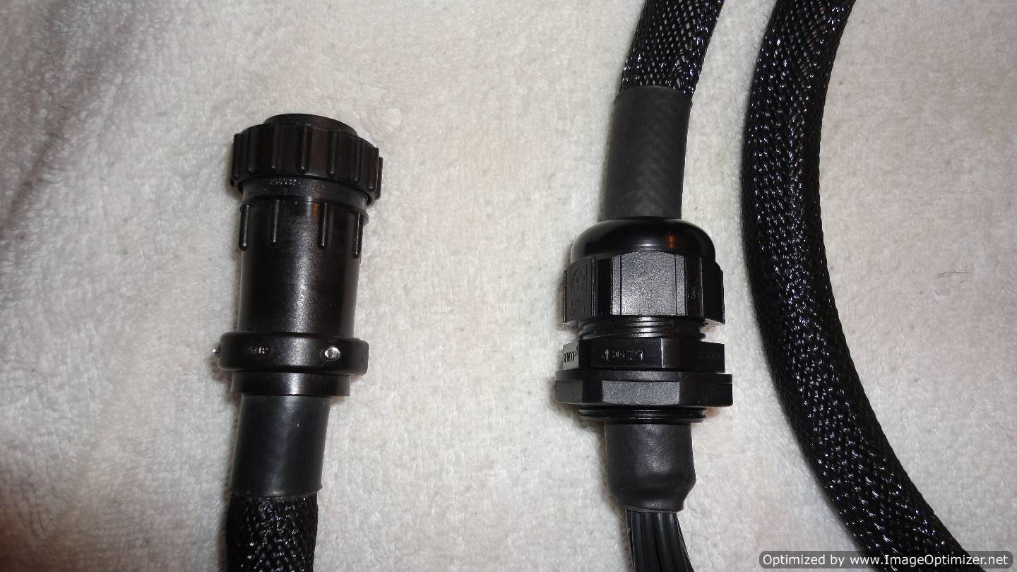

In my Denon DP-80 build that has a 1.5 meters umbilical i used 3 runs of shielded cable (each 4 way) and a separate ground.
The original cables were 24 AWG and used 22 AWG and a 20 AWG ground.
All bundled in tex-flex.
Terminated with TE/Connectivity plug and receptacle from Mouser.
Hard thermoplastic material and gold plated contacts...not cheap!
You need to buy the special tool for inserting/removing the pins.
I used the 16 contacts combo that can accommodate up to 20 AWG wire.
There are others with more contacts but the pins get thinner and will work only with thinner cable...24 AWG probably.
Worked like a dream.
